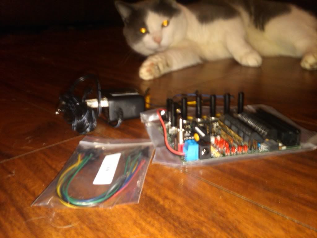

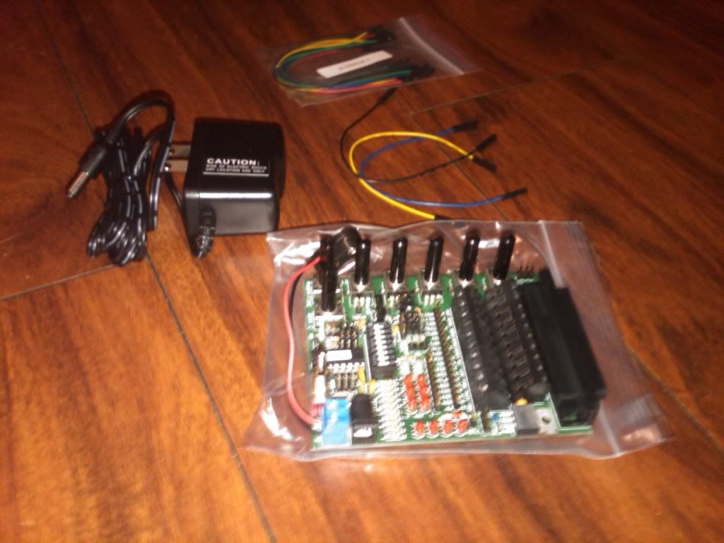

w00t! I got my stim today, and my MS showed up but I wasn't here to sign for it so I have to go pick it up at the post office in the morning.
our cat Bimmer was a little too interested, I had to lock the stim up after these pics because he kept trying to attack the jumpers. :roll:
I'll update the first post with all the new equipment when I get my MS tomorrow, and I'll start building the writeup for testing the MS3 with the stim.

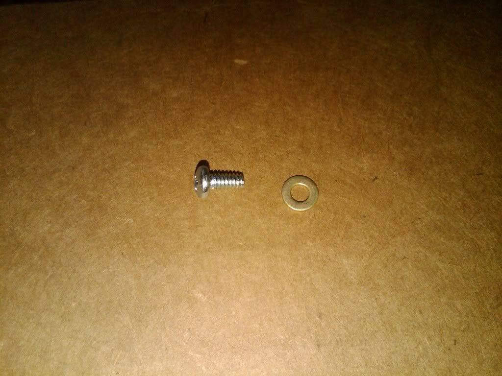

first thing I heard when I pulled the MS box out was rattling from inside the case. :x I pulled the case open and this fell out.
Looks like one of the screws that hold the board to the case, but I'm not sure where.
