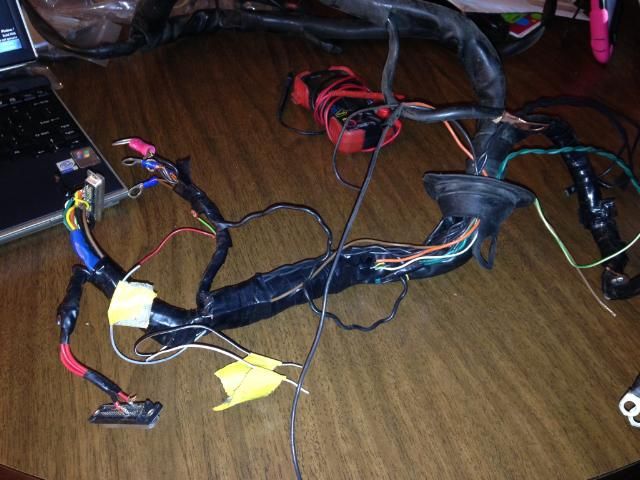

Postby M20_fever » Tue Nov 05, 2013 11:55 pm
well, one step forward, two steps back...
I got my MSQ to a point where I think I can start the car and get to tuning, that's the step forward.
This is the two steps back....

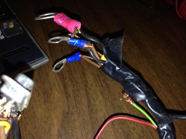

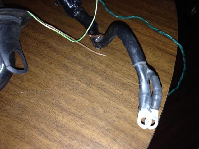

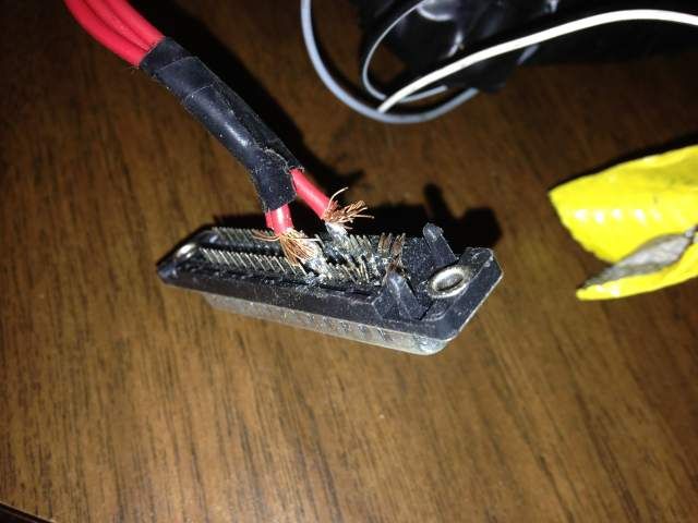

No way I'm using this hack job harness, its not even worth fixing. I'd have to redo the whole thing anyway, so I'm just going to get the DIY starter harness.
Question: The DIY website shows two starter harnesses, one for the main board and one for the expansion board. Do I need them both? I think only a few pins are used on the expansion board so can't I just make that harness from scratch, or would it be cleaner to run both harnesses together?
I'll be shaving a lot of the bay when I do the install so I want the harness to look as clean as possible.

Postby Yoshi » Wed Nov 06, 2013 12:20 am
I'd get both. The expansion harness is used for the spark outputs and such. All are prelabeled and predone. I hate crimping them and shit. Why go through all the hassle? Lately, I run full harnesses with just those two there and some relays. It makes things MUCH easier. IMO get both.
