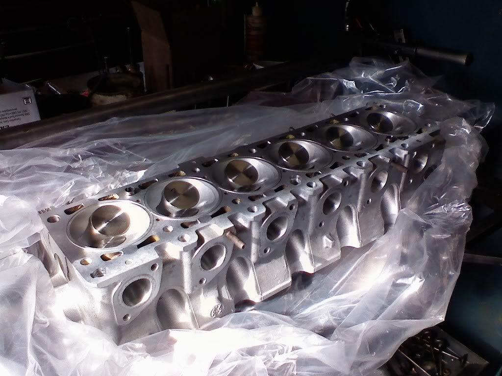

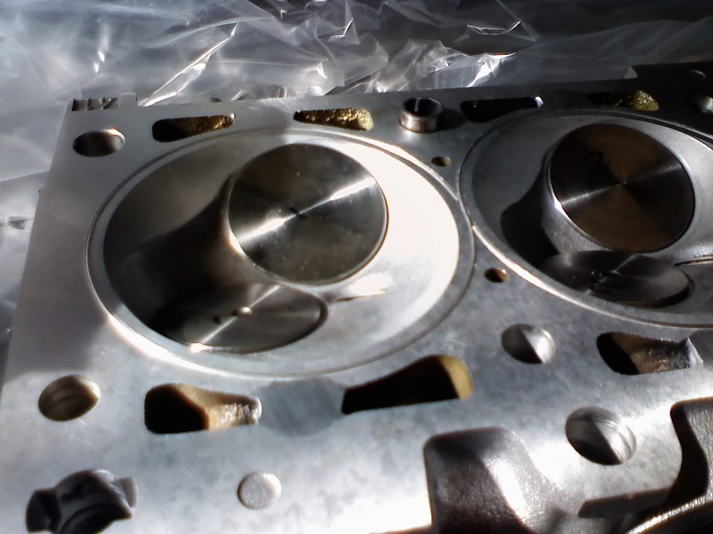

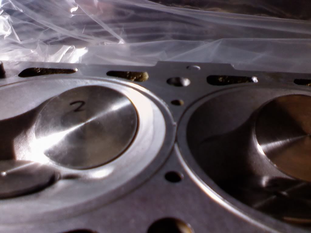

where would you get orings for the combustion chamber or who makes one
Re: max HP on stock internals?
Postby Yoshi » Sat Oct 06, 2012 7:55 pm
the machine shop should do them for you.
Postby M20_fever » Sun Oct 07, 2012 6:19 am
Mine is .041 stainless steel wire, after o-ringing it left .030 protrusion.
Postby blasphemy101 » Mon Oct 08, 2012 1:39 pm
About how much does the oringing and the welded channels/leveling the head run? I would like to similarly prep a head in the future
