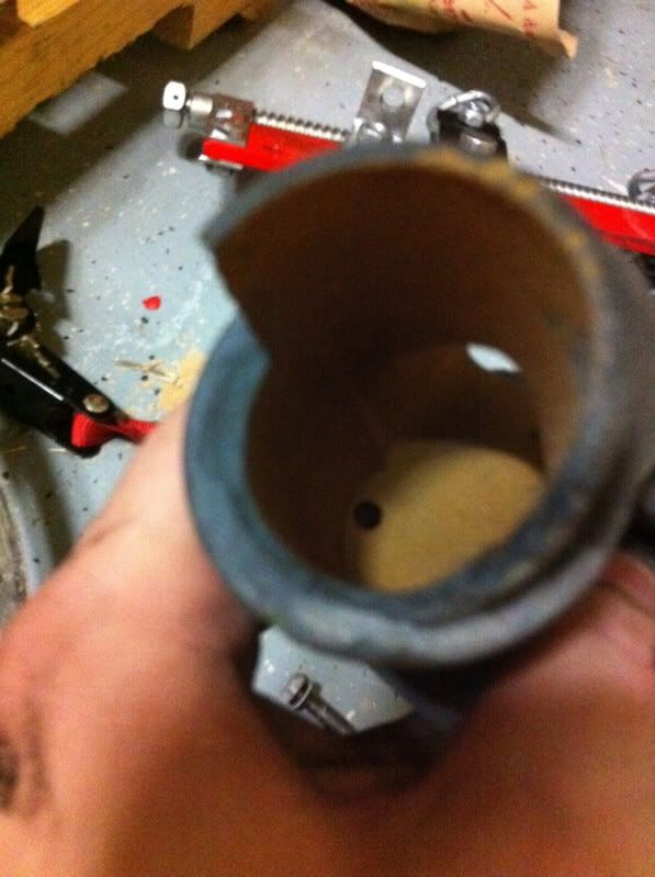

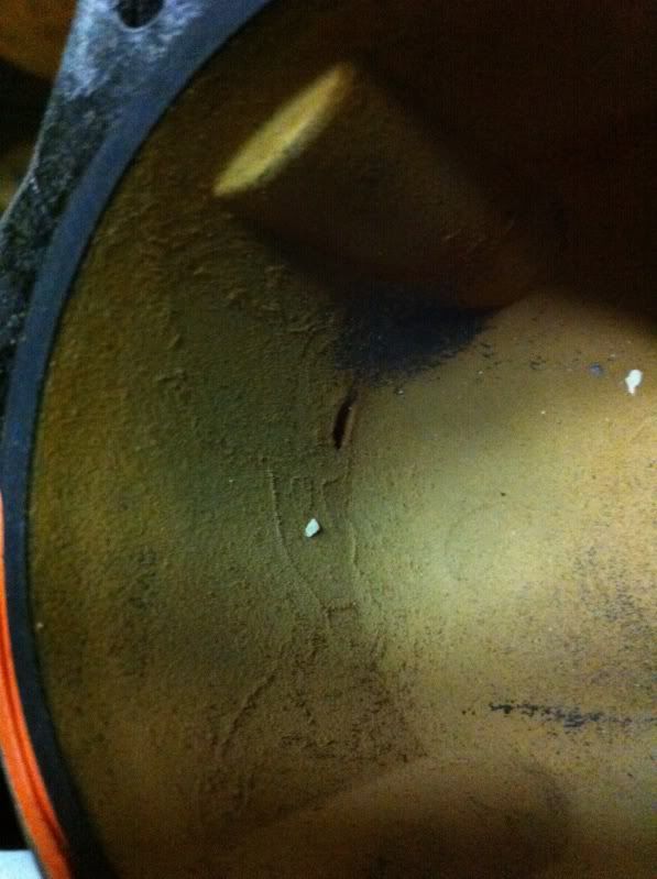

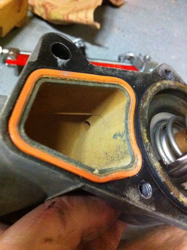

Postby glucklich21 » Tue Mar 29, 2011 5:44 pm
I noticed this last night taking apart the S50.
That hole goes all the way through. I'll have to see if my metal replacement has the same thing.
