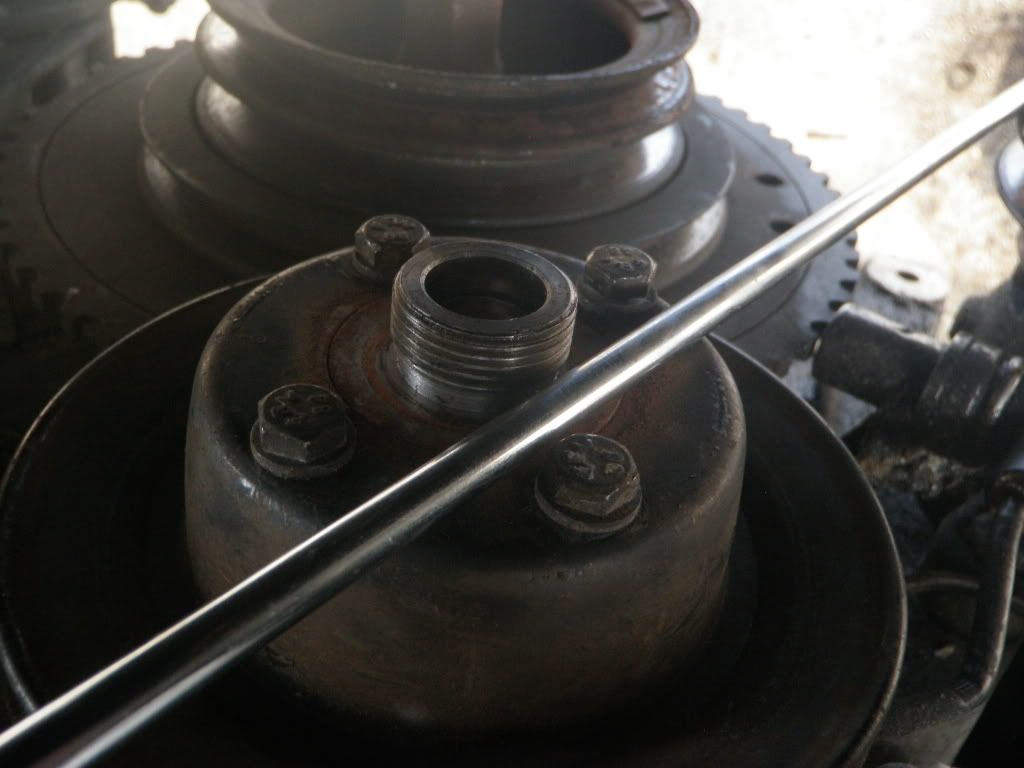

Step 3: Fan/Pulley Removal
1) Place a 32mm (1 1/4") wrench on the large nut behind the fan.
a. This nut is reverse-threaded, so it will have to be turned clockwise.
2) Whack the the wrench briskly with a hammer, in an attempt to break the nut loose.
3) If the nut comes loose with the initial hit, undo it the rest of the way by spinning the fan clockwise.
a. If the nut does not break loose, hold the fan pulley in place by threading your long screwdrive or other similar tool in between the small bolt heads on the fan pulley to hold it in place. Hit the wrench again, and the fan should come loose. Remove the fan by spinning it counter clockwise until it comes free. The picture was taken after the fan was removed to better show the way the screwdriver was positioned.
4) Remove the fan pulley by undoing the four 10mm bolts (you may have used them to brace your screwdriver). If you have trouble with the pulley spinning, you can use the method outlined in step 3 to removed the bolts that are still stuck. Leave the bolt across from the troublesome bolt slightly threaded in, so you can use it as a brace point for your screwdriver.

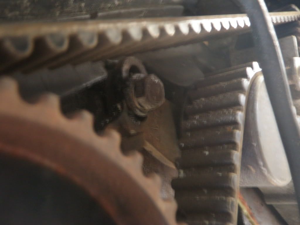

Step 6: Timing Belt Removal (YAY!)
**See step 7 if you are replacing the water pump!!!***
1) set the engine to top dead center (TDC) by rotating the crankshaft pulley (23mm) until the mark on the pulley lines up with the divot on the timing belt channel.
2) Verify that the mark on the camshaft gear also aligns with the corresponding mark on the cylinder head. If does not, keep rotating the crank pulley until the marks on both the crankshaft pull and camshaft gear line up with their corresponding marks.
3) Use a deep-well 17mm socket to remove the stud that held the alternator bracket to the timing cover.
4) Use a 13mm deep-well socket to loosen the bolt on the tensioner.
5) Rotate the tensioner counter-clockwise (towards the passenger side) with a long screwdriver and slide off the timing belt.
6) Finish unscrewing the stud and bolt and remove the tensioner, spring, and pin.

Step 8: New Timing Belt Installation
1) If your kit did not come with a new set of hardware, start by removing as much crud as you can from the 17mm stud, 13mm tensioner adjustment bolt, pin, and spring.
2) Lightly bolt the new tensioner to the block with the stud. Do not tighten it enough to prvent the tensioner from rotating.
3) Slide the pin into the spring and seat the head into the notch on the water pump housing and slip the pointed tip into the "eye" on the tensioner.
4) Rotate the tensioner against the spring tension (counter-clockwise) as far as it will go. Tighten down the adjustment bolt.
5) Ensure the timing marks on the crankshaft pulley and camshaft gear are still aligned with their corresponding marks on the block/head
6) Slide the new timing belt on
a. go over the tensioner pulley last, as tension will need to be applied
7) Loosen the adjustment bolt to apply spring tension to the pulley
8) Rotate the crankshaft counter-clockwise twice (720 degrees) until the timing marks on the crankshaft and cam gear are aligned once more.
a. This is improtant to help the new belt stretch out before it is subjected to the strains of a startup
b. If either timing mark is not aligned, remove the timing belt and rotate the cam gear to account for the 1-2 tooth discrepancy. Repeat the above actions for step 8.
9) Once the timing marks are aligned, tighten the 13mm adjustment bolt and the 17mm stud to 16 ft-lbs.
