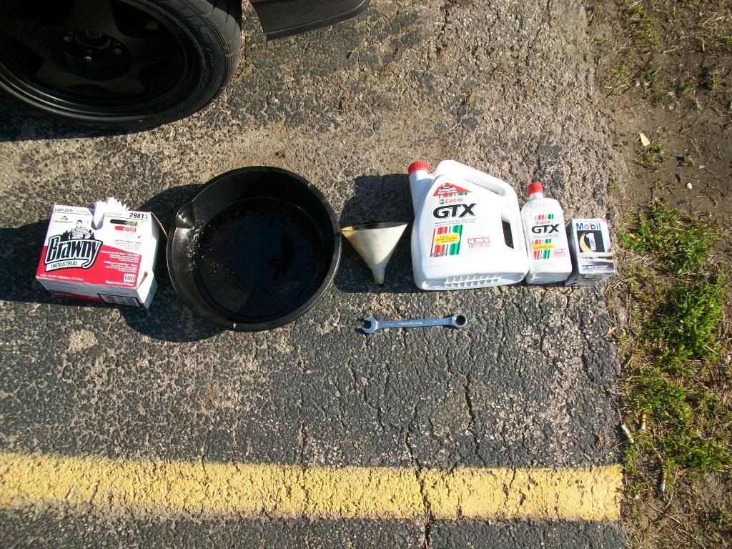

To start, Here Is everything that you'll need.
-17 mm Wrench
-Oil
-Oil filter
-Oil pan
-Funnel

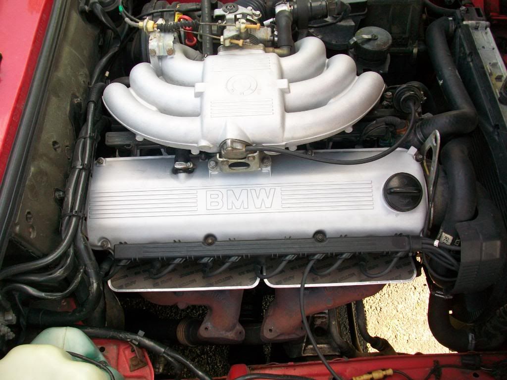

Ok, Heres the top of the motor
You'll notice the Oil Fill cap towards the front of the motor, the little black round cap

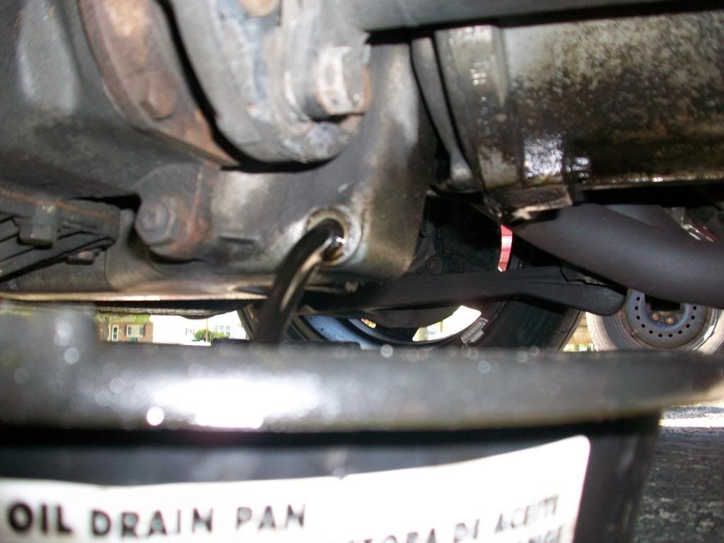

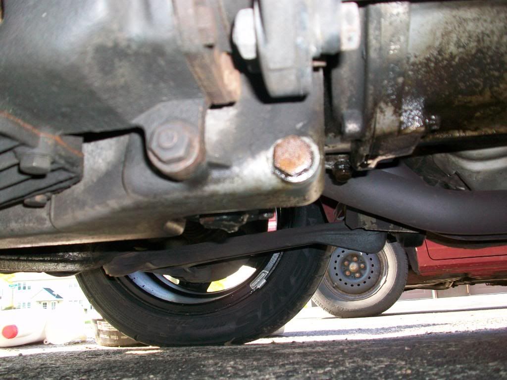

Now at the bottom of the motor, you'll find the oil drain plug. On a standard e30, the plug is on the front left side of hte motor if you where looking at it toward the car. My car is different since its an IX and the plug is on the back right of the motor. On a 318 (m42), the plug is right on the front of the oil pan.
Here's Mine
Unscrew the plug and away it goes!
Once the oil is done draining, replace the plug and tighten it up

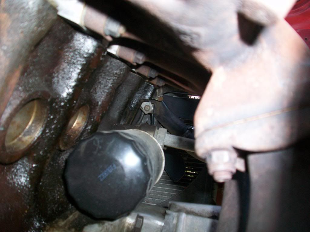

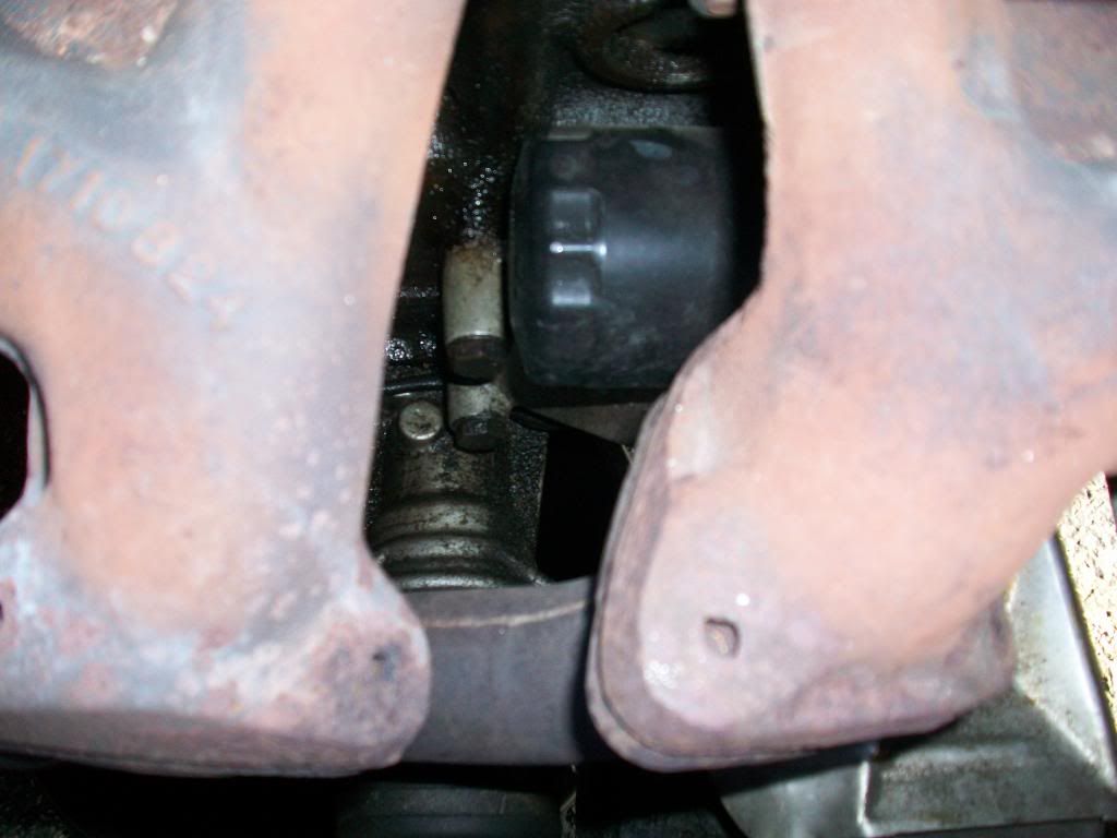

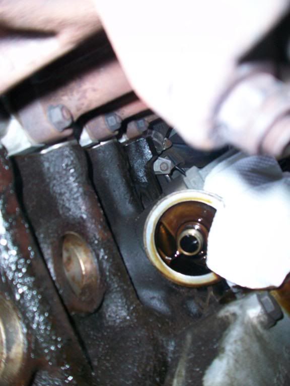

Next, is the oil filter. On an m20, the oil filter is in a location of which I feel is really stupid. As I said before, I like to the oil when still warm, but I let the car cool for a while because of this....
On an m42 (318), the filter is a cansiter style. Its a aluminum tube that is located on the drivers side of the car. Its got a 13mm hex bolt and the top will come off to remove the filter.
Once the motor cools, unscrew the filter BUT make sure the oil pan is underneath the filter area. Oil WILL come out when you remove it.
With the filter off, take the new filter and lightly coat the threads and the seal with oil.
Screw on the new filter, but don't overtighten it. I usually turn it till it requires you really grab it, then I turn it 3/4 - 1 or so more turns after that.

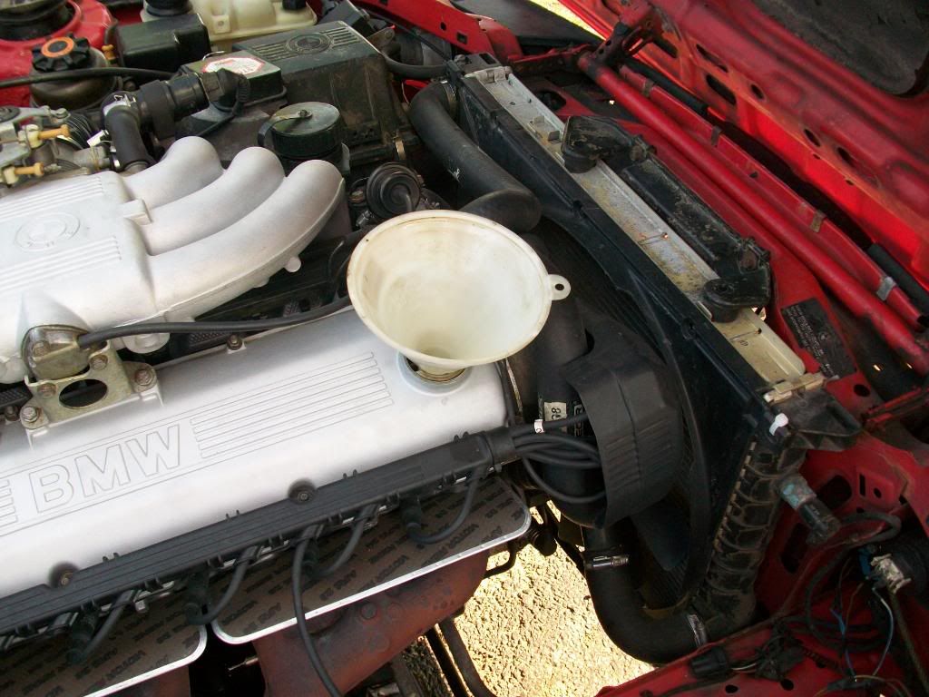

Open the oil fill cap. You will need 4.6 quarts of oil of an m20 and 5 quarts of oil for the m42. Well, fill her up! Check the dip stick to verify the level.
Replace the cap, start it up and let it run for a sec and then turn it off. Recheck the oil level and if needed, add more.
Yes i burnt my knuckle really bad a few years back doing an oil change. The smell of human flesh on headers still haunts me.

I have tried to do it in the past right away....but I just give up now and wait about 45 min for it to cool. I just got sick of going to work with tons of little red burn spots on my hands and forearms.... :)

Ix oil pans are weiiird.
Re: How To: Oil Change
Postby ten2doyle102 » Mon May 18, 2009 2:24 pm
yessir...they are! ;)
first time I did a oil change on this, i was like WTF!!! where the damn plug! :) then I was oh, dare it is! :)
