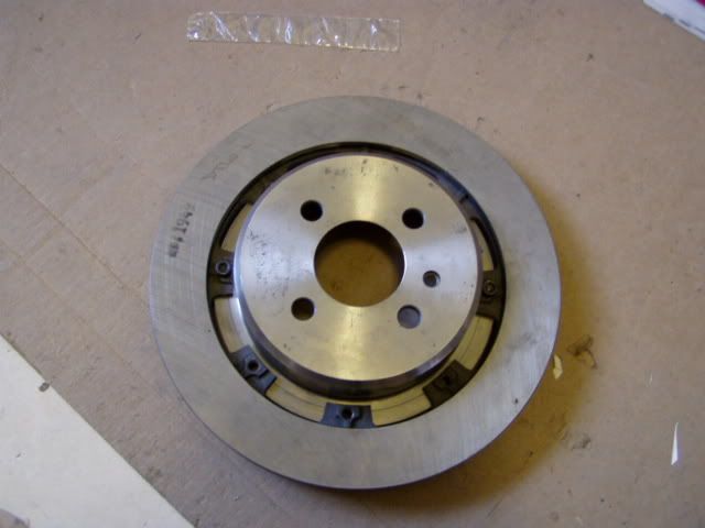

Stumbled upon this on the tech. Stock rotor/hat modded to fit $30 Wilwood vented rotor, a correct piston sized caliper and custom bracket= rear BB
Rotor: http://www.summitracing.com/parts/WIL-160-0471/
Thoughts?

Neat! Are there any specifics on the modifications?

it looks like it fits perfectly, so you don have to worry about centering it. Just drill holes and bolt the larger rotor onto the stock one. Just need to find the right caliper, and make a braket. Also you have to make a spacer to accomidate the fact the rotor is closer to the wheel face now.

So what are we doing here??? Modifying the rotor to bolt that on? I am slightly confused... lol!

Well from the summit link its a vented rotor. Probably a little bigger too but I dont know the stock measurements to compare.

Using the stock rotor "hat" and modify to mount a bigger vented rotor. The hat is the expensive part of the rear BBK, thats a lot of aluminum to machine.

true, though you only need to do it once. But between the machining on the rotor, and the machining for the brackets, and the cost of whatever caliper you find that will work you could probably get one of Lee's kits and have the R&D and customer support backing it up.

If you enjoy tinkering and screwing around it could be an option though. I dont know how much a machine shop would charge to turn down the stock rotor just so it is big enough for a bolt flange for the new rotor.
Or just slap some hawk pads on the stock rear setup and forget it. I am going to buy Lee's front kit at some point when I have a spare grand to get rid of. I dont right now unfortunately :(
