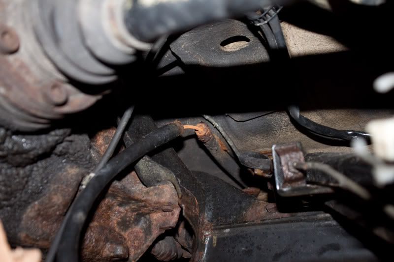

Yo guys. I'm working on changing my parking brake cables right now and I hit a bit of a snag.
Right where the housing meets it's mount by the trailing arm, it is broken off.
Then it's also broken off right where it enters the hub assembly/brake housing/whatever.
How is the cable housing supposed to connect in these two places? I'm sure it's gonna be a biatch trying to get the remaining pieces of casing out of where they are, but I'm not even sure what a baseline looks like.

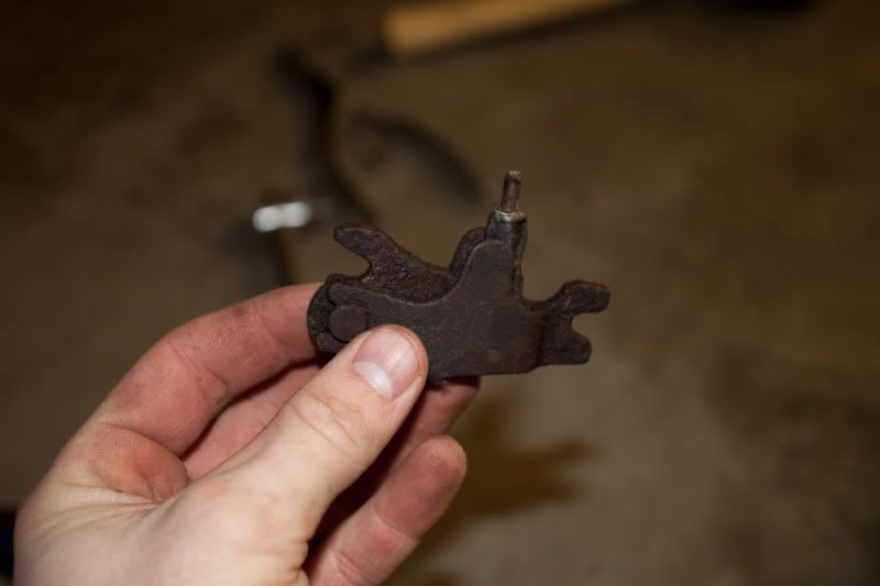

Also, these little bastards (both sides) are seized right up. Is it worth trying to get them free or should I get new ones?

It is going to be a tough job.
Take the car to a mechanic to remove the cable sleeve at the wheel end.
Then bring the car home for the easier stuff.
I did the same job on an E36 but I had the rear suspension apart for replacement of bushings.
Access was tough then, but it will be harder in your case.
The body end should be easier if you can get a drill in there. drill thru the cable to make a hole. then switch to a larger bit and drill again. keep going bigger and eventually the big bit will spin the cable sleeve and you can pull it out.
The inside bit of cable , you'll remove from inside the car.
Your brake hard line looks iffy.

I would replace the whole parking brake system from the pedal back, but thats just me. Do it once do it right, ya know?
http://realoem.com/bmw/showparts.do?mod ... g=34&fg=30
Its going to be a PITA to do on jack stands, so if you can afford to take it in I would do so just to avoid the hassle, but it can be done in the driveway with hand tools. Have a vehicle to use if this is your DD, it may take a weekend to get it done right if you have all the new parts there and ready to go in.

I've never had to take the cable out from the chassis. So I can't give you much on that. You need to pull that rusted bit out of the hub. Heat and hammer it I suppose. The actuator is probably salvageable. You'll have to do a lot of sanding and lubing though. It probably would be a good idea to get new but even without shoes, you're looking at $300 worth of parts. That damn actuator is like $60 a side!
If you do reuse the actuator, be sure not to lose the 2 dowels per side that hold it all together. Small ass buggers.

I got the actuators freed up. I'll post pictures on that later.
