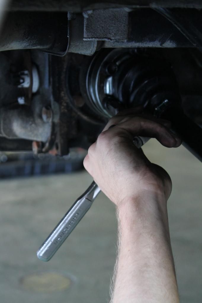

Once all of them are loosened you can have your helper undo the e-brake and take it out of gear and proceed to remove the bolts. Make sure to keep the three collars that come off with them as you don't get another set as you do bolts with the CV boot kit.

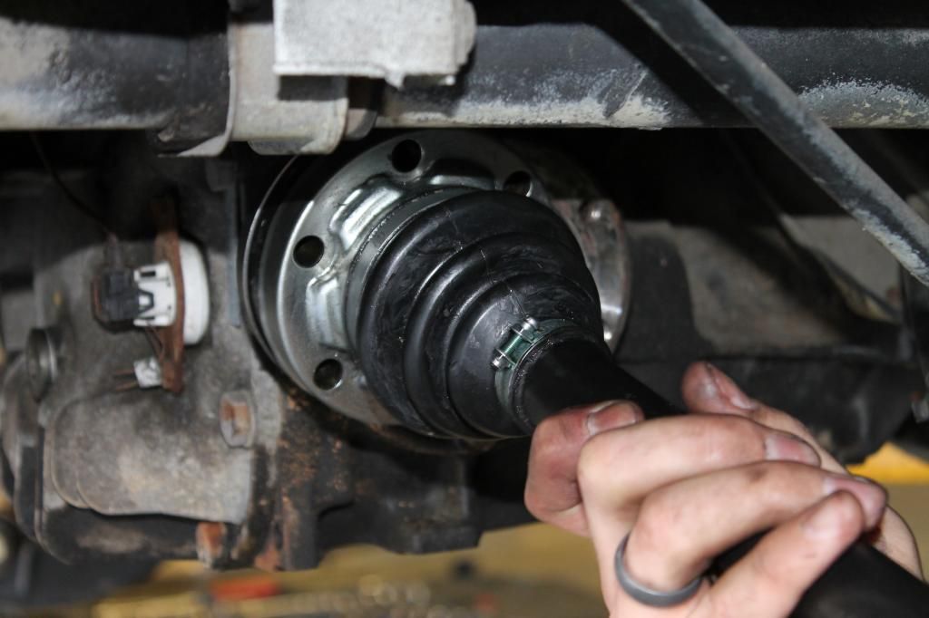

Once they're all removed the axle may be able to drop, but worry not! That's okay.

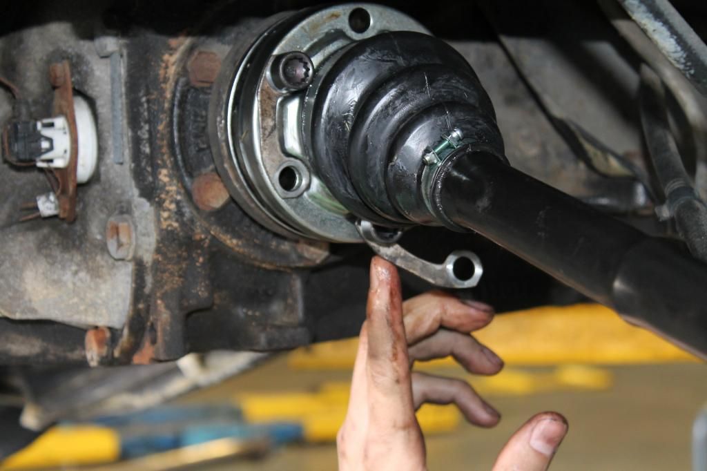

Next up, remove the wheels and you should be looking at the end of your CV axle shaft with the axle nut threaded on it and a washer behind it. As we don't have to mess with anything on the passenger side we'll begin there. Use an impact and the 30mm socket to remove the axle lug nut, and you may need a flat-tip screwdriver to get the washer out:

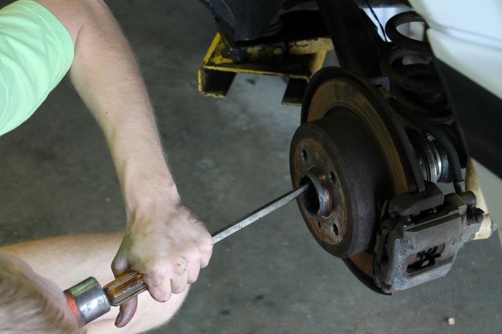

To get the axle out I reversed the large flat tip screwdriver so the nice plastic handle was on the axle shaft and the tip was facing me (opposite this picture as I was getting the washer out but it helps with the idea):
(Me putting it back in but with the screwdriver in the right direction)
Hit it and it should come out just fine (if you need more dire measures or what tools to use if it's stuck see Yoshi's post as it is completely possible to take a lot of oomph to get your axle out). To pull the axle out it's best to pull it directly away from the wheel hub like such:

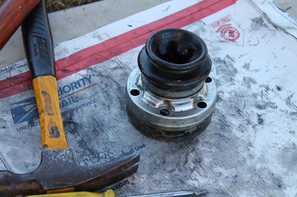

The end cap is a dust cover for the joint itself and has to be removed. You'll need a medium size flat tip screwdriver with a skinny tip and your hammer for this part. As seen below, you'll want to position the screw driver as to be as close to parallel with the outer joint so you don't scratch the outer joint housing's metal. Place the dust cap end against something soft and sturdy, wadded shirt against the wall, or your foot if you want to do it on the ground. The screw driver will be gently hammered in between the dust cap and the joint itself, taking scare to not smash into it as you've just got get the tip in there a good bit:
That's about as far as is needed to get down in there but you can certainly get it further in if need be. Continue this process around the dust cover in small increments until you start to see it move. The aim of doing this is the get the entire lip opened ever so slightly as it doesn't take much to get it to come off. When you've gone all the way around and it hasn't come off you may continue going around this time aiming the spots in-between where you were hitting before. When it comes off it should come off like this:
Take note that the outside portion of the joint that the dust cover goes over is the double groove portion towards the differential, or the letters on the same face sitting on the diff as well. Next up you'll want to take a look at the face of the joint. It's worth it to note the center part of the mechanism (I'll call it the gear) is smooth as when taking it off later you'll notice the other side of the gear to have a raised lip. You'll also want to note that the gear is offset from the outer portion of the joint that we've been dealing with, small tooth on the gear points towards the large part of the outer part of the joint housing. And the joint has medium-large and medium-small portions of the outer joint housing (this is the side with two grooves), also important for later:

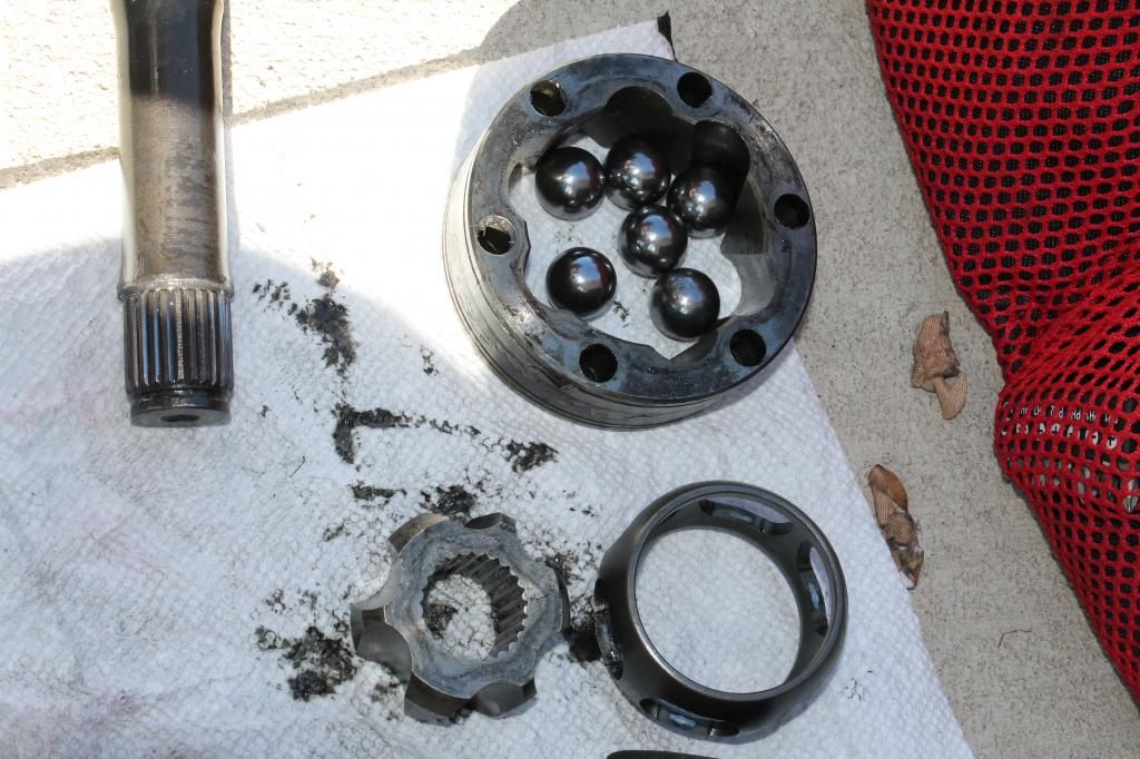

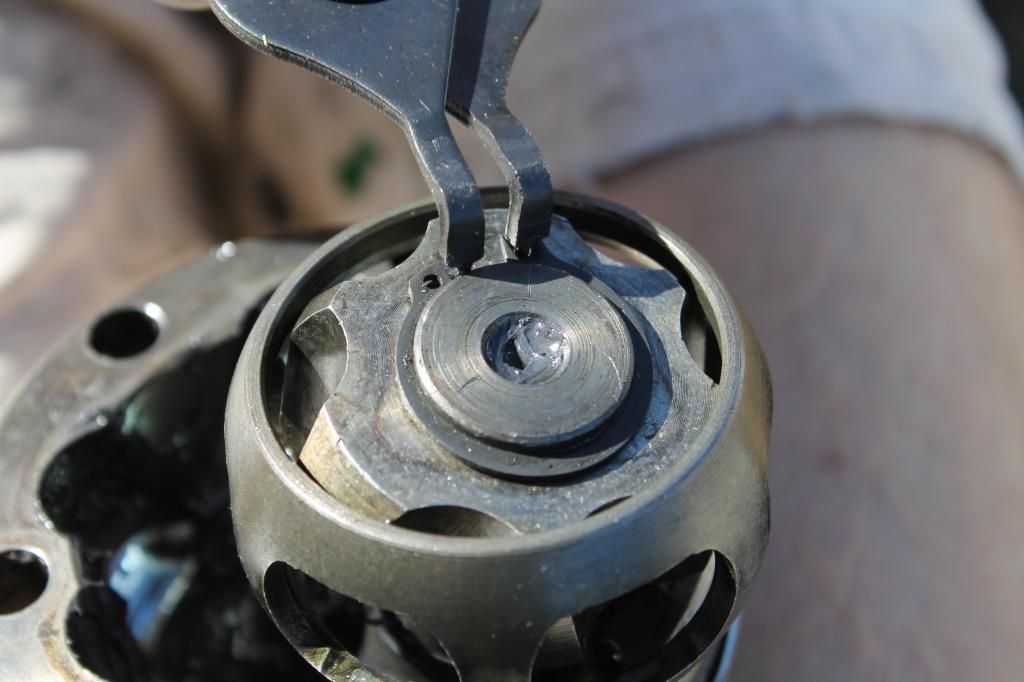

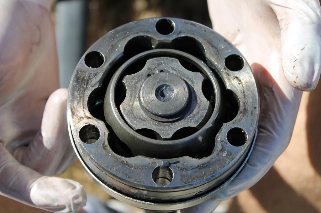

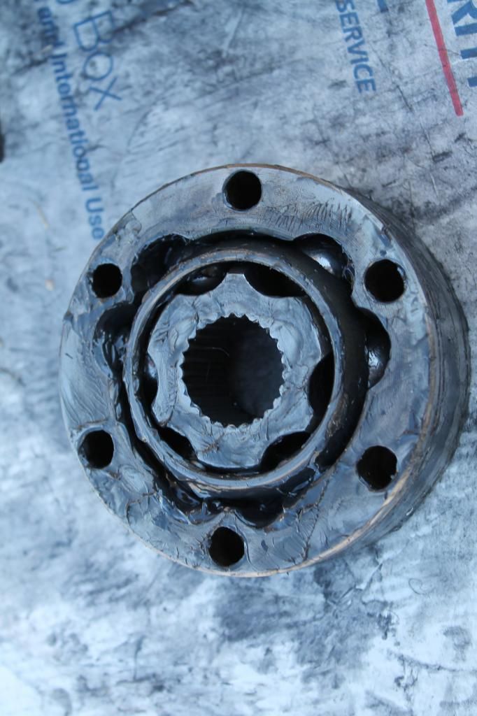

You'll be able to see the joint itself now that the dust cover is off; above is what it should look like cleaned. To remove the center gear and spider cage you simply need to wiggle the entire joint while pulling down on the outer housing; getting the balls out of the mechanism is a little weird and will take a little maneuvering. Getting the joint pressed down on the outer housing to one angle or another will help, you'll notice whichever way they come out easier. This part is a little funky but:
As that comes out you'll have to place the 6 balls aside to be cleaned later. Next step is to remove the snap ring with the snap ring pliers, don't worry if it goes flying as you have new ones in the kits above, but I'd keep track of them just to be safe. Set the gear and spider cage aside to be cleaned later as well:
Now you should have a nice empty joint to look at:
You can do your best to remove the boot and clamp carefully or you can cut them off as I did. You should have a nice set of parts to clean up from the inner joint, like such:

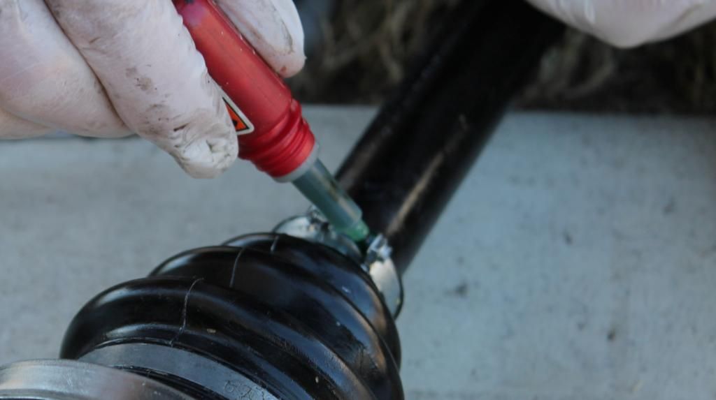

Next you'll want to pack grease down in the boot and in the joint, with the only rough part being getting the boot over the dust cover's lip. You'll want to grasp it with all four fingers on the boot itself and your palm/thumb holding the joint. Press down on the boot with all four fingers and use your other hand to press the boot down, walking around while never moving that main hand, it should pop on with a less-than-triumphant sound. Now all that's left is the CV boot clamp, at least for the outer boot. I would highly suggest against using screw-tightened water hose clamps here. Spend the couple of bucks on a:
8 bucks online (http://www.summitracing.com/parts/wmr-w83013/media/images) or at a local parts store. With the tool all you you have to do is get the clamp around it, situate and then place it over and use it as such:

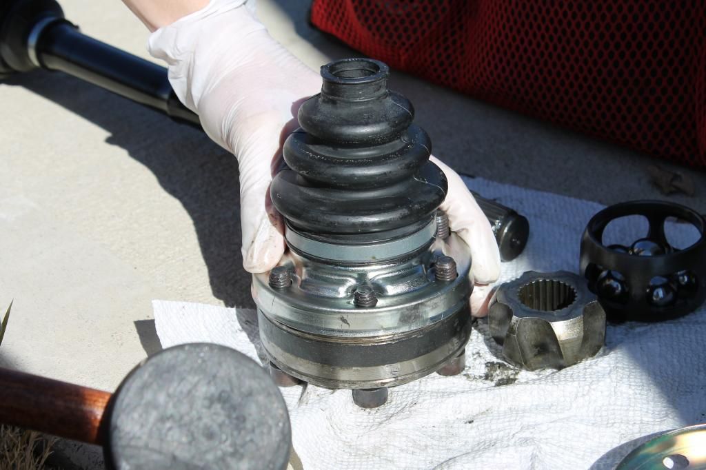

First up we want to put the actual joint together, trust me as you don't want to do it with the boot on and it on the axle itself. You'll want to hold the outer joint housing with one hand and do everything else with the other, get this mixed up and the joint will end up backwards and won't move once you get it on the axle and the other dust cover on. You'll want to have a good place to work, put the gear back in the spider cage and grab hold onto the outer joint like your hand is the boot, with the double grooved side facing you and the single sided groove face in your palm. Place the gear and spider cage in the middle of the housing with the flat face of the gear facing you as well as the grooves offset (big in line with little and little in line with big). Now you'll want to maneuver the gear and spider cage to extreme angles and get one ball in at a time. This will take a bit of time to get it to work but at least it isn't on the axle or covered in grease at this point. Once the last piece has gone into place you should have a complete joint looking at you like such:
Now we have to place the boot, with dust cover already attached, onto the joint that we just put together. I turned the tip of the boot inside out for better control of it while working with it. Make sure to line up the dust cover with the holes as well as you can before applying any pressure, as well as making sure the boot and cover are going on the outer joint housing with the single groove side, double grove facing away, like such:
Give it a good press down with both hands. You'll need your rubber mallet, six bolts that came with the kit and a flat surface. Place the bolts through backwards and make sure the dust cover is properly aligned before smashing it into place, you don't want to run the risk of ruining the dust cover. You'll set the joint with the bolts on the ground/flat surface and hammer in circles around the dust cover on the spaces in-between the bolts:
It'll have one side normally go down first then you'll be stuck going back and forth in half circles on the raised side. When the dust cover gets close to being on all the way, trust it to go straight. Pull the bolts and rubber hammer around the edges of the dust cover until it is completely flush:

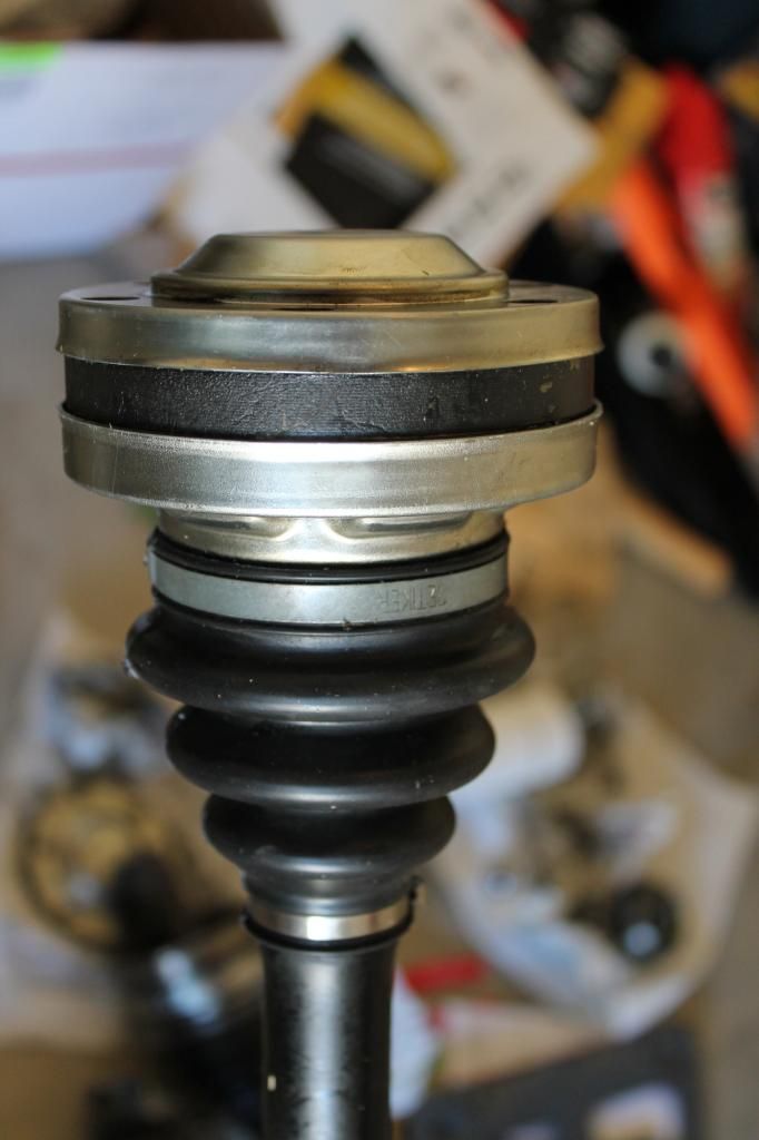

Now you can add the snap ring to the end of the shaft to keep the gear and joint in place as well as putting the small boot clamp on, make sure it sets well in between the grooves and to add some loctite. Add what little grease you have left to the open end, packing in as much as you can:

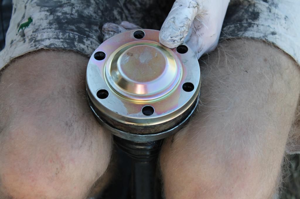

Last step for the axle itself is to put the other dust cover on. I suggest the good ol' thigh hug. I lined up the dust cover as best I could and pressed evenly and gently. Then I placed the six bolts in to line her up proper, grabbed it as good as I could with my hand between my thigh and where I was hitting and started hitting circles:
If you can think of a better idea where you don't mar the dust covers, that's great -- just be careful to not set it on a vice and hammer circles as you run the risk of demolishing the lip where the boot came pre attached to the dust cover. When it's pretty well on there you can remove the bolts and rubber hammer like a madman until the dust cover is on flush, you may end up looking something like me with my method but it worked like a charm and nothing was messed up:
TADA! You have now rebuilt your CV axles and you can simply put them back in!
