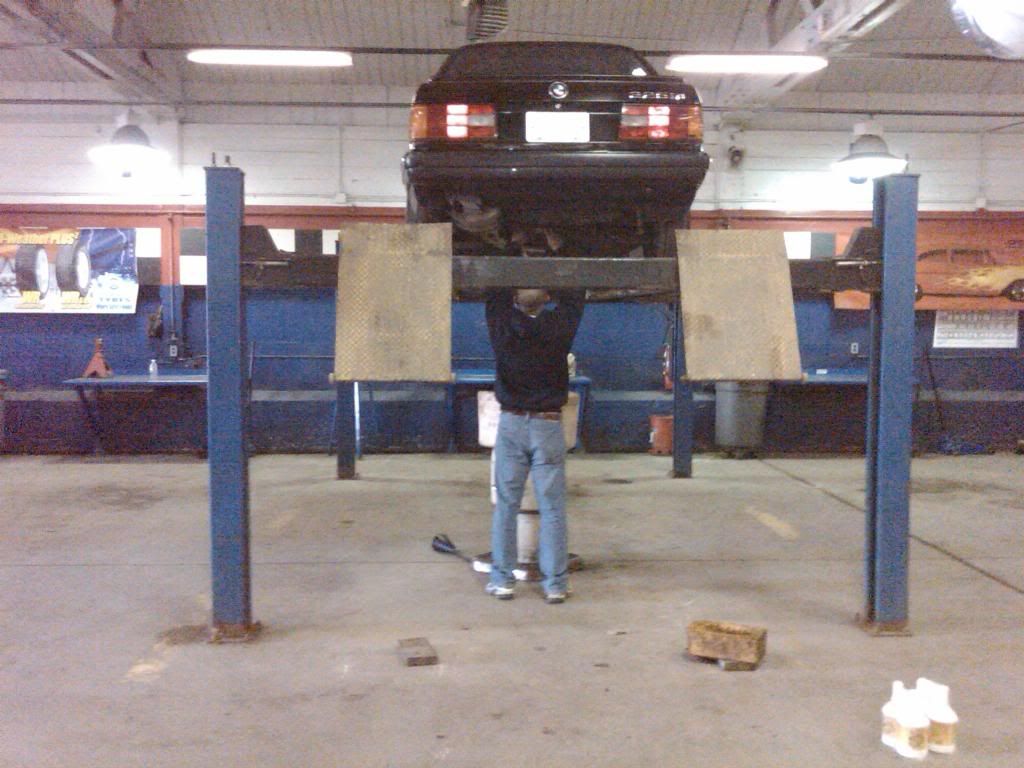

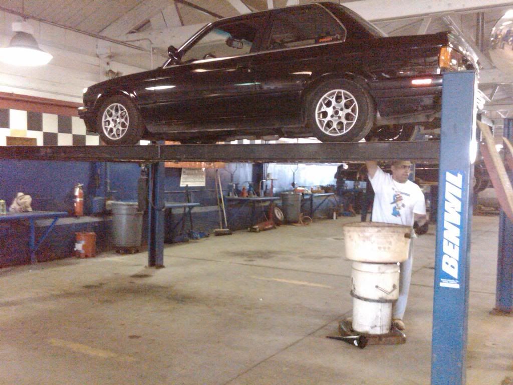

I was very lucky to have access to a full shop to do this work, but with the right equipment it can easily be done on jackstands in your garage or driveway.

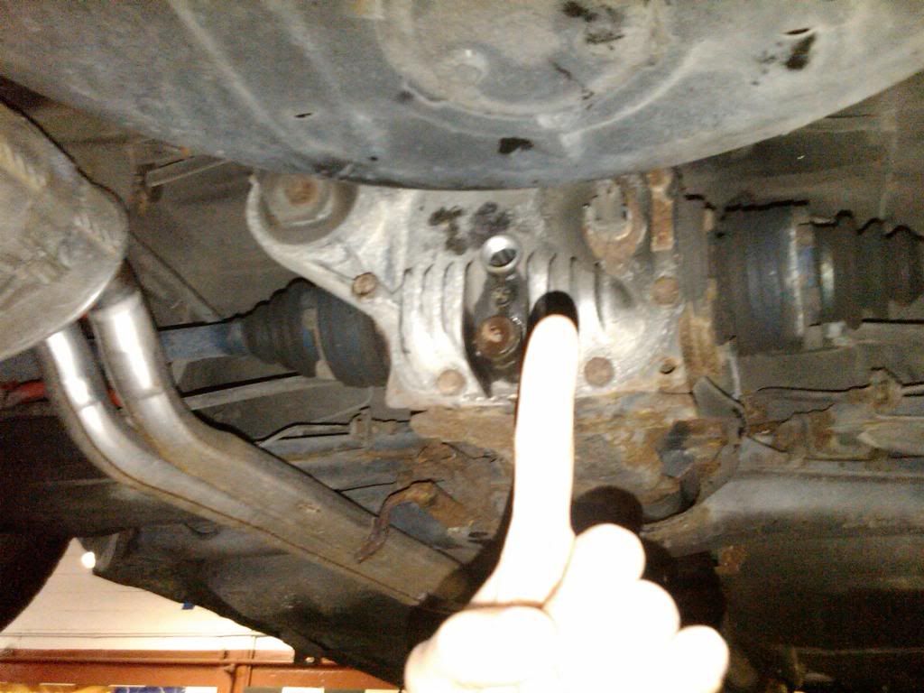

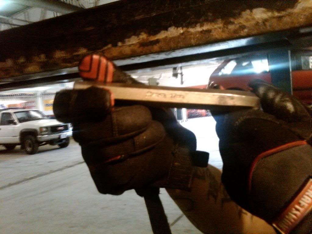

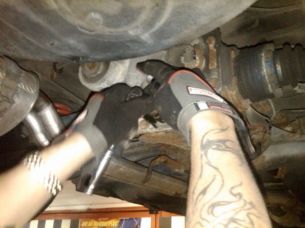

We tackled the differential before the transmission. First remove the upper plug on the back of the differential, then remove the bottom plug. Be sure you have a drain pan under the differential before you remove the bottom plug.

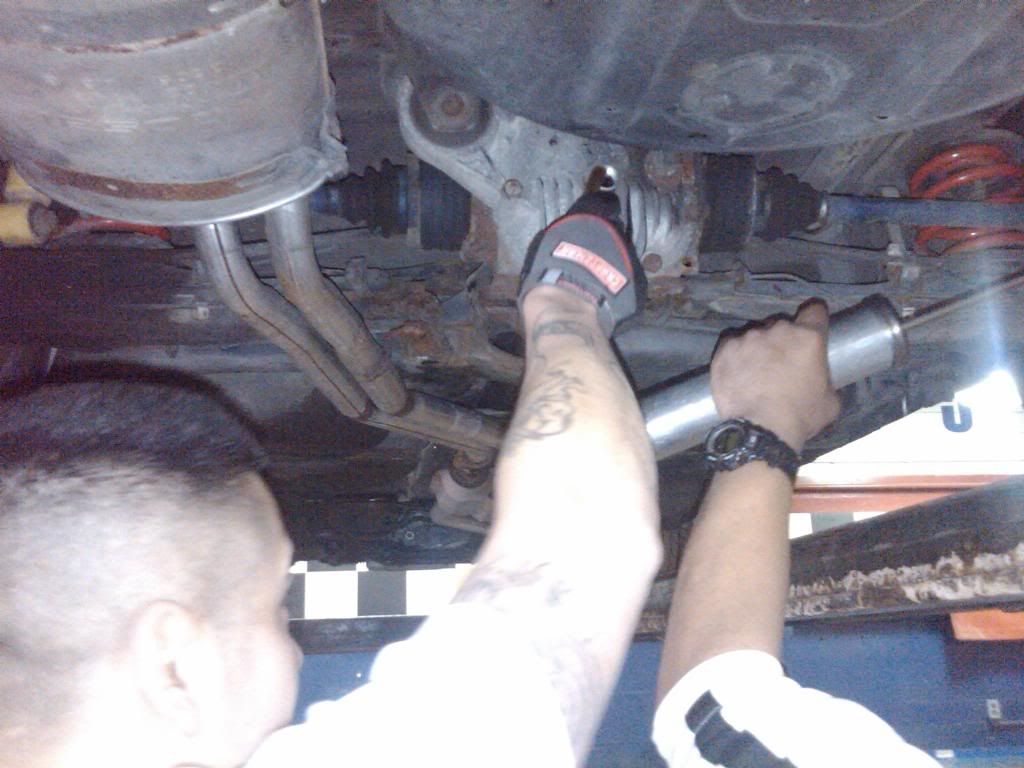

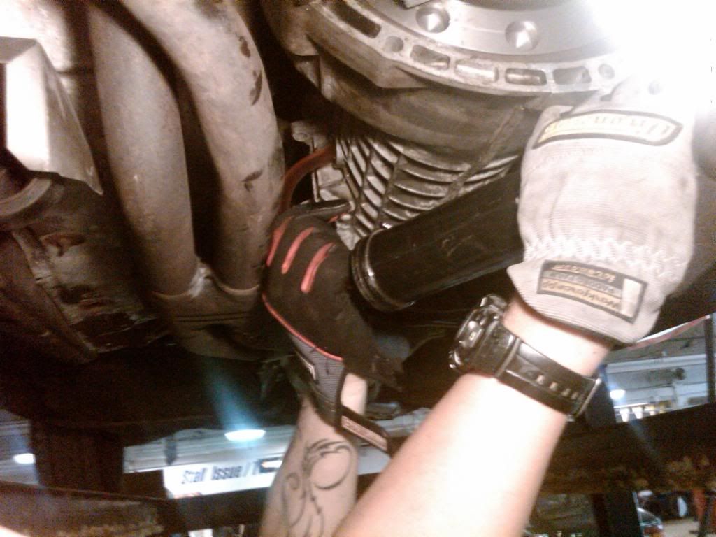

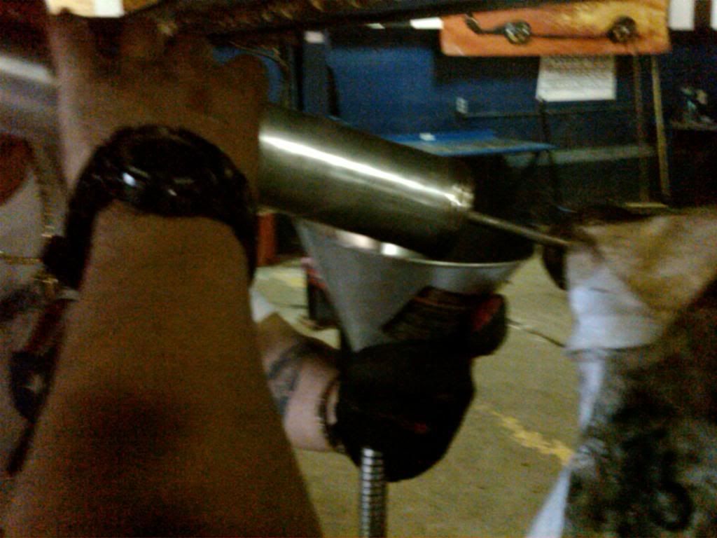

once the differential is done draining replace the bottom plug. To refill the diff you will need either a long tube to attach to a funnel, or a fluid pump of some sort. We used an older hand held fluid pump.
The differential takes ~2 bottles of the Redline gear oil, be sure to use the right type as there are different kinds for open and limited slip differentials. We used the Redline LSD oil.

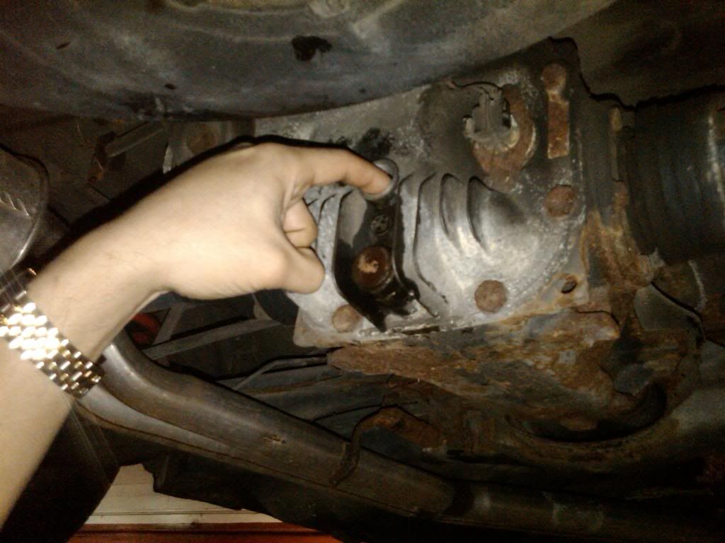

To check the fluid level stick your finger in the top plug hole, the fluid should be just below it.
Replace the top plug and your done, wipe the case off so you can see any leaks if there are any.

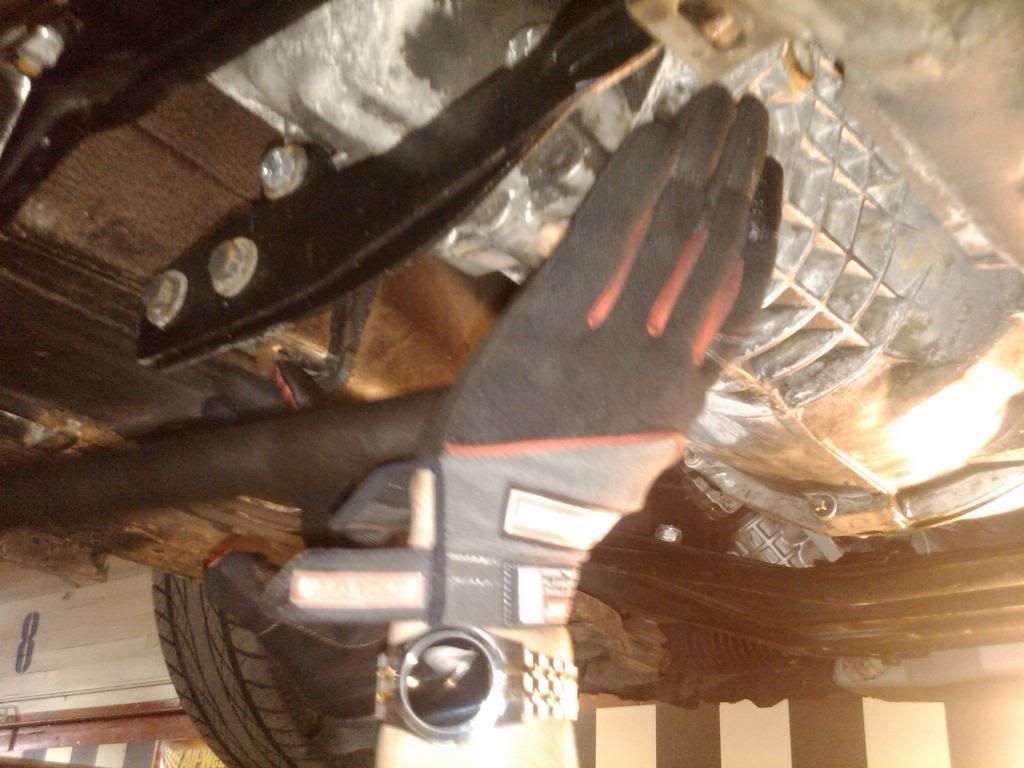

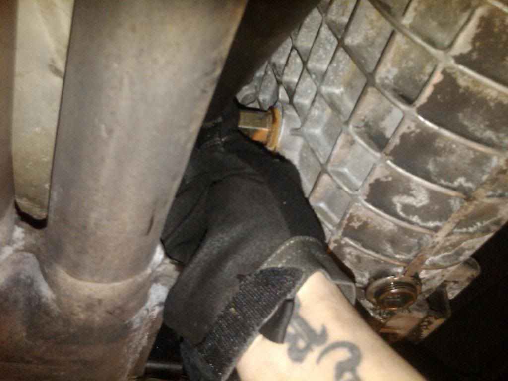

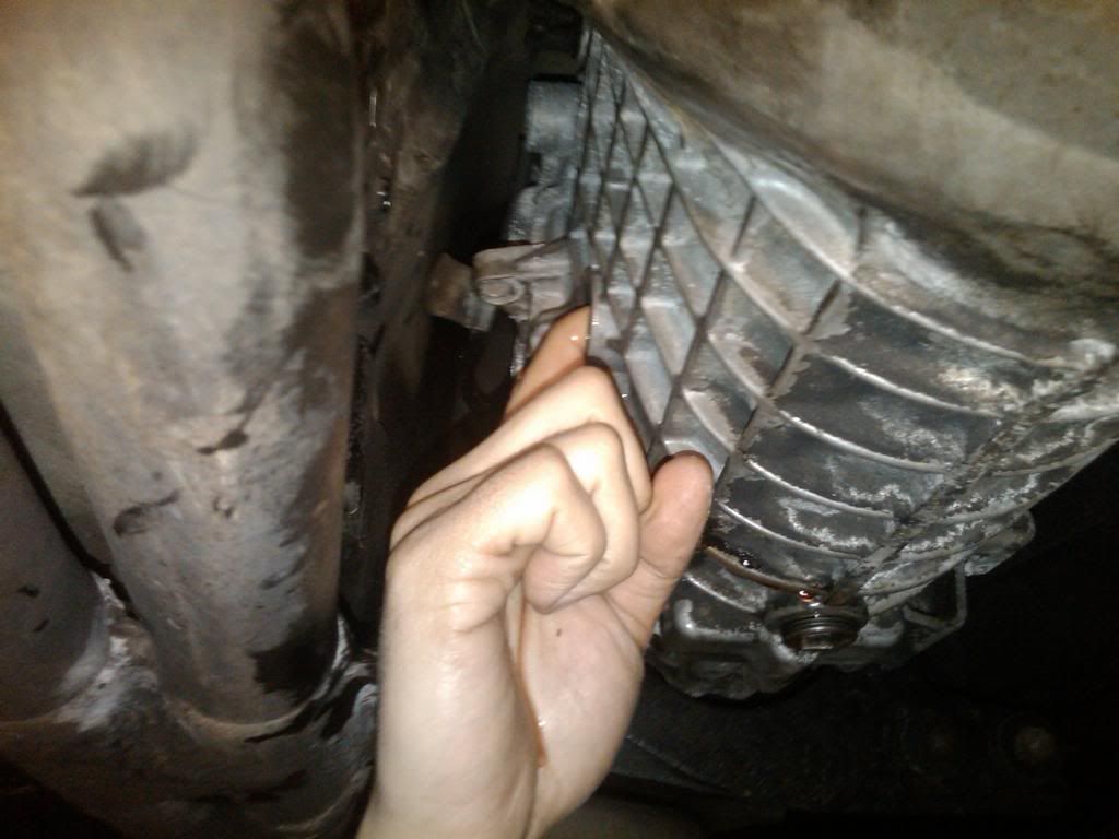

Next was the transmission, which is done in the same fashion as the diferential; remove the top fill plug, then remove bottom drain plug (with drain pan in place). The trans. took 2 full bottles of the Redline MTL, so don't spill any or you'll need a third bottle.

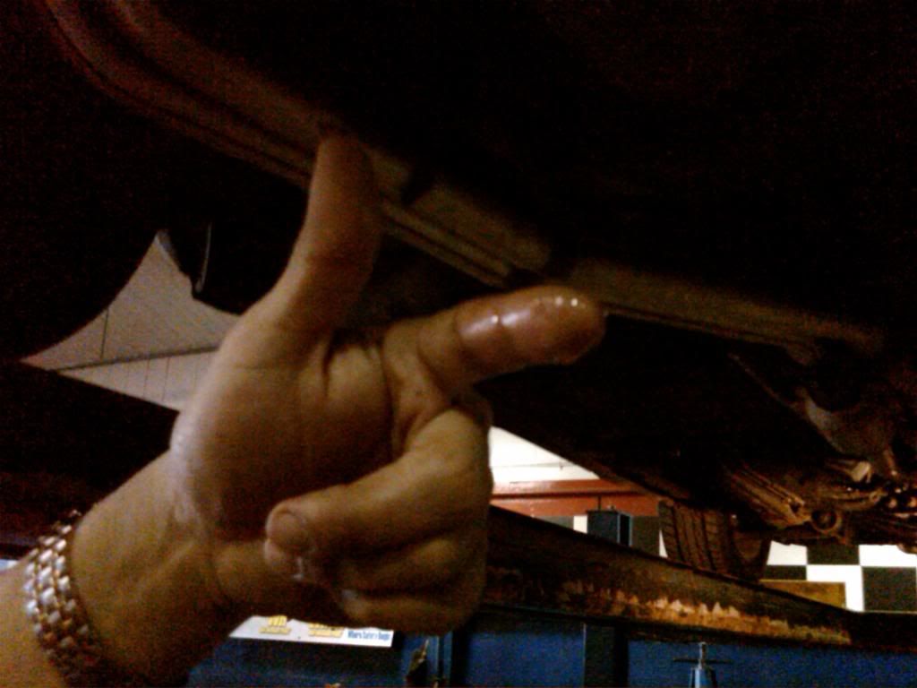

as before check the level with your finger, if it's just below the top plug your good.
