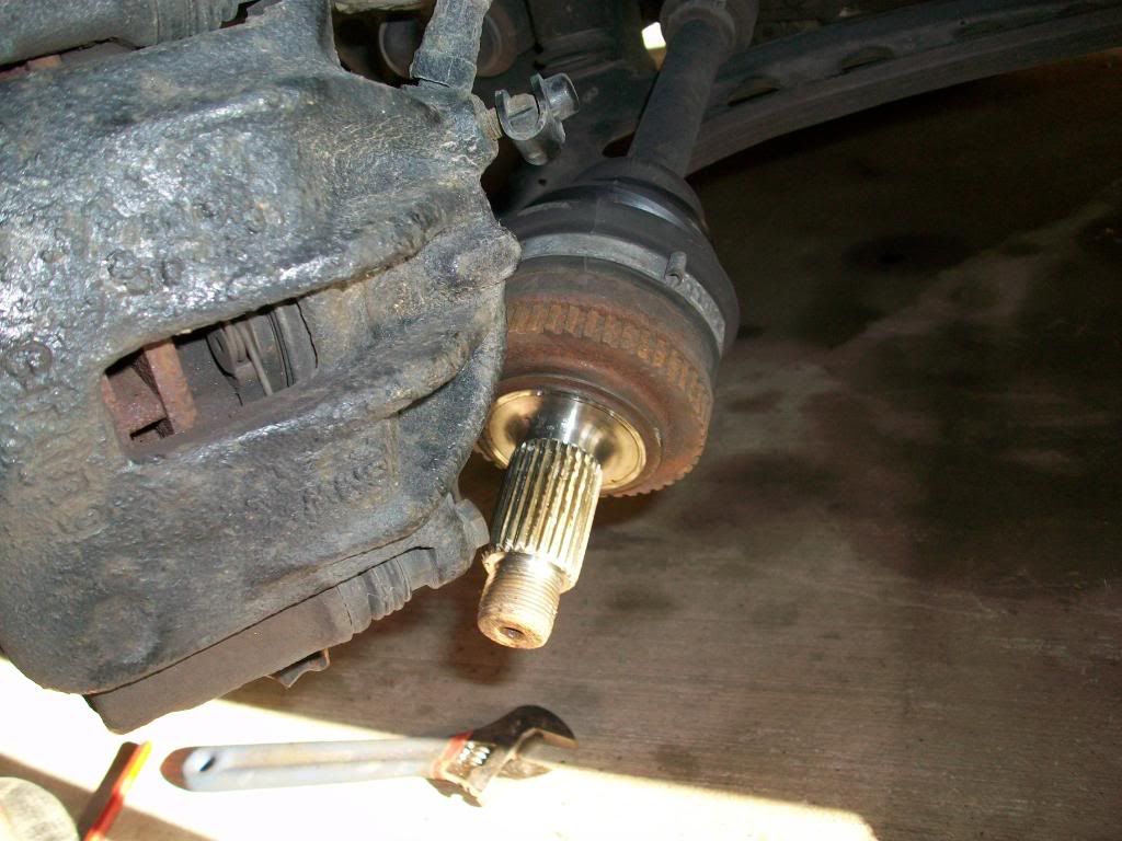

Now, pry out the old axle retainer with a small flat screwdriver or a pliers. It'll take a bit, but it will come off. Once that's off, use a 30mm socket and a impact (long breaker bar will work too.) If it doesn't break loose, it maybe necessary to leave the car on the ground to get it off. Mine came off with pretty quick.
Next we can take off the control arm nut. That requires a 22mm wrench to get that off. It can be a pain in the butt sometimes, but ball joint will get stuck in the strut assy. This is because the ball joint is tapered so it locks in. To free it, it takes a large hammer which you hit against the area where the ball joint stud goes thru the assy. A few good whacks and it should loosen enough that you can take a extension or something to put on the control arm to act as a drift to pop the arm out of the assy.
Next step is to pop the axle out of the hub. I am going to go back to this pic as a reference cause I forgot to take a pic for this step. On the end of the axle is a small indent. This is there so you can put the end of a drift on it for pounding the axle out. If your lucky, it will only take a hammer and a drift, but it can take a "pusher" (Ref Yoshi Wheel Bearing Write up for what i am talking about). Mine came easy-peasy so that was easy! :)

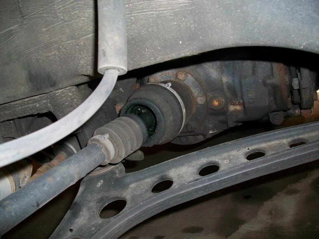

Almost out! Now, we just have to pop the inner joint out of the diff. I used a pry bar to do this. It will resist you prying it out but after a little bit, it should slide right out of the diff and there you have it, the axle's out! Only took me about 15mins to get it to this point....its the next part thats a pain..... :mrgreen: :mrgreen:

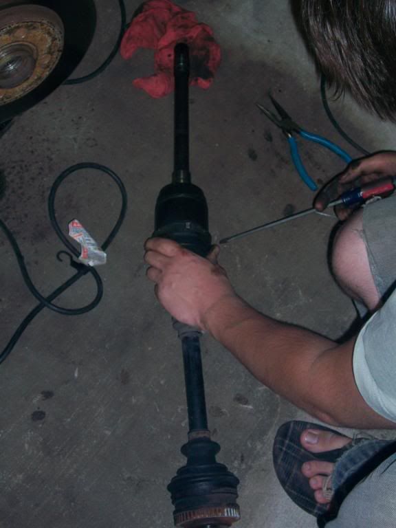

First start by undoing the boot clamp on the joint itself and the one on the shaft. they'll be nice and rusted so you can just cut them off or try to get it apart properly. Slide the torn boot back some so you can see what you looking at. At this point I HIGHLY reccommend putting on some gloves. Its up to you whether or not you do, but your GOING to get dirty.... :)
With the boot pulled back, this is what is looks like. Tasty right...

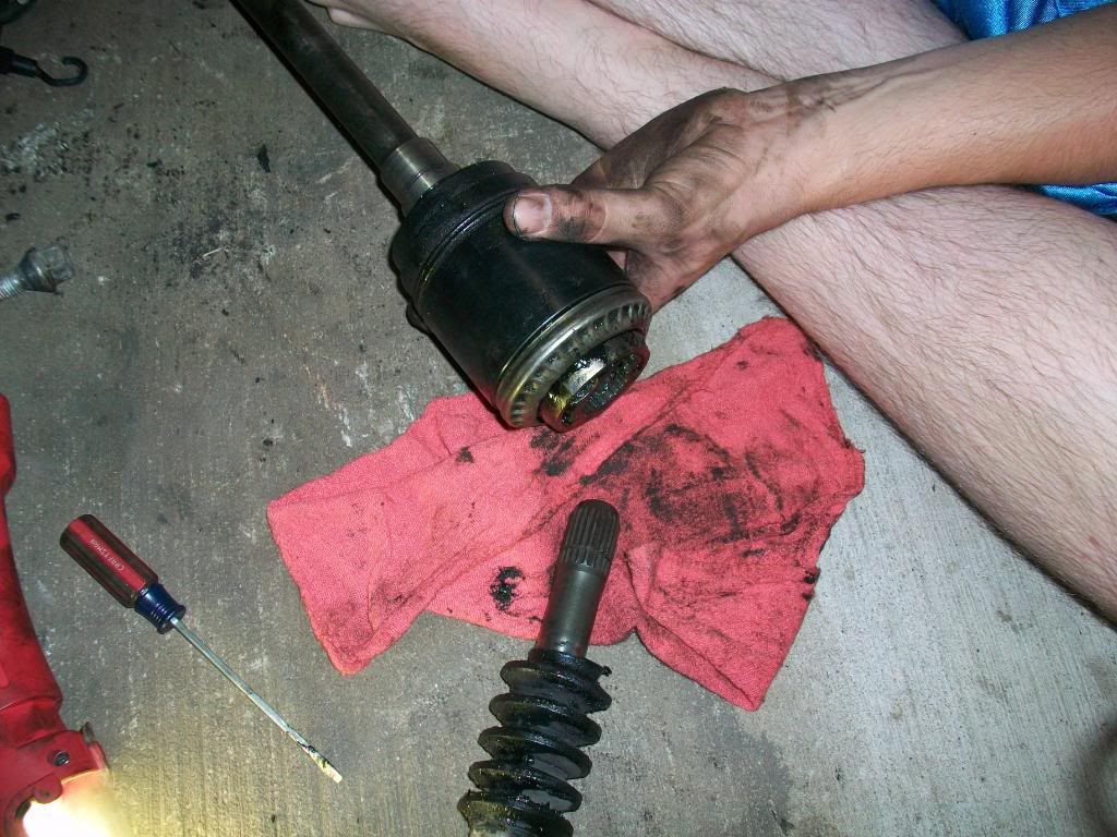

Wipe off as much grease as you can. It will just make things easier in the long run. This is where it really helps if you have a friend willing to get their hands dirty with you. If you look closely at the picture below, you will see a small circlip in there. You need to spread that apart while also having someone hit the end of the joint with a RUBBER mallet. Nothing metal or you could damage the joint. It should end up sliding right off the splines.
Up next would be pulling the old boot off the shaft. Clean it up all nice and such and slide the new boot with the small clamp onto the shaft. Now, go back to the joint and clean as much of the old grease out as you can. I just used a couple of cheapo rags to do that. Anyway, we need to remove the old circlip. It will pop out of there with a little persuasion, but it will come out. Same goes with reinstalling the circlip included with kit.
