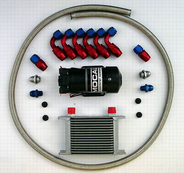

A nice thing to add if your beating the piss out of your diff that you put much money and effort into would be a real cooler setup.
Like this one VAC sells, but can be pieced together for less
A 12v oil gear pump, plumbing and a small cooler core can be done for ~$250 with some good shopping. Add a temp switch and a relay and it can be made to come on automatically 8)

I like the idea of the cooler. It's just out of my price range right now. I will probably do it in the future.

Thumbs up homie! It's really really easy to do. I'd love to do the oil cooler one day. When my car drives on its own power.

But on an unrelated note: http://www.amazon.com/Amarine-Made-Scav ... 1FWKXD49NP
$80 for a pump... do some wiring. Cool diff for $100?
