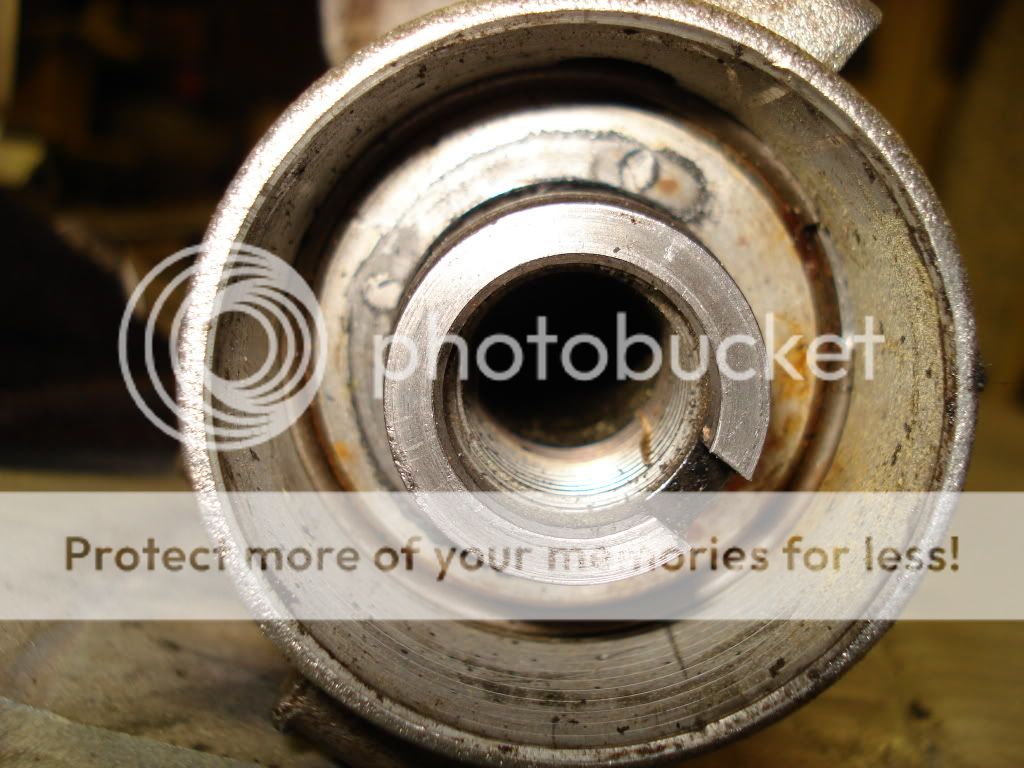

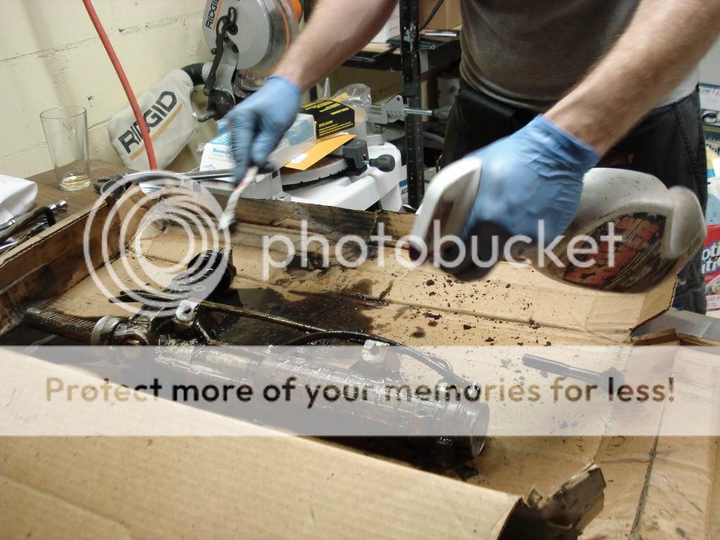

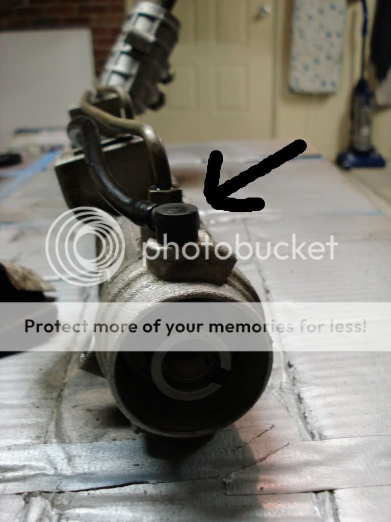

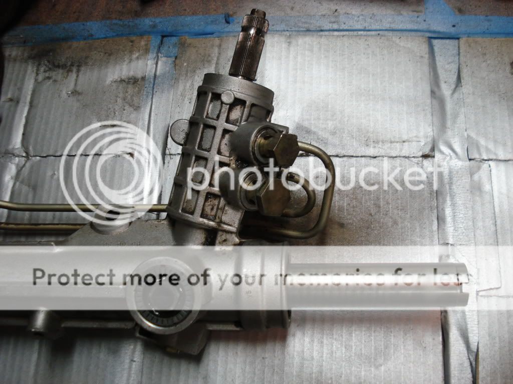

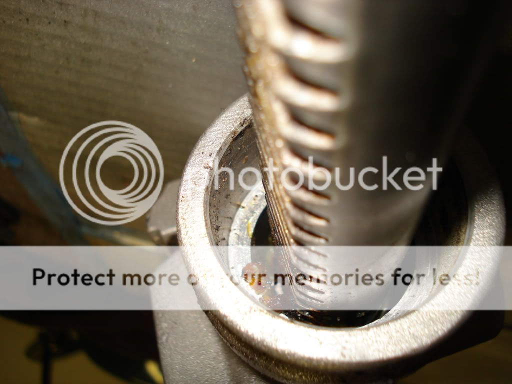

Postby beemnmatt » Sun Apr 25, 2010 1:49 am
Well I am almost ready to switch out my rack and pinion. I got the e36 rack and the seal kit. I took some pics....not sure where to go and I do not want to mess anything up....
Thanks!

Postby M20_fever » Sun Apr 25, 2010 5:51 pm
man that thing is filthy. you should do a write up on this, if its thorough I'll sticky it.
