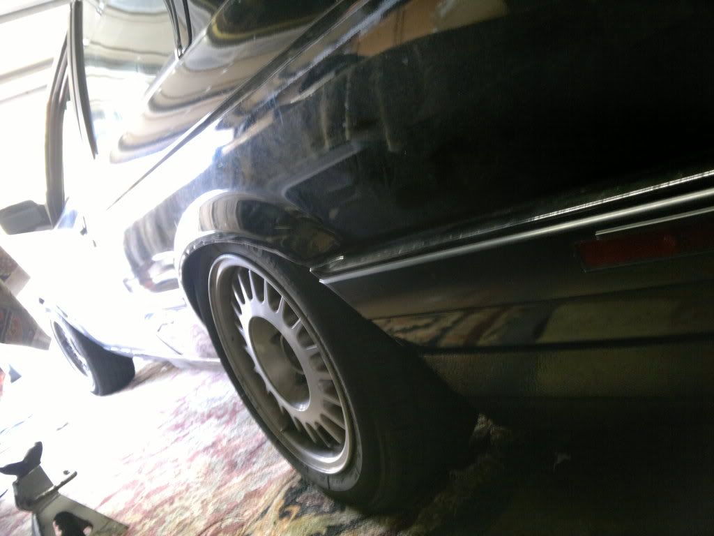

this is how it was sitting (oem replacement billies all around + eibach springs) too soft, i didnt like it.
went to the drift event at Infenion. with same soft set up. did pretty good. but didnt like it at all.
as you can see the car is leaning like stupid...no bueno.

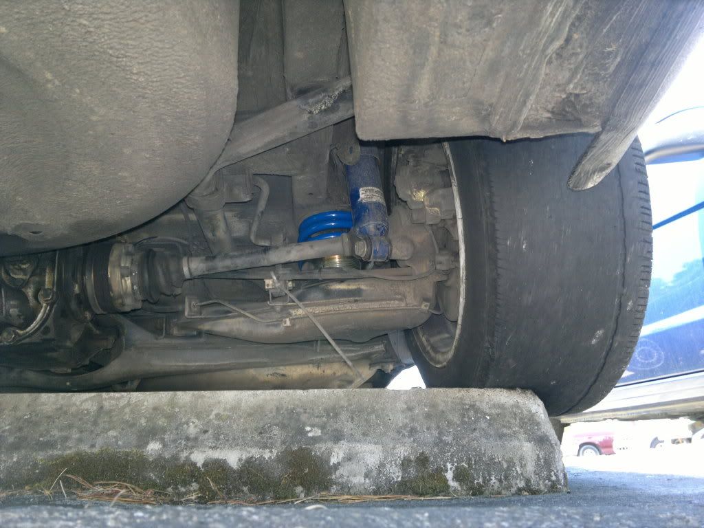

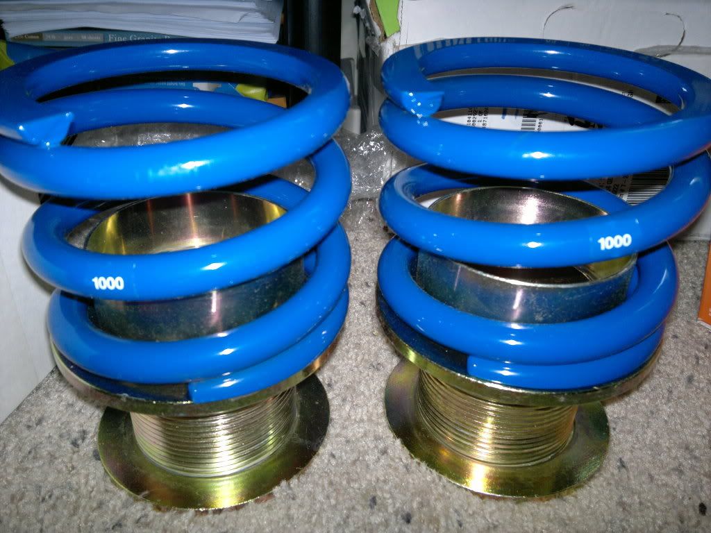

For those who was wondering about my rear set up.
here we go
this is really all it is. camaro adjusters, with camaro springs. Just weld them on top of the control arm and used some double sided tape on the spring so it doesnt move when suspension decompresses.
right here you can see lowest setting. car sitting on the tires. need lower profile
Cheap, yes, but again its just springs, so i dont mind.
here we go
