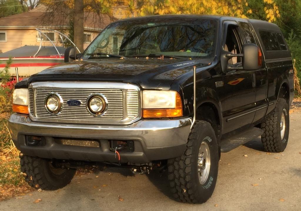

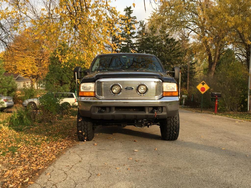

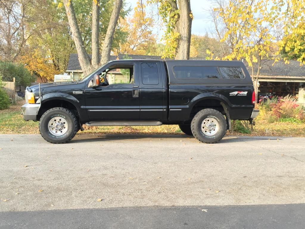

I tried something new on the chassis of my truck this year, should have taken pics. It's Rustolium Professional Grade in gallons, applied with an airless Wagner painter. Stuff goes on SUPER thick, used a gallon plus a pint for the entire underside of my truck, and I mean everything including the exhaust, inside the bed sides, fenders, suspension, everything. So far it still looks like new, we'll see how it holds up come spring.
edit:
Hard to tell in these pics, but you can kinda see how everything under the truck looks basically new.
