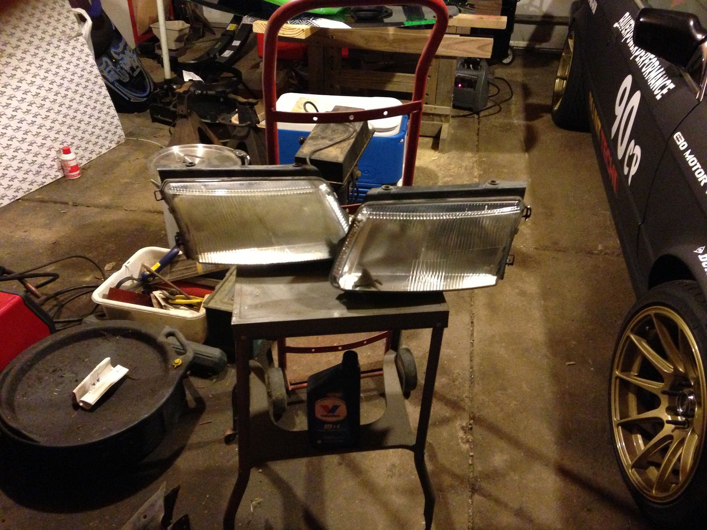

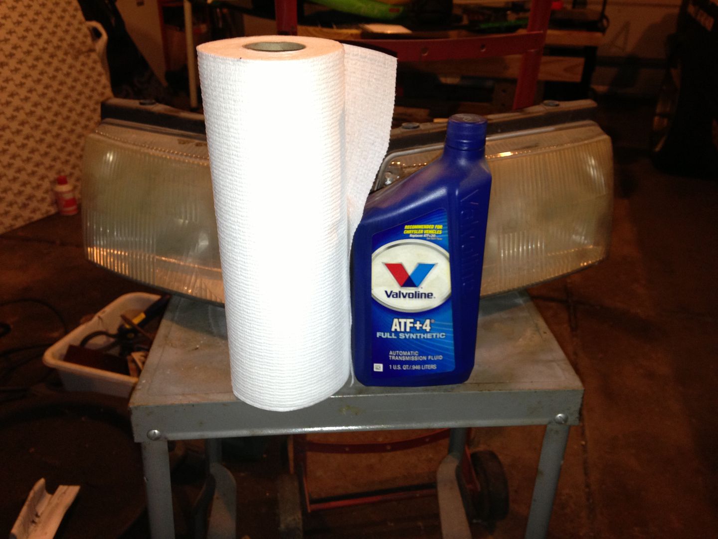

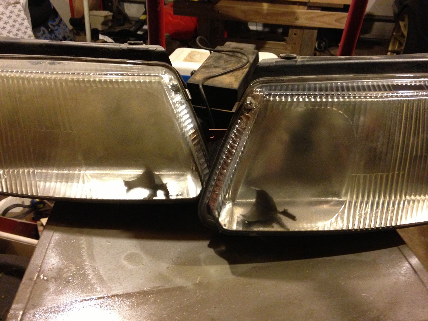

Well, I heard about this a while back and have been dying to try it. I replaced the housings on my Passat, and had the old, faded/foggy housings sitting around so I figured it was a perfect opportunity to test the rumor.
Note: I believe this only works on plastic lenses, so not applicable to our e30s, but from e36 on it should work.
Here is what I started with:

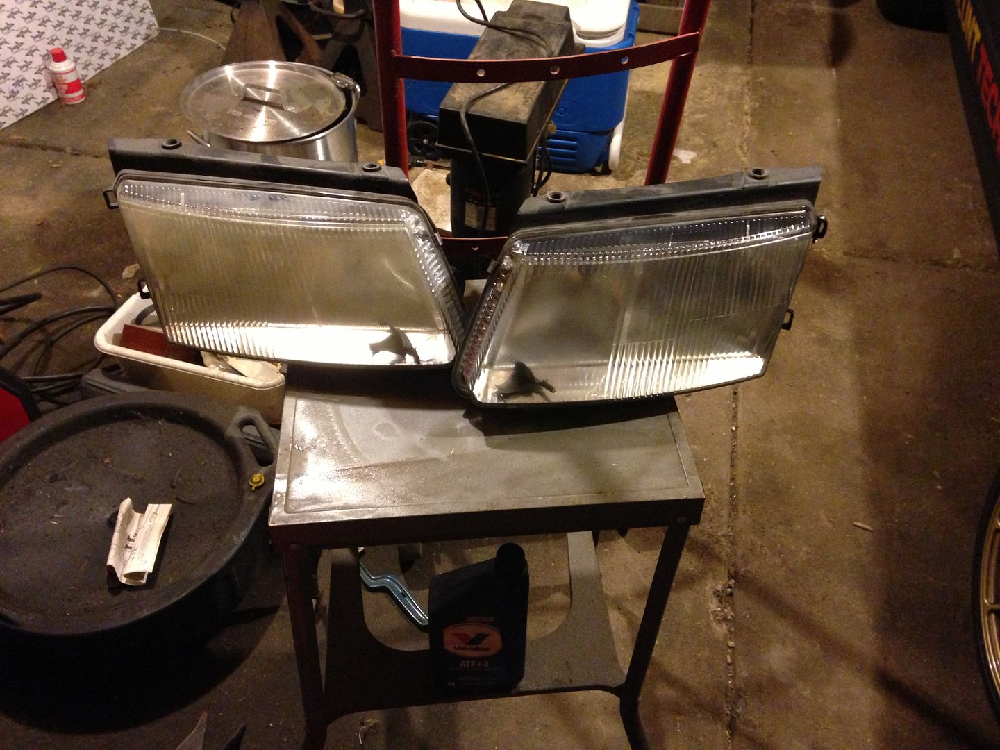

and here is the result:
Pretty good results for about 15 seconds worth of work. Granted, its not perfect, but a lot better. I'll put these outside and see how they weather, call it an experiment. I'll leave the other one as it was and see how long it takes the treated one to get back to matching the untreated.

I'm interested in how long this will last. If it lasts 6 months, it's almost worth it. I'd still rather go at it with the real sandy/gritty stuff to get it to last for half a decade.
Re: ATF to de-fog your faded plastic headlights
Postby M20_fever » Mon Jul 22, 2013 7:06 pm
if it lasts 3 months it's worth it considering it literally took 15 seconds.
