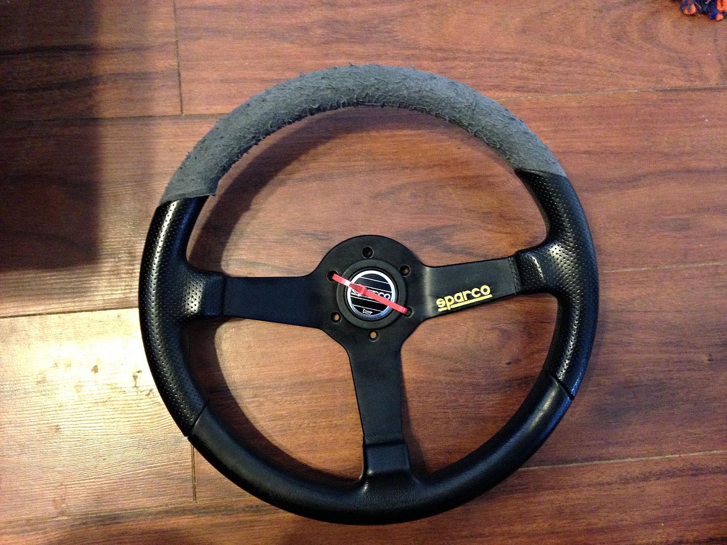

Well I've wanted a nicer steering wheel than the ugly airbag wheel I was blessed with, but I've never been able to justify spending $300+ on one when the stock one works fine. As a racer that's a couple tires or brake pads, so it never happened. I was browsing the forums a couple weeks ago and came across a deal I couldn't pass up.
The seller was asking around $50 for it, and I ended up paying $38. Definitely needs some love, but a solid start.

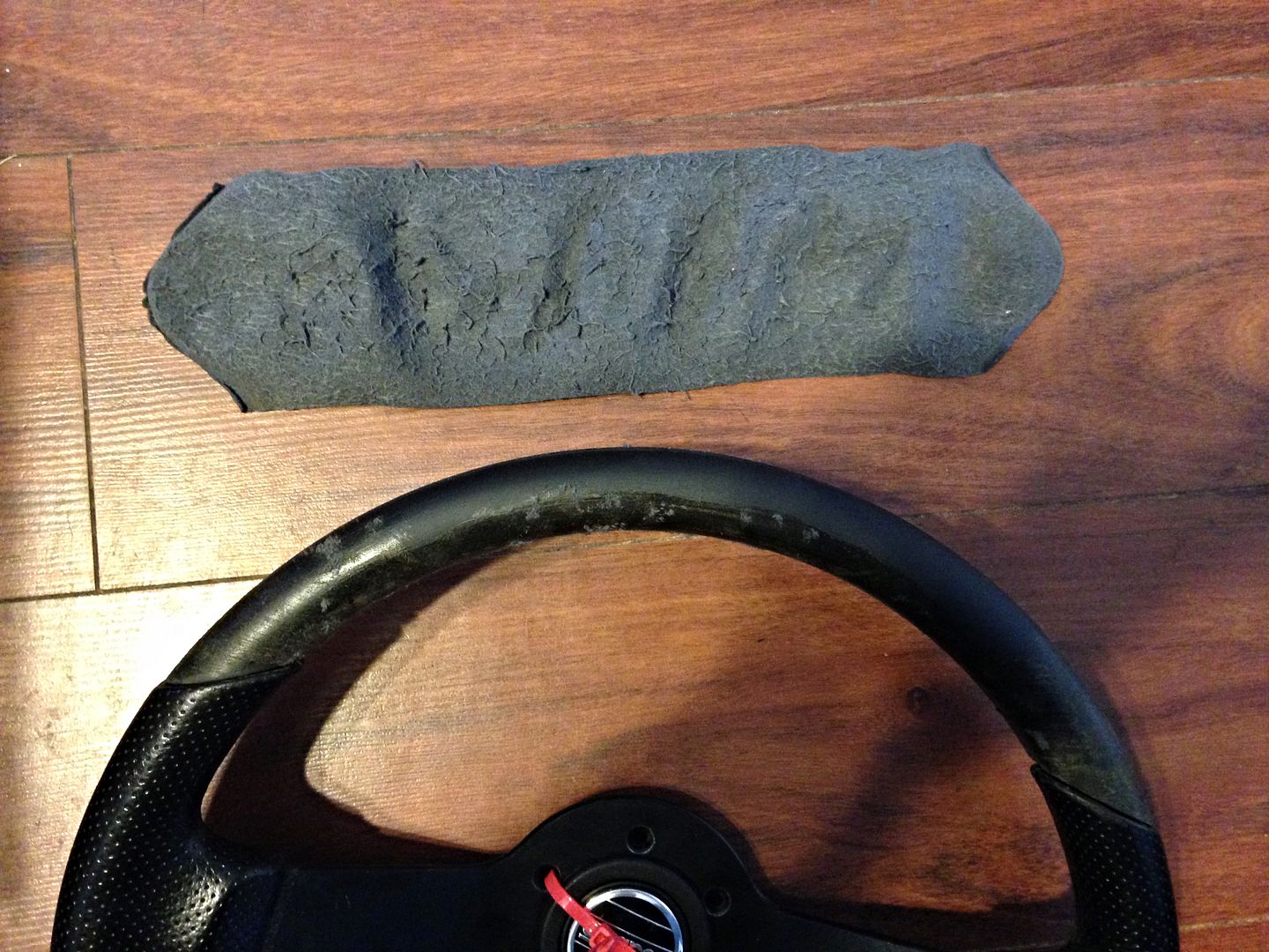

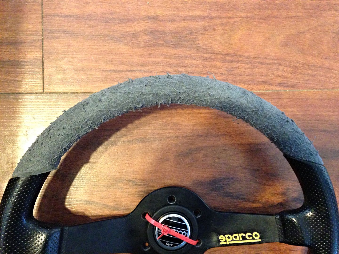

The suede has seen better days...

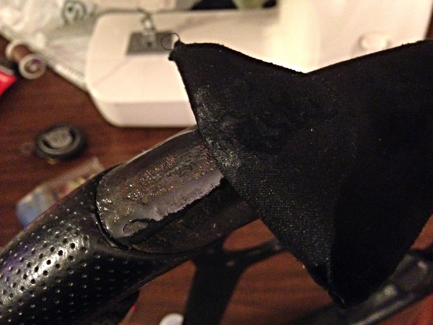

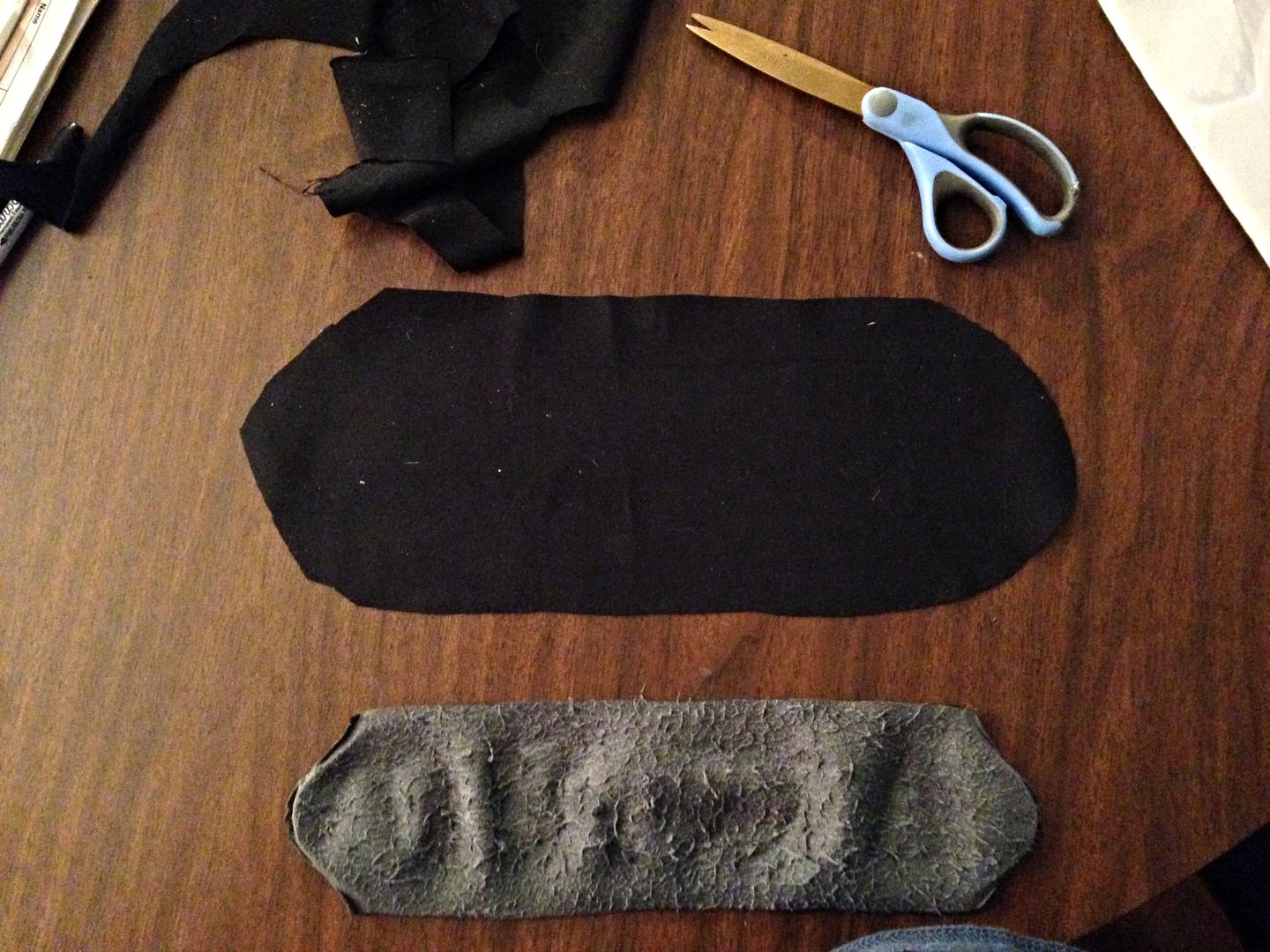

Time to get down to business. Pulled the worn out suede off, but I was careful since I need it as a template.

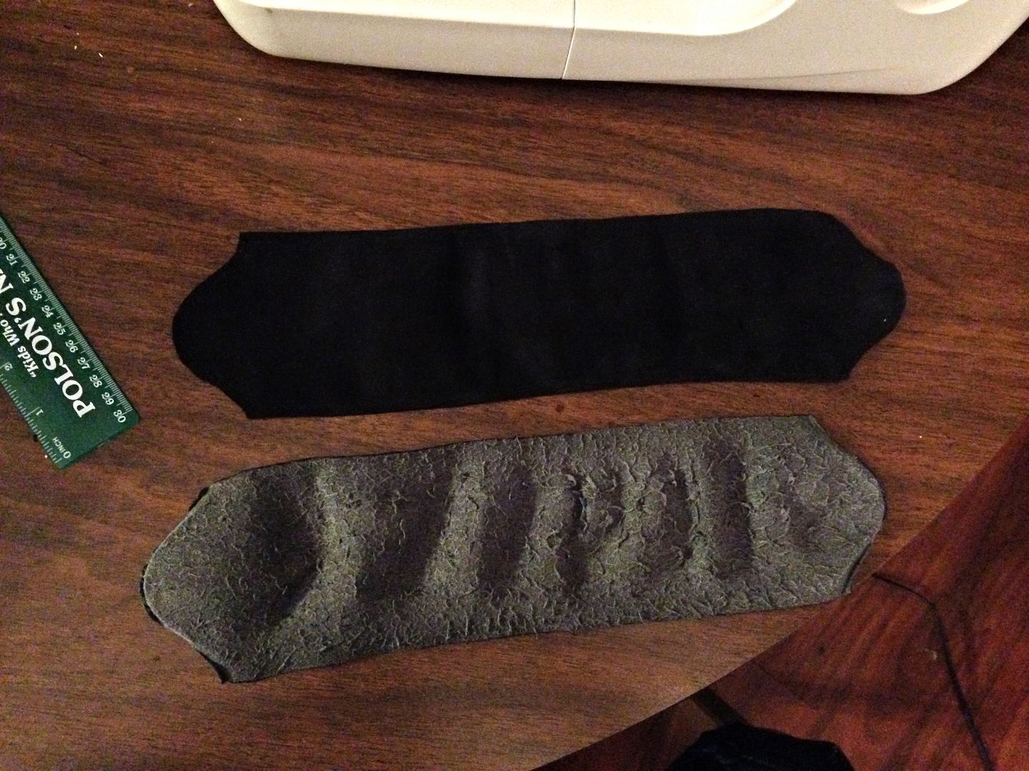

I ordered up some black microfiber (fake suede) - $11 shipped. So now I'm $49 into the wheel. The microfiber suede was 48"x46" so I'll have plenty left for other projects like shift boots or whatever.
I traced the old piece, and cut out the new piece, leaving plenty extra material.

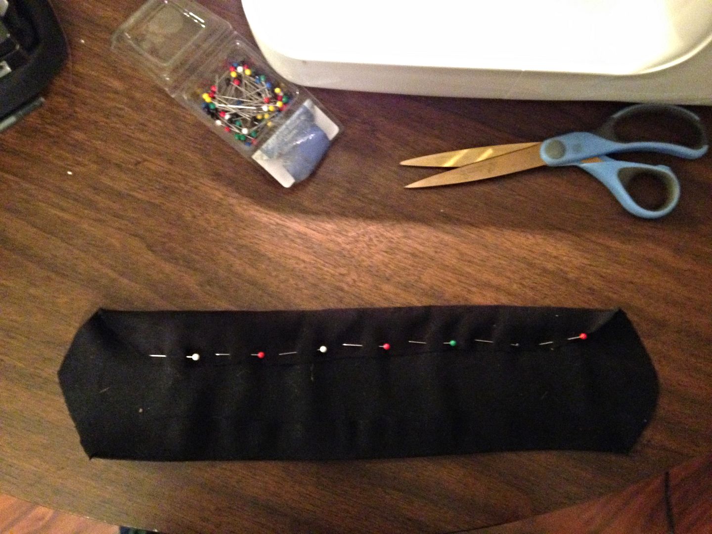

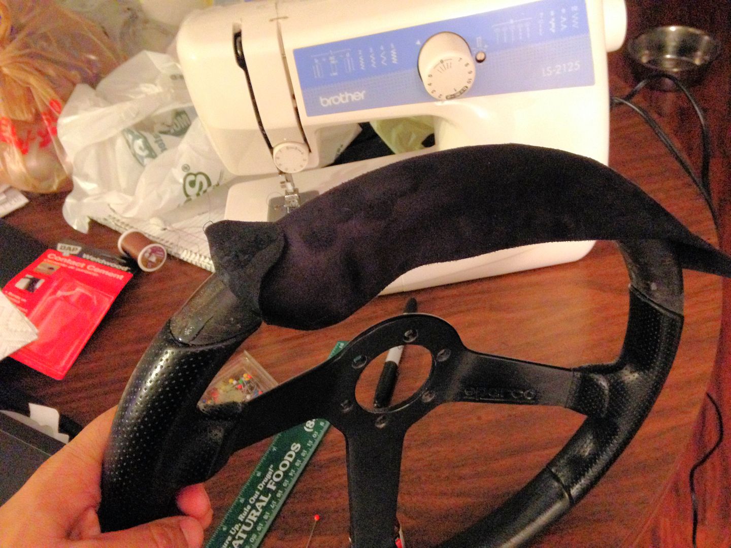

All pinned up and ready to get my sew on. Side note: I've never done any kind of sewing, so this was a learning experience for me. Thankfully my Wife is pretty handy with this stuff so I had a good teacher.
All sewed up and trimmed down to final size. I test fit it and it's pretty darn good IMO.

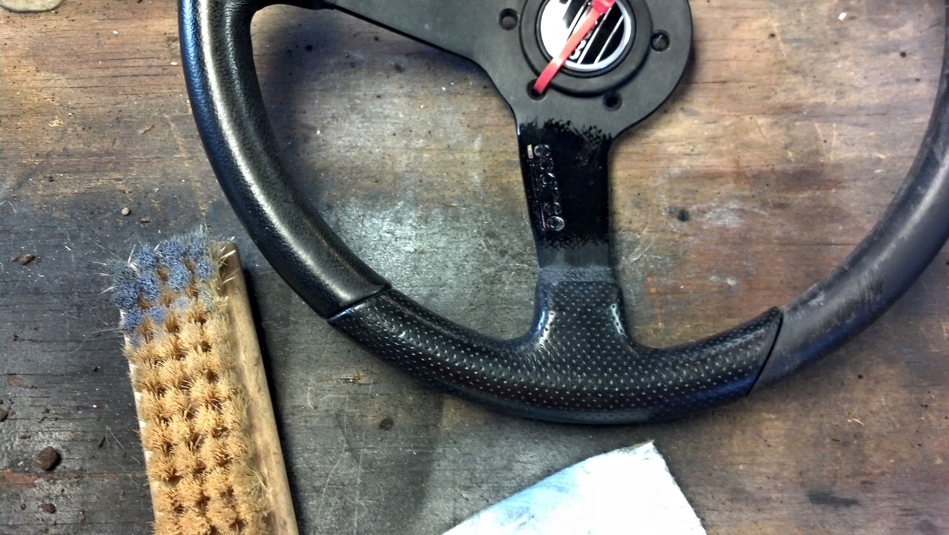

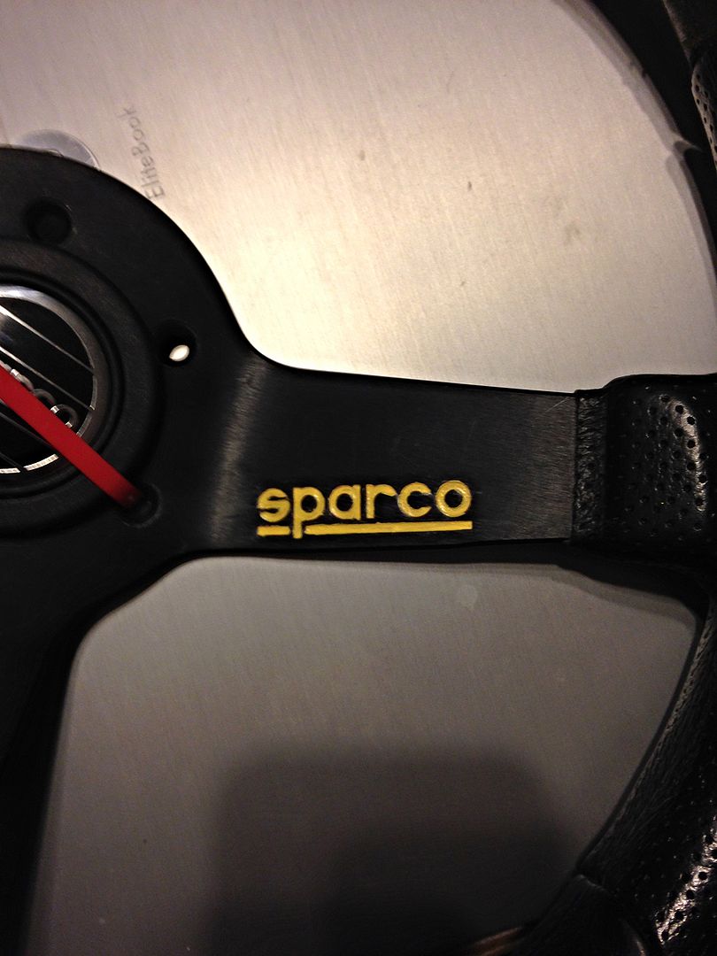

One of the POs decided to hand paint the Sparco logo, and didn't do the best job.
I soaked a paper towel in brake fluid, wrapped it around the spoke, and let it sit overnight. Then I just had to lightly brush it with a stiff nylon brush and it came nice and clean.

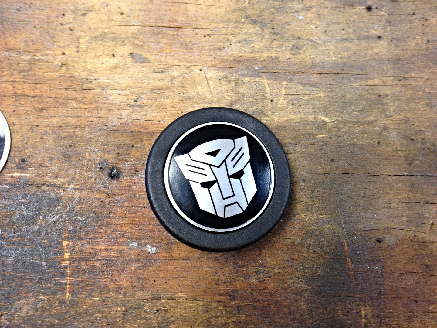

I have a pretty neat plan for the logo, but I'll hold my tongue on that for now.
This just because I'm a dork.

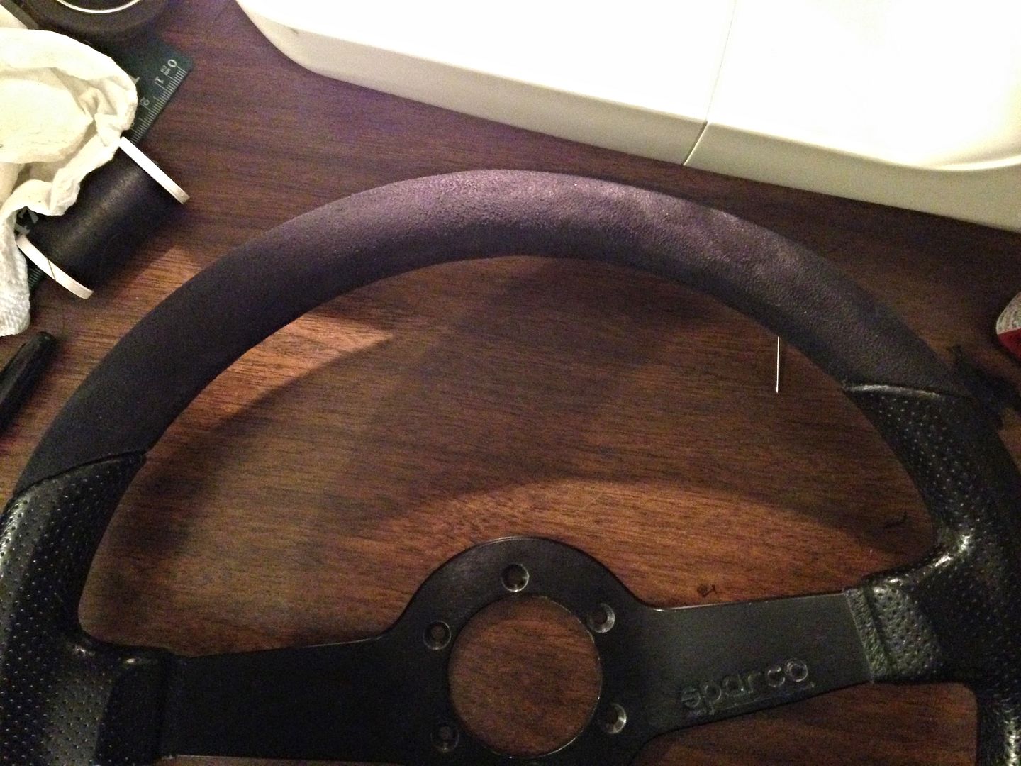

Postby M20_fever » Mon Apr 07, 2014 2:51 am

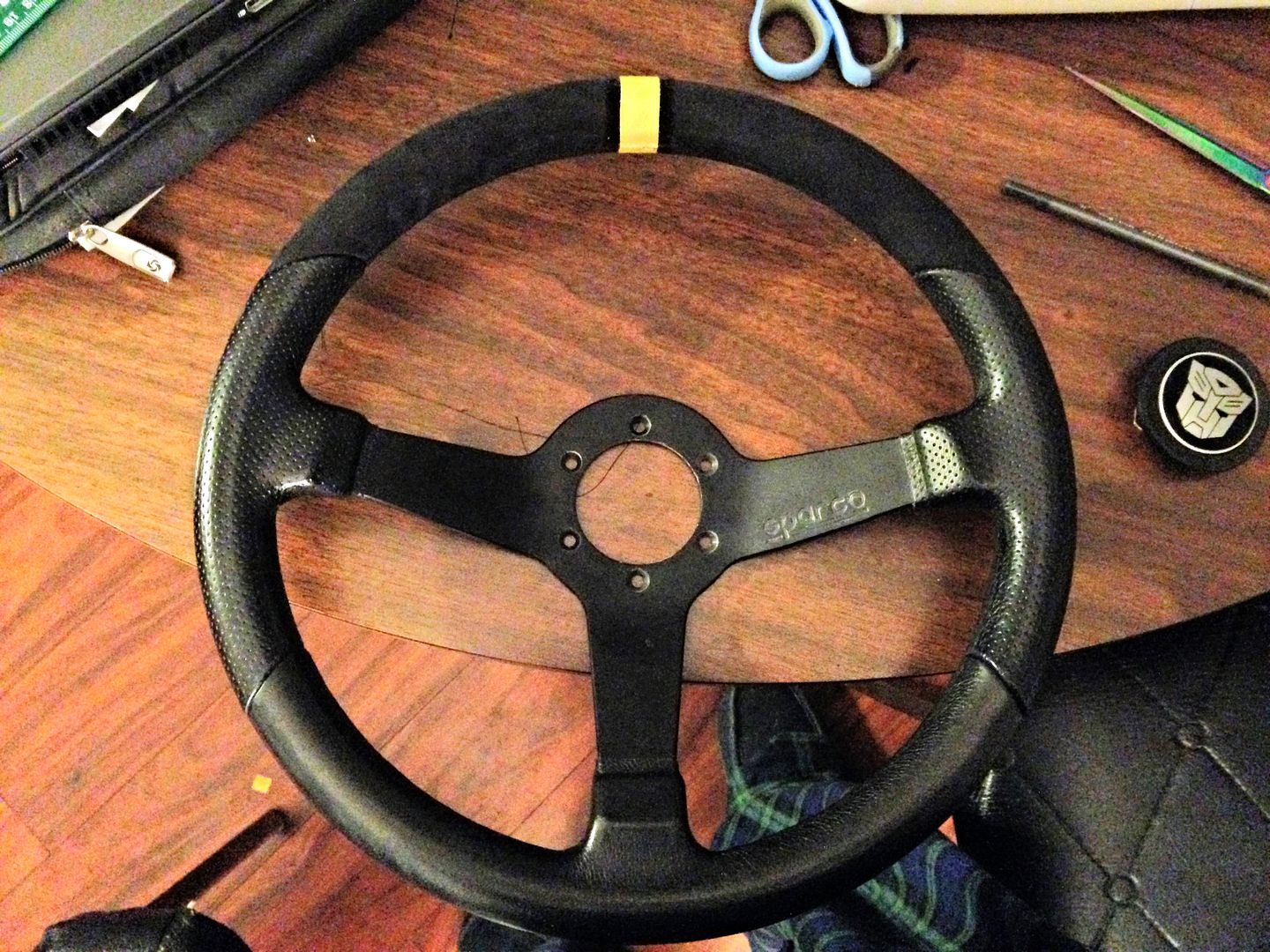

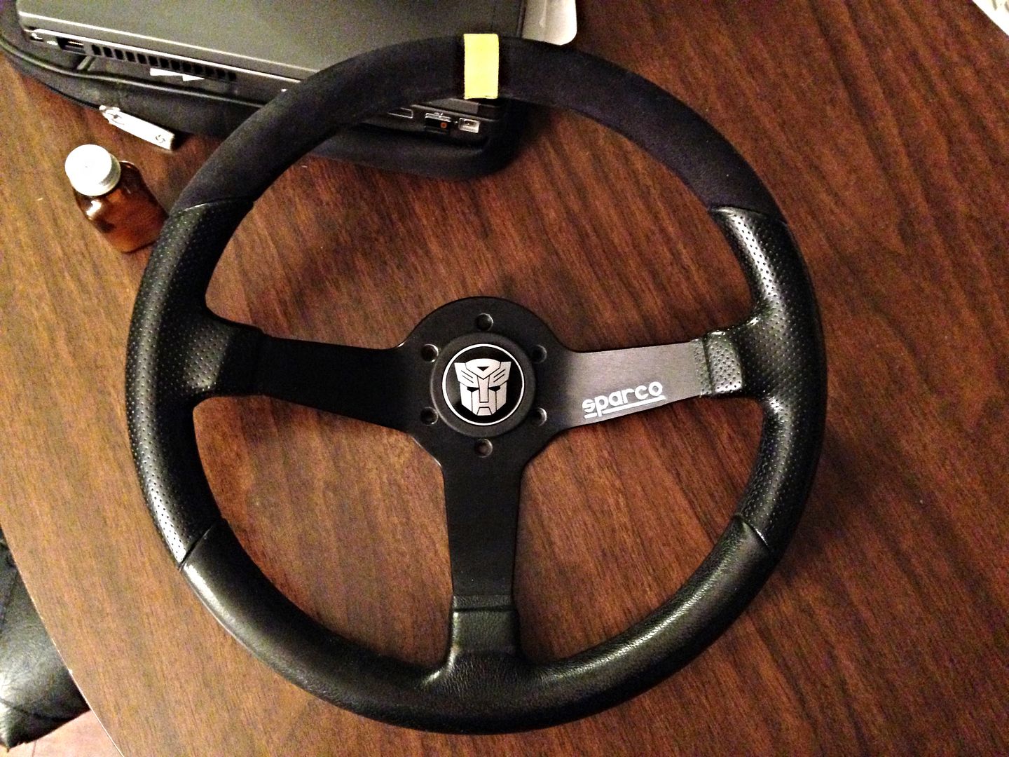

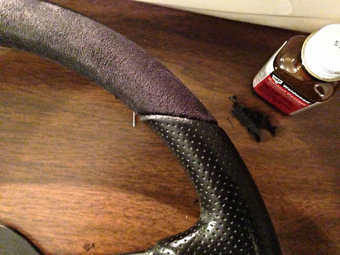

ok, changed my plan after getting started. I JUST used contact cement to put the fabric on. Worked pretty well IMO. Why you say? Because I got three stitches in over about an hour, and they looked like poop.
I did about 2" at a time starting along the top, then repeated the same on each side. Took a few hours with 15min flash times on the adhesive, but it was worth the wait I think.
Added a centering stripe because race car.
All done!
Actually, I still have something special for the Sparco logo, but I have to wait for it so I painted it for now.
I think it turned out pretty good, and I only have $58 invested so I'm pretty stoked.
