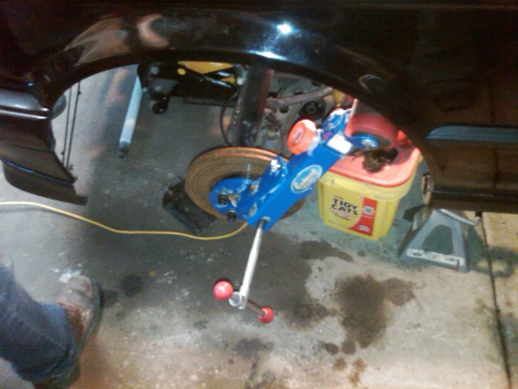

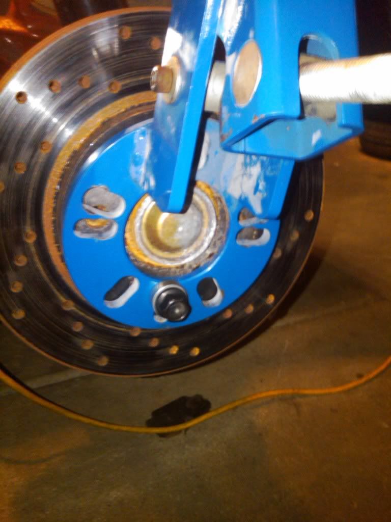

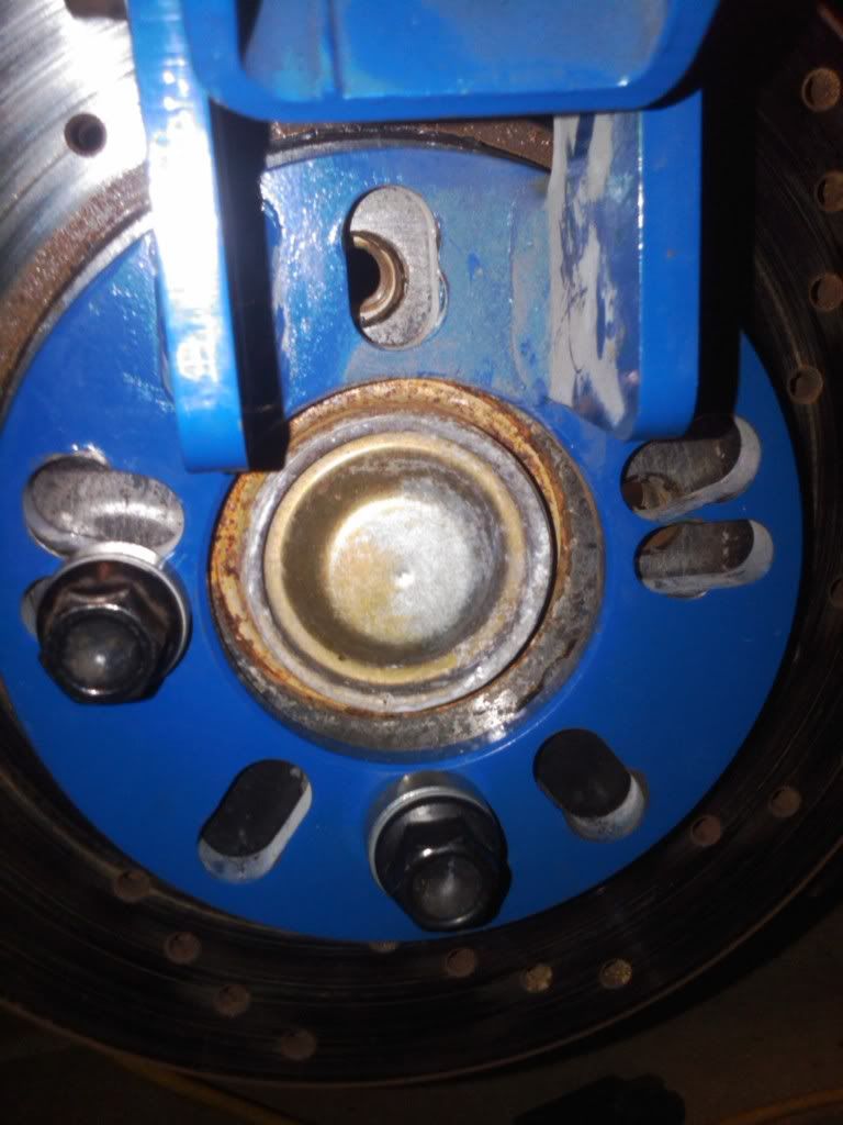

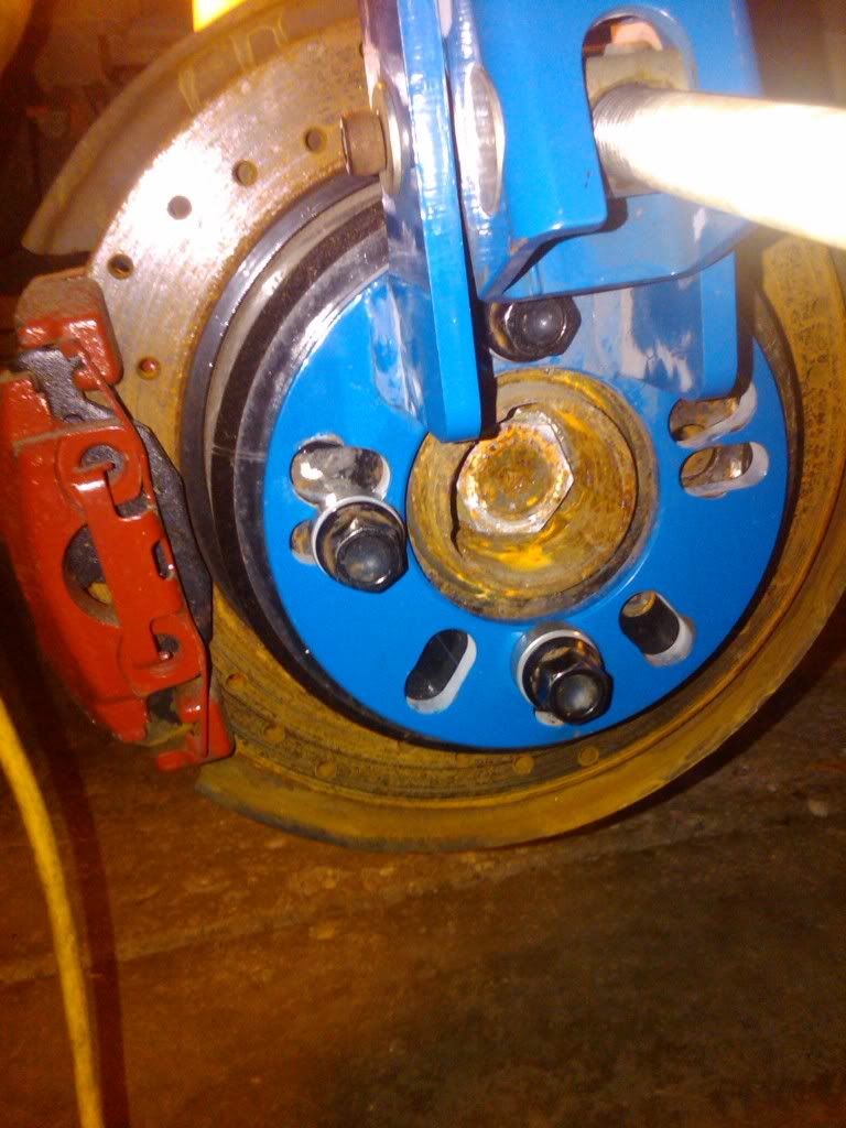

Once the fender liners are removed and the fender lip has been thoroughly cleaned the Roller can be mounted to the car. The Eastwood roller I used is not set up to bolt directly to a 4x100 lug pattern, so I was only able to get 3 lug bolts in. This posed no problems so don’t spend too much time worrying about it. When mounting the roller to the hub you need to use the concave washers included with the roller (pictured below).
I was only able to get 3 lug bolts in if I started the bolts in a specific order. I first started the bottom nut, being sure to only start the threads so there was plenty of play. Next I started the left hand bolt, then finally the top bolt. You will notice there is very little clearance to get the top bolt started, this is not an issue since the bolts should only be finger tight. Tighten the bolts by hand enough to eliminate any play in the roller, so the roller mounting plate sits flush against the brake rotor. You will notice the roller is not 100% concentric on the hub, this is not a problem.

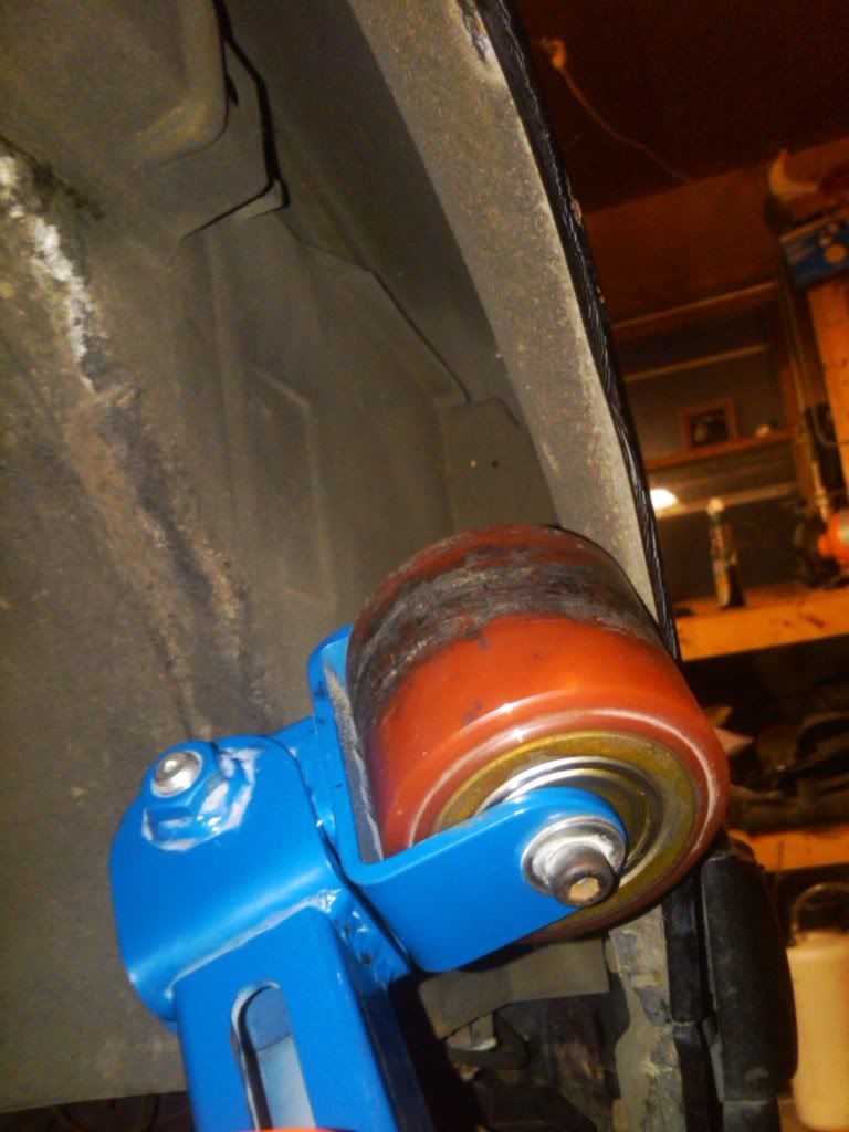

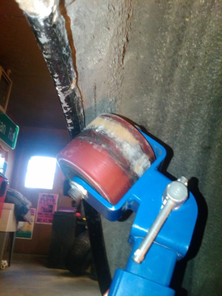

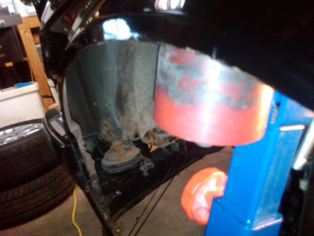

Now it’s time to adjust the roller to make proper contact with the first section of fender lip to be rolled. Notice I said “proper” contact, starting the roller at the proper angle is critical to getting nice clean results so take your time here. The roller should initially be set at a pretty shallow angle to get the lip rolling in the right way. Remember, you are going to work small sections at a time at one adjustment setting until the whole fender arch is done, then re-adjust and do it again. Don’t be in a hurry and take your time or you will regret it, each front fender took us about 45min and I wasn’t using a heat gun since I’m not concerned with the paint cracking. I have included a couple pics of my initial setup, note the angle of the roller.

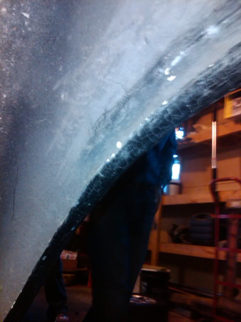

Before you begin rolling you need to decide if you care if your paint cracks too much. I say “too much” because from what I hear, even using heat usually results in some paint cracking. It really depends on how much you are rolling the fender lip. I rolled mine flat so I’m certain the paint would have cracked even with heat. I’m painting the car this winter so I didn’t bother with the heat since I didn’t care about cracking, and boy did it crack, haha. If you do plan to use heat to reduce the cracking only heat small sections as you’re rolling. Use a hot day in 100* direct sunlight to be the benchmark for how hot you should get each section before rolling. Be careful with the heat gun or you can easily melt the paint which would look worse than the cracking, lol.

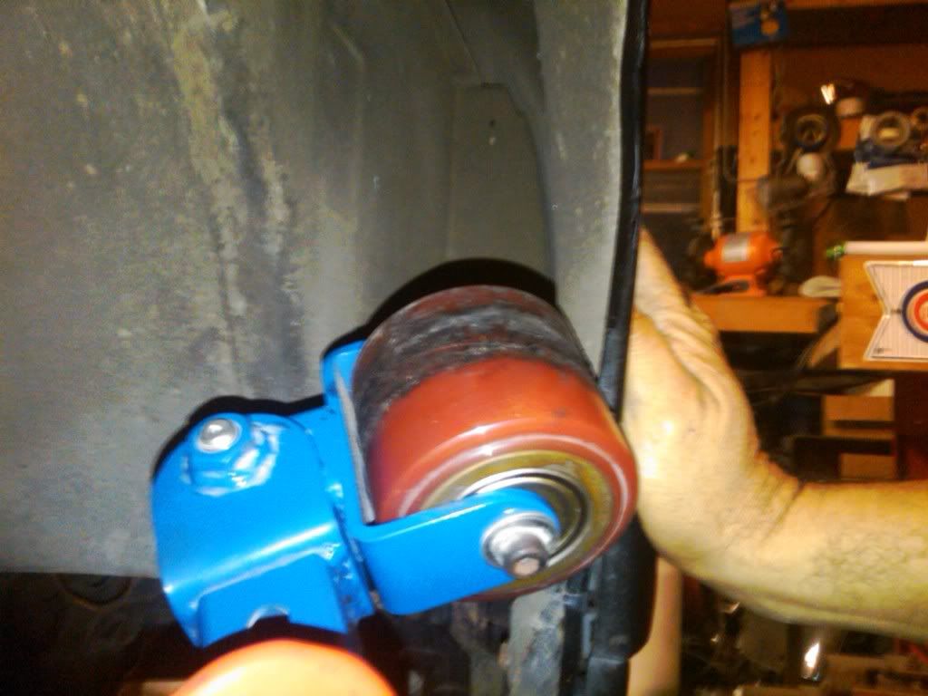

Now you’re ready to start rolling. I found this process to be much easier with two people, one person working the roller and one person putting pressure on the outside of the fender where the roller was contacting (the second person would also be responsible for running the heat gun if used). Starting in the top middle of the fender start working the roller back and forth in a small swing while slowly turning the pressure up using the pressure adjustment rod. When you feel and/or see the lip starting to bend upward stop adding pressure and work the roller back and forth several times until the lip is evenly bent up in that location, then swing the roller down to the next section, working your way around the fender radius. It may be necessary to adjust the pressure as the roller moves from section to section, and this is done by feel alone.
The key here is patience, don’t try to roll the lip flat in 2 passes or it will fold unevenly and result in waves that can be seen from the outside of the fender.

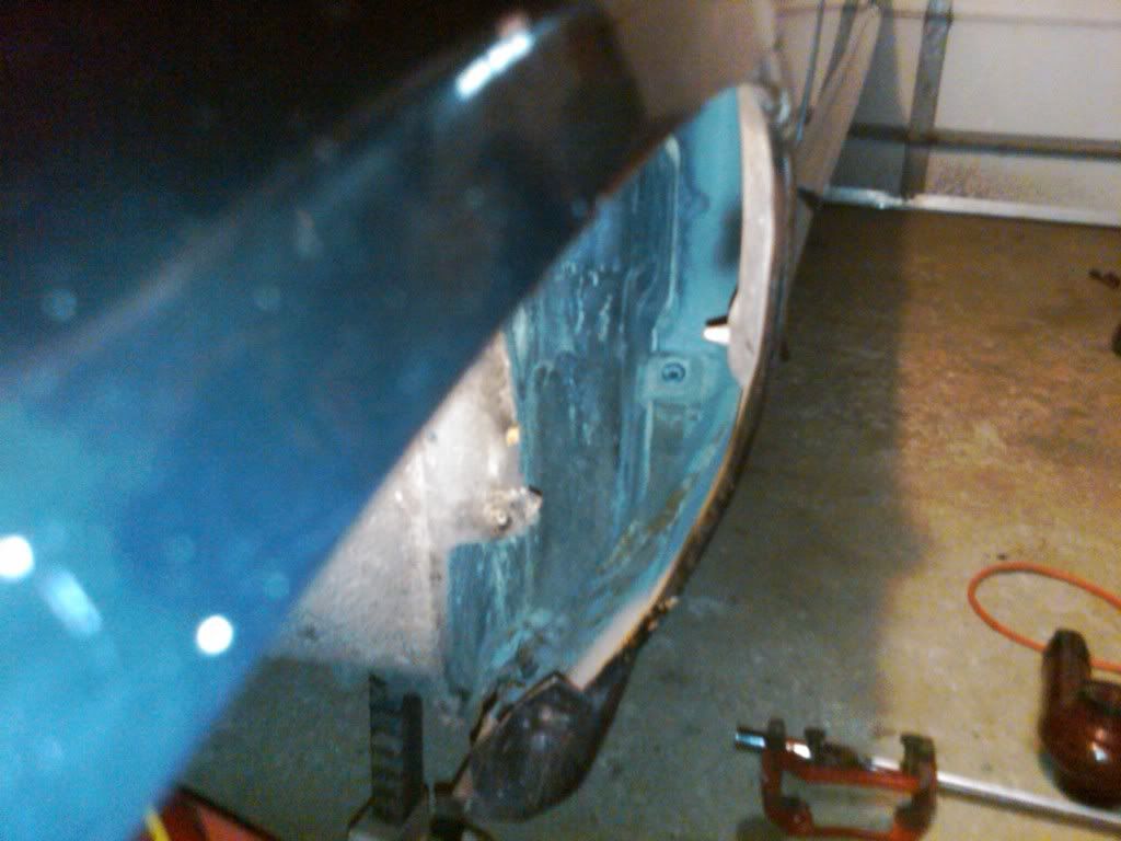

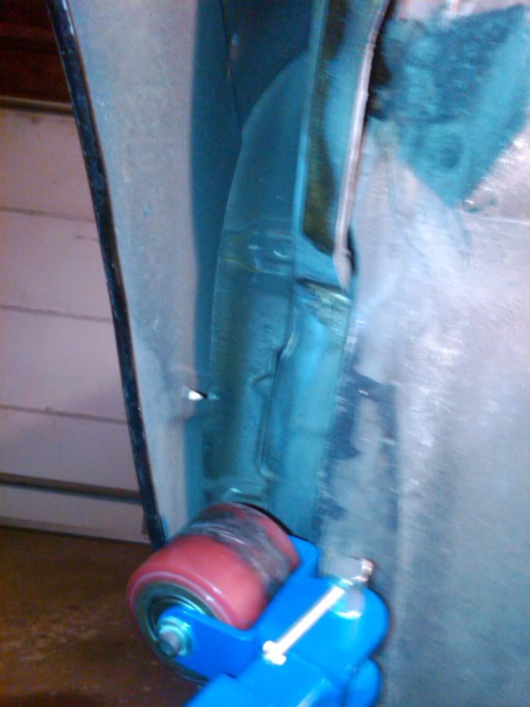

Here is the lip after the first pass of the roller.

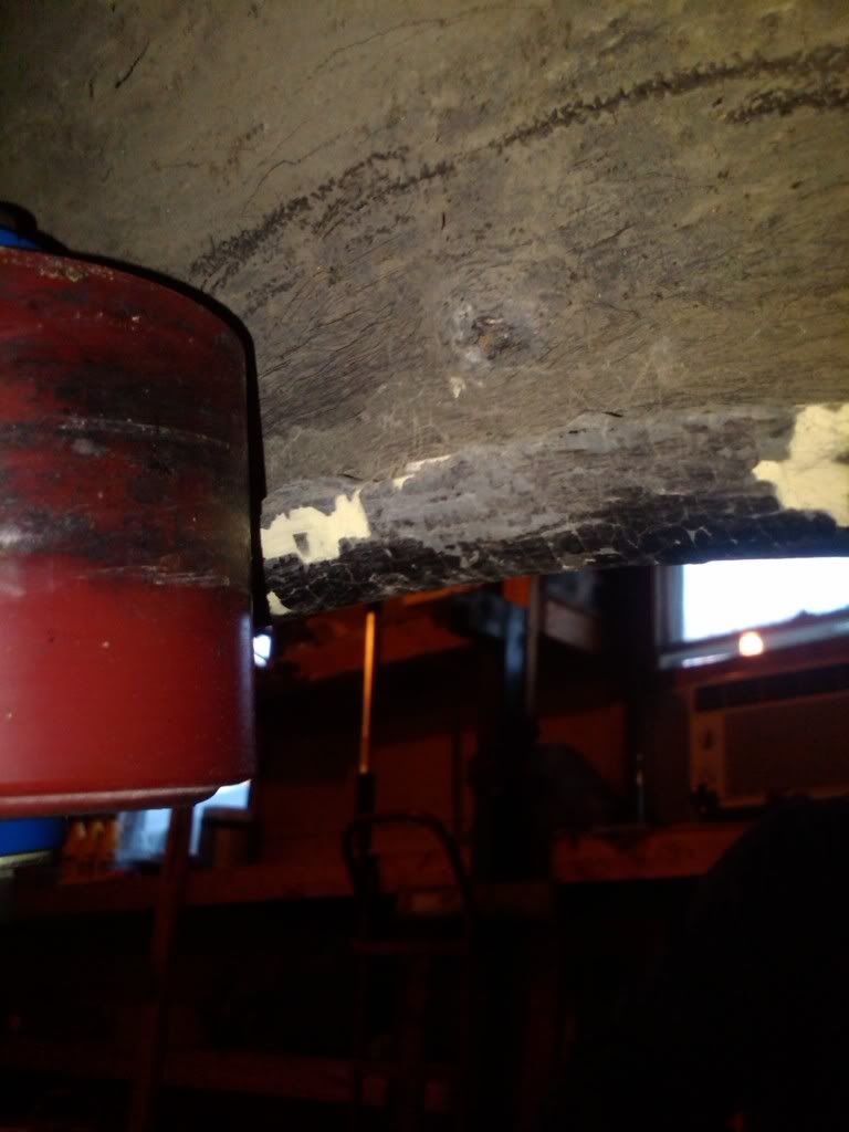

And the second pass.

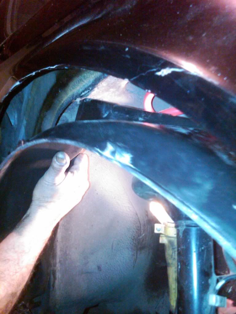

Here it is after 4 passes, pretty much flat. If you try to roll any flatter than this you will start pulling the fender, so if you don’t want the pulled look this is as far as you go without pulling out the body hammer and hammering the lip perfectly flat. Be aware that taking a hammer and dolly to the fender will require paint work when all is said and done.
At this point I decided I wanted a slight pull on the fender since I like the look and it gives me a bit more room for rubber. Pictured below is the setup angle I used to pull the fender, notice that the roller is positioned to contact the entire vertical surface of the fender lip. Be sure the roller does not touch anywhere above this surface or it will put a crease just above the fender lip!

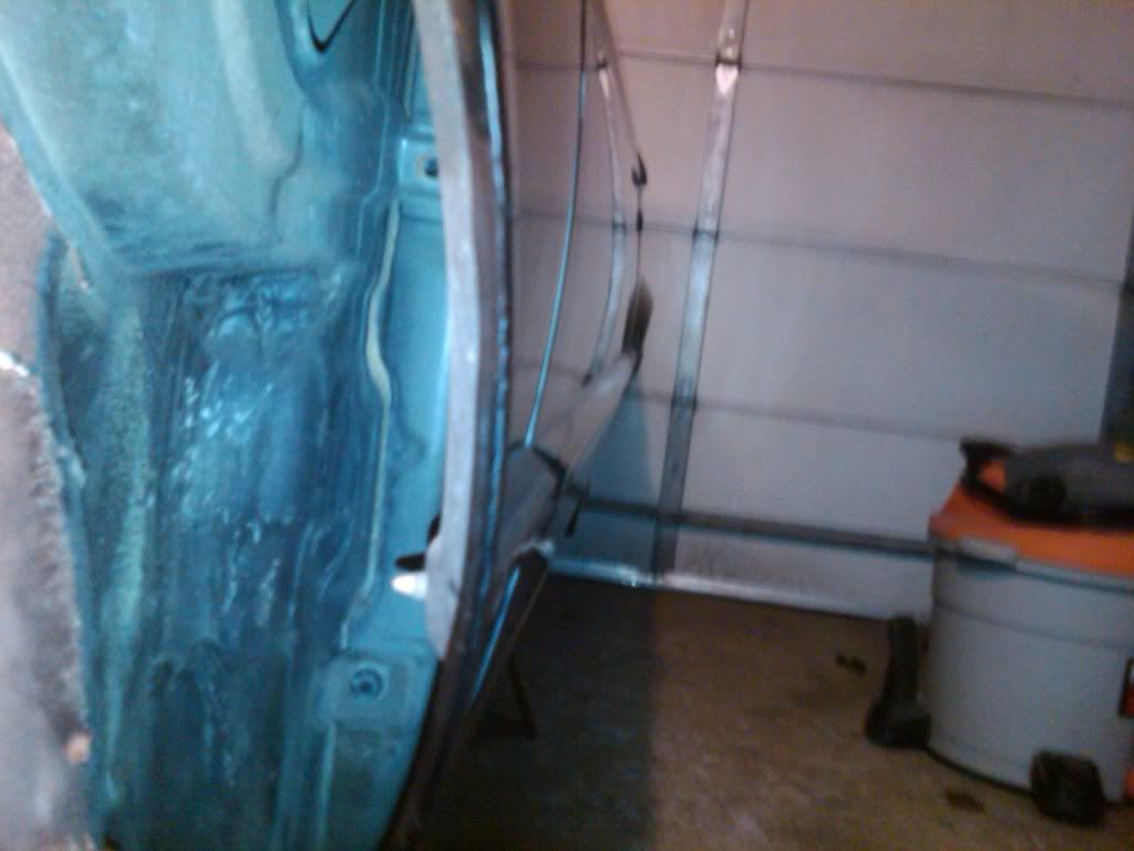

When you get to the bottom of the fender try to ease the pressure off to leave a nice smooth transition into the un-rolled portion, it just looks nice and clean.

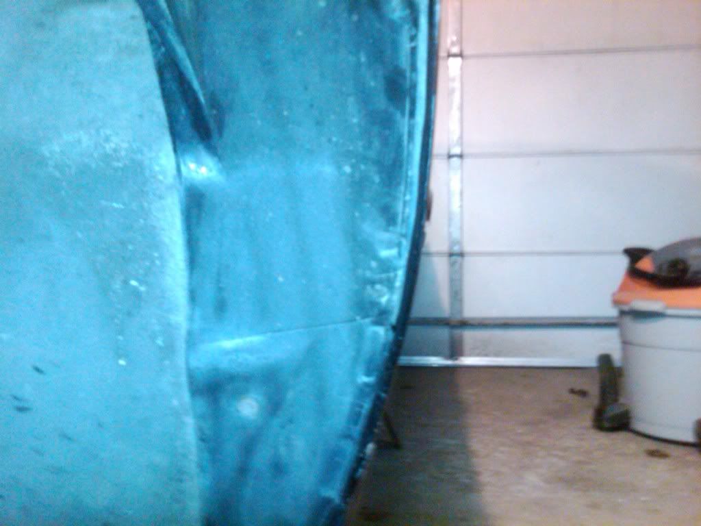

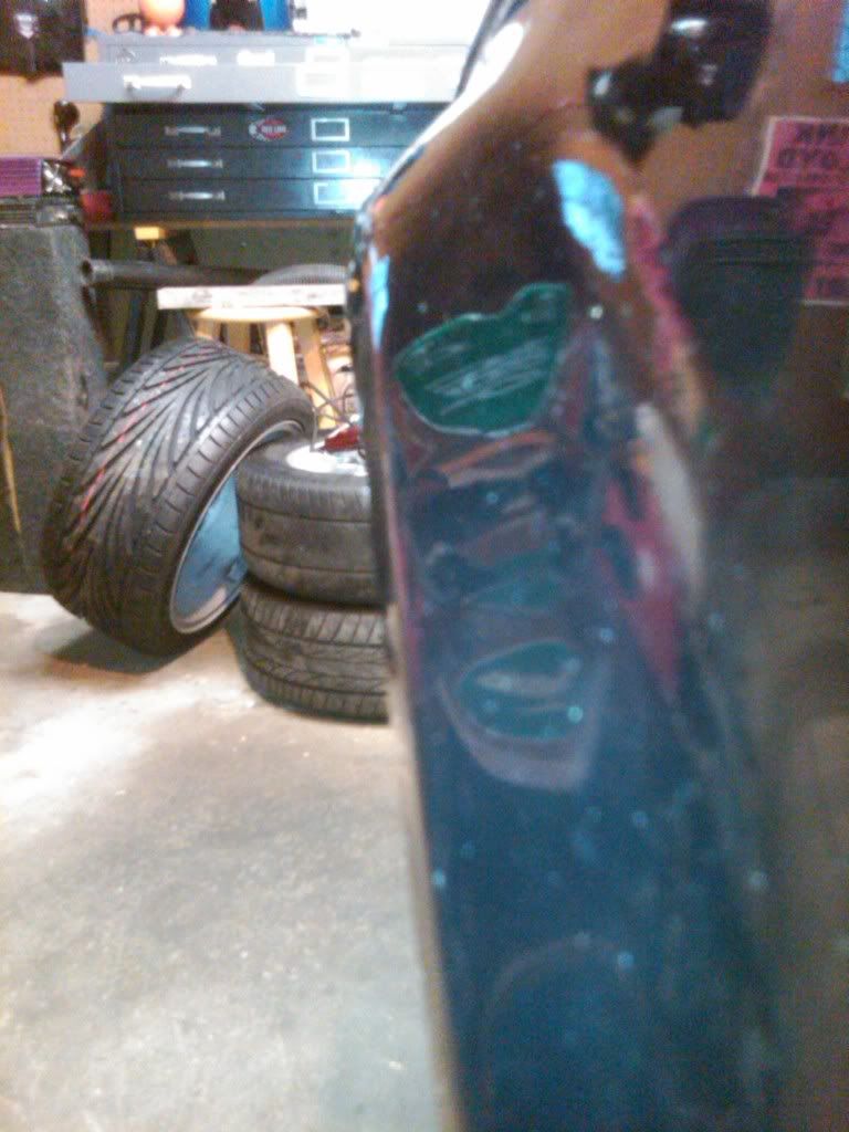

Here is the lip rolled flat and slightly pulled.
And how it looks from the important side.

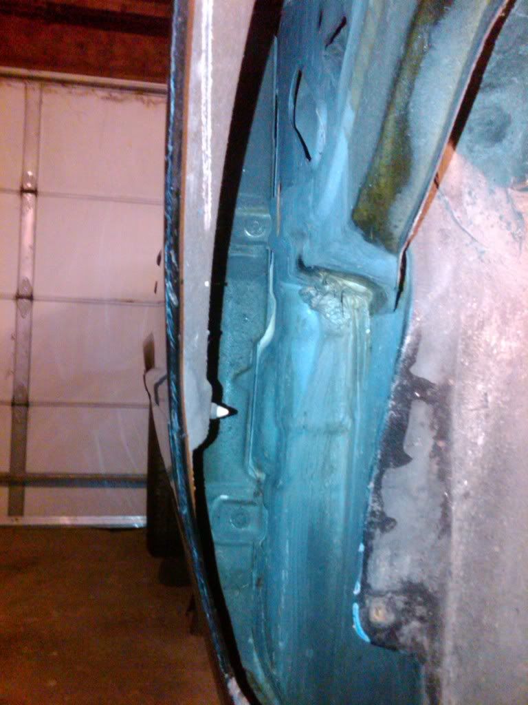

Here is a couple pics from the opposite side front.

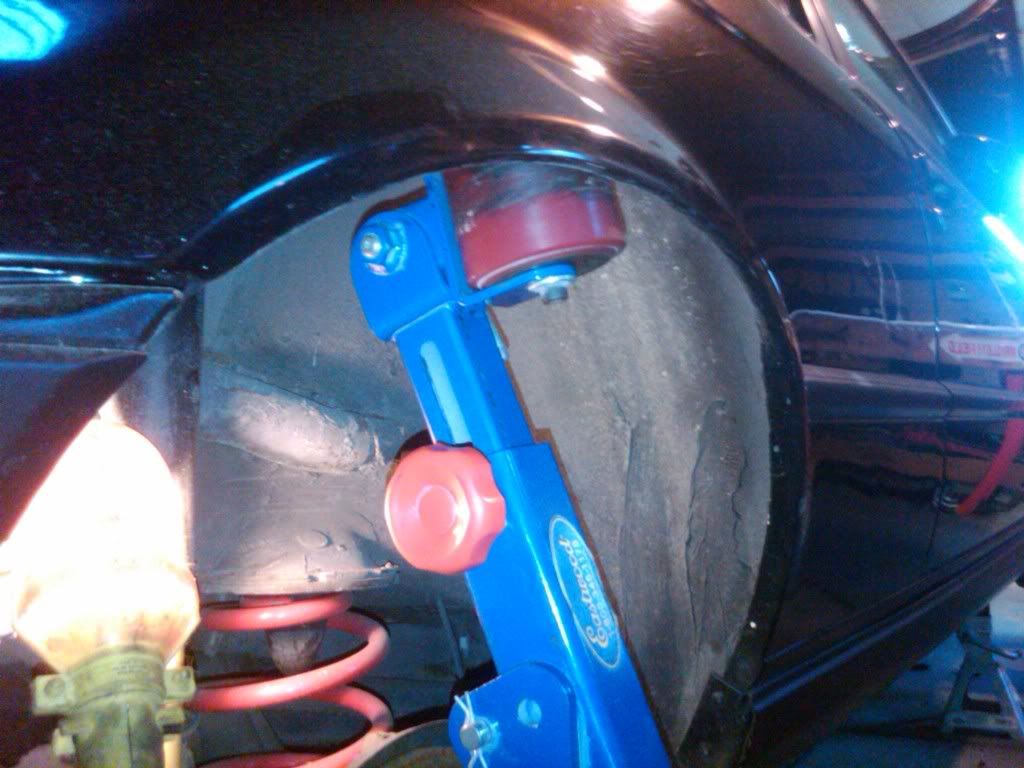

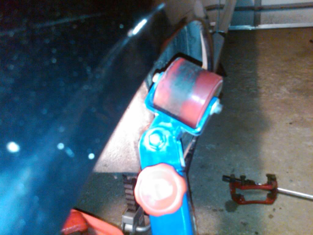

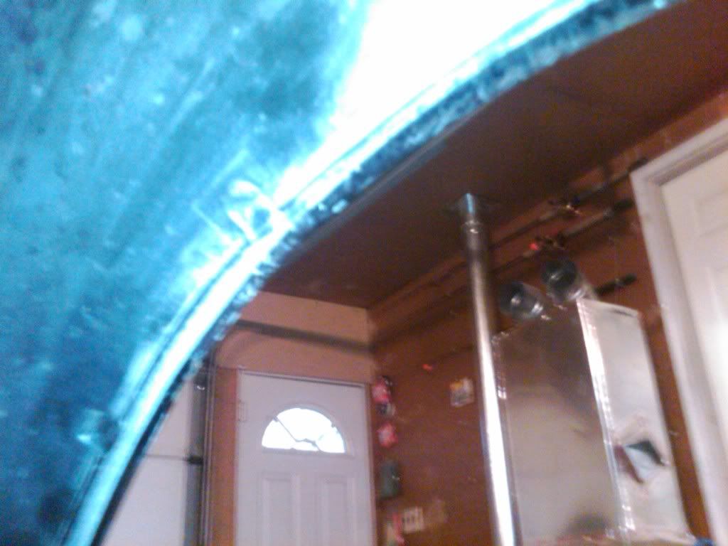

Next was to roll the rear fenders which is a bit different than the fronts. There is no need to remove the rear calipers or brackets on the rear as the roller clears without problem. The rear fender lips are much thicker and wider than the fronts which makes it more difficult to get a good roll. There is a partial roll from the factory in the rear, so I used that as a guide for what I rolled. It's really hard to roll past the factory roll because the lip material gets so thick, but there is no need to roll down the sides as it will not increase any wheel/tire clearance.
I used the same 3 lug mounting process as the fronts.
Here is the rolling angle I started with.

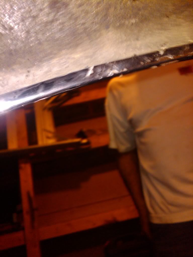

I rolled the rear lips flat like the fronts, and put a slight pull in to match the fronts also. Below are a few shots of each pass with the roller to get there.
