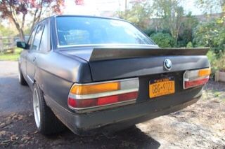

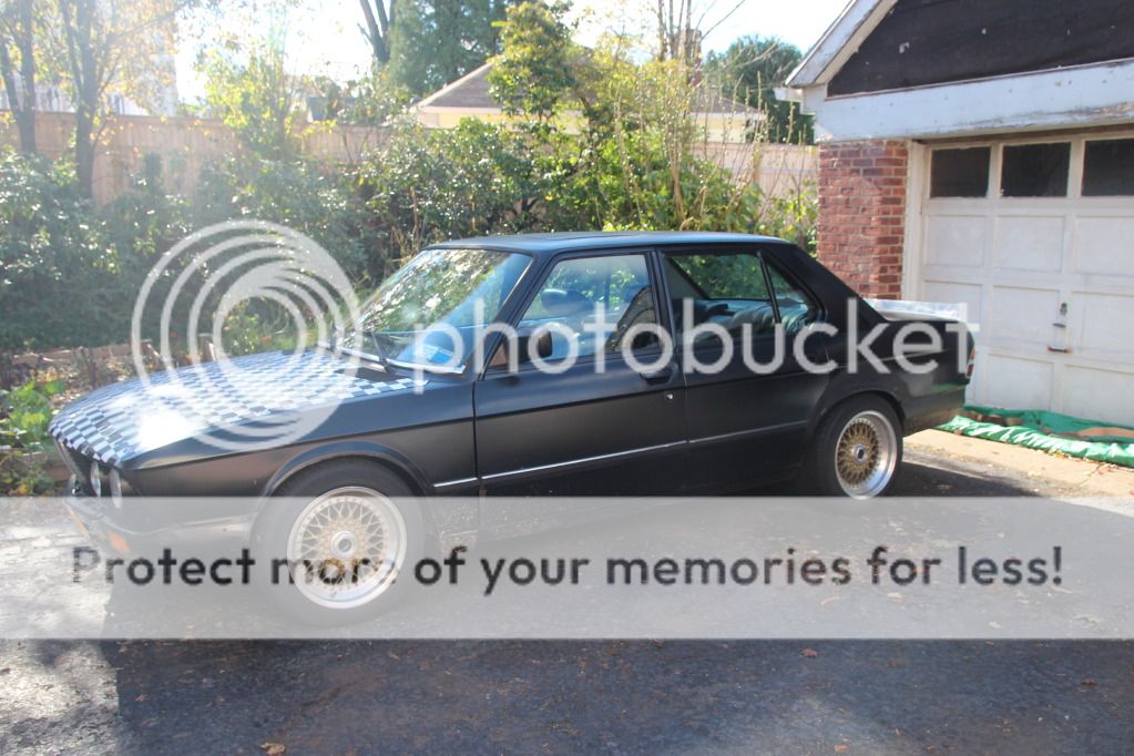

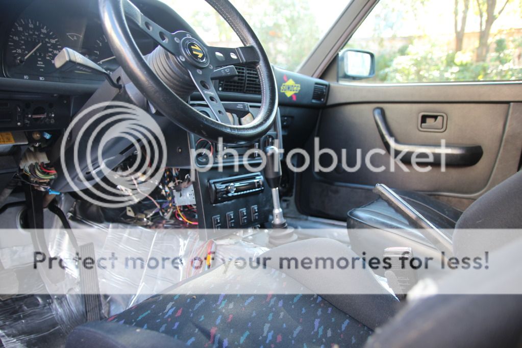

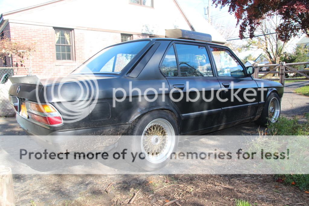

Hey whats up fellas im new to the bimmer world i recently grabbed this bad boy and I have a question about installing VDO gauges.
Im having trouble finding a legit place for oil pressure sending unit on the m30b34 any ideas? I wasnt really looking to use the drain plug method any other ideas??

Yeah, the oil filter housing will work fine. Nice e28, thing looks raw.
