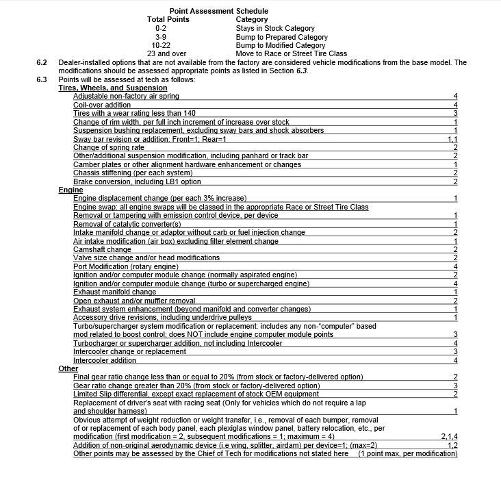

Awesome! Our first points event is at Blackhawk on May 3rd. I have a problem I need to fix too, I wish this damn weather would clear up so I could test drive the car...Have you classed your car yet? That's very important if you want to be competitive, and I was way off my first time around. Post up some pics of the car and all your mods and I'll help you out.

Are you going to run those R-comps?
How wide are the wheels? What dia?
What suspension upgrades?
Bigger sway bars?
Upgraded brakes (bbk)?
Engine work?
Just from the pics you'll be taking points for aero and weight reduction. I think your going to end up in a race class TBH, depends on your answers to the above questions. I'll go through the GCR later this weekend and see what else I can dig up. I need to anyway to get my car prepped.

Suspension includes Bilstein Sport strut inserts in the front with Ground Control camber plates and coilover conversion. The rear end utilizes Bilstein Sport shocks with JBRacing Solid upper shock mounts and height adjusters. Swaybars are UUC Swaybarbarian 22mm front and 19mm rear adjustable. Eibach race springs.
4 XXR 527 wheels 17x9.75 flat black
2 XXR 527 wheels 17x8.25 flat black
4 Hoosier Koni race slicks 275/40/17
2 Hoosier Koni race slicks 225/45/17
Engine is stockish. VACmotorsports race valve springs (dual spring design, good for 11,000 rpm bursts) factory size valves, CatCams 287 cam and adjustable cam sprocket and 19lbs injectors running on megasqirt.
Looks good on paper though not yet track ready.
Oh the brakes are stock with hawk hp+ pads and the Mini Cooper wheels are 205/65/16 on Bridgestone street tires that probably aren't ideal for track purposes.

Here is our points breakdown:
Just at a glance your pushing 23+ points so your going to be in a Race or Street Tire class.
