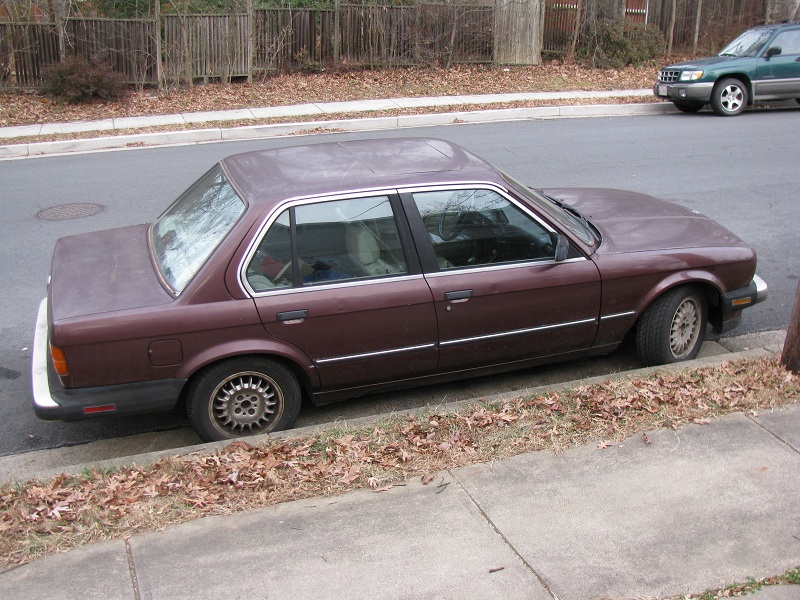

She's an '87 325, which came from the factory with the M20B27 engine that is setup for economy. Useful mods include a 3.25 LSD rear, Koni Yellow dampers with H&R Sport springs, a pair of ratty sport seats, and 7 year old Falken Azeni RT215s. The A/C was removed in a very half-assed manner; I plan on reinstalling it and possibly converting to R134a in the process. Once the Falkens are very near death, I'm shooting to get XXR 513s in either 15x8 or 16x8, and shod them in some decent sticky rubber, then go for Hankook Ice Bears or Dunlop Graspics in preparation for the winter.
Annoying problems that needed fixing when purchased: coolant leaks, rear windows won't roll down, driver's side rear inner door handle is non-functional, the driveshaft center support bearing is dying, and the antenna popped off.
This car hit Summit Point to drift within a week of acquisition, and it will see me driving for the rest of the events in the near future.
That's how she looked when I first got her on the street in August 2009.

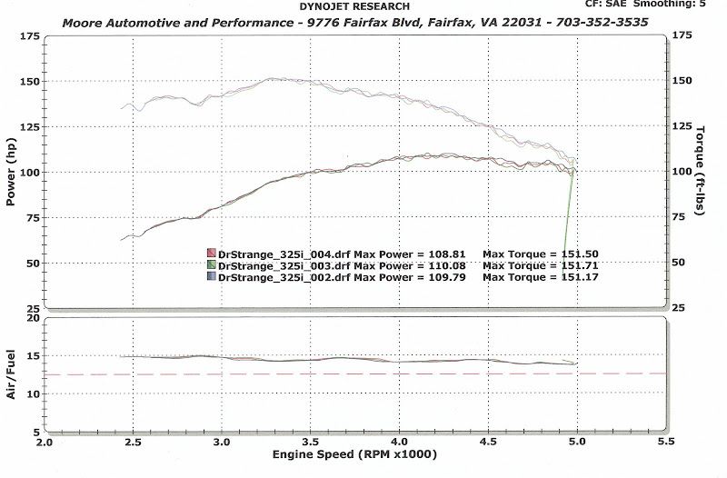

In December, the car put down these numbers with a leak from one of the headers and with no radiator fan, so she'd overheat somewhat at the end of the 2nd and 3rd dyno runs. I was still pretty happy with the car despite it having this issue where it'd die at random.

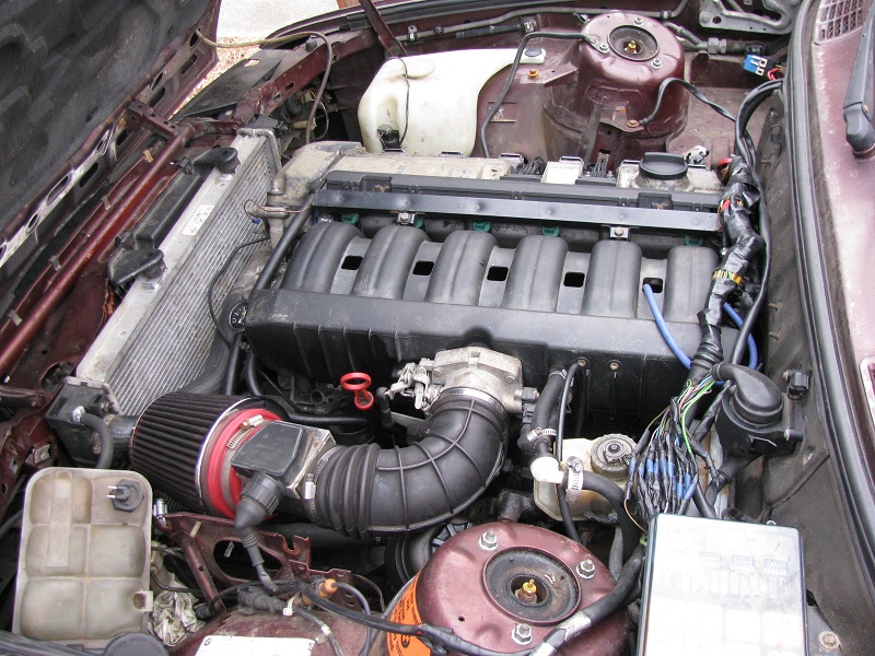

My back got messed up, and I wasn't really able to do much; the car sat for months until Yoshi decided he wanted his driveway back; he pretty much did my swap. To say I owe him is a gross understatement. I've been ironing out bugs at a glacial pace. How glacial? I have to do my first oil change since the M50 swap, and I've put a maximum of 280 miles on the car since the swap was completed.
The transmission cross member Yoshi fabbed for my G260:
Final version:
As she sits:

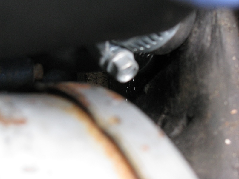

The above is where I thought my lower heater core outlet is leaking; Yoshi thinks otherwise.

- I'm chasing a phantom coolant leak, in that it doesn't seem to be leaking from where I thought it was (heater core lower outlet in engine bay), but the coolant is going somewhere. The oil smells and feels fine...

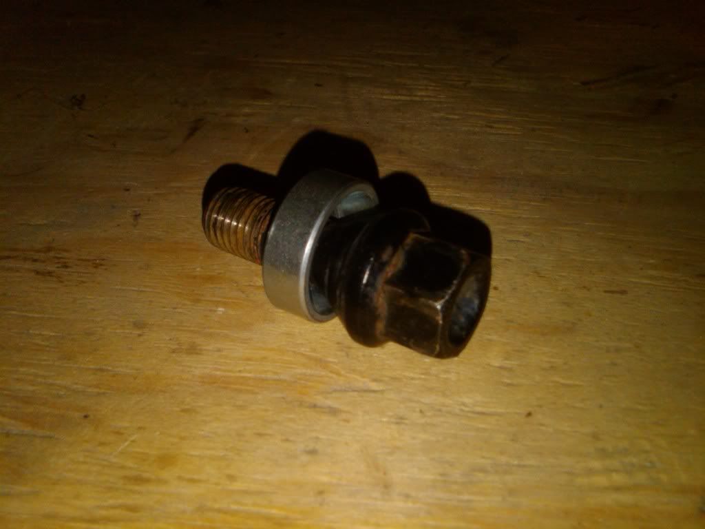

- Wheel stud conversion (have the studs, need to install them).
