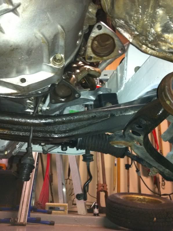

I brought the car to the exhaust shop 2 weeks ago to finally get one put on. I'm running dual 2" off the headers to a dual 2" to single 2.50" Magnaflow (94007) Cat then on to a SLP Resonator and finally to the E39 AC Schnitzer muffler.
The result is a nice growl at idle and through the RPM range that isn't too loud. My only complaint is there's no rasp, which I attribute to the resonator.
As a result, I plan on bringing it back to install a x-pipe, relocate the cat, and remove the resonator. I had dropped off the car and the shop's owner wanted me to leave it for a few days. I told him where I wanted everything, but not exactly. My fault not his. Although for $200 out the door for tubing and labor I can't exactly complain. He had a lot of fun clearing the subframe coming off of the shorty headers. ;)
Pics:
Back from the Shop
I like it sort of flush
We used new factory hangers that were cut in half and rewelded to accommodate the larger width of the muffler.
The exhaust guy (Frank) cut off all the pipeing and welded his own on to clear the diff.
In addition to being in the "not so ideal" location it's going to scrape EVERYWHERE
