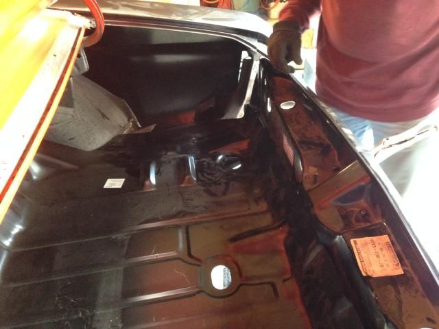

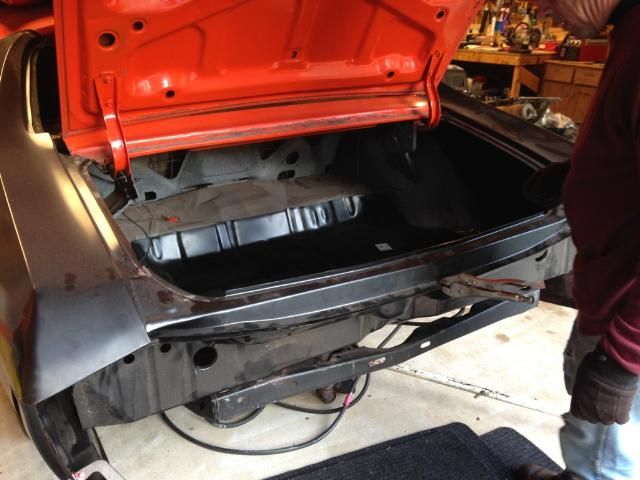

Post by M20_fever » Wed Oct 16, 2013 3:18 pm
Getting the ass end mocked up. Turns out the trunk pan I bought isn't a full pan...you can see the gap between the fenders and the edge of the pan on both sides...ugh. Doesn't look like you can buy just that part either, so my options are either buy another full pan ($$$) or Fab filler panels and weld them in which is probably what's going to happen.

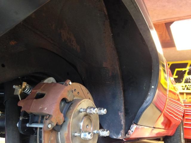

New outer wheel wells

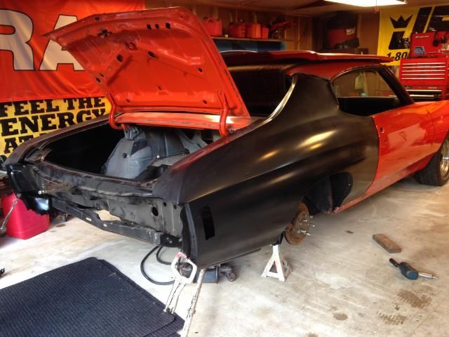

Re: Project Phoenix - A Chevelle rises from the ashes
Post by M20_fever » Fri Oct 25, 2013 3:21 am
coming along, mostly tacked together, still some massaging to do.
Post by Yoshi » Fri Oct 25, 2013 11:51 am
tack weld and seam sealer?
Post by M20_fever » Sat Oct 26, 2013 8:23 am
huh? It will all be full welded once everything is lined up perfect.
Post by Yoshi » Sat Oct 26, 2013 11:38 am
I was wondering. Some guys seam seal. Full welding takes out the give. I dunno much about that level of body work lol.
Post by M20_fever » Sat Oct 26, 2013 4:07 pm
yeah this extent of bodywork is new to me too. Most of what you see will be fully welded or leaded in, the rest will be stitch welded with some seam sealer.
