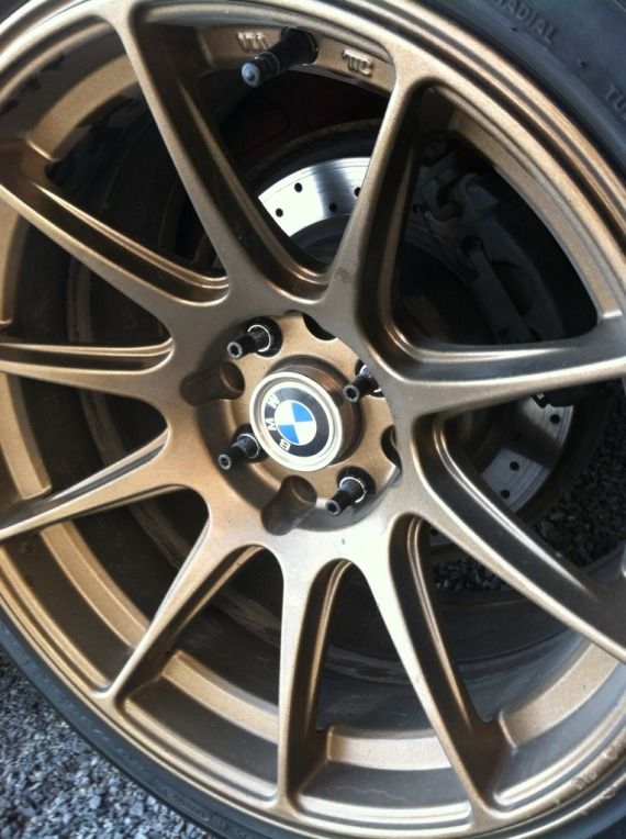

Postby MrEricT » Mon Mar 18, 2013 11:35 pm
Some pics from over the last few months.......

Postby MrEricT » Tue Mar 19, 2013 10:20 am
Thanks fellas!! I got the wheels off Mike. They are the set he had each wheel a different color. I gave them a quick coat of bronze and tossed them on. I contacted motorsport hardware for my studs and nuts. Super quick shipping, great price, and a high quality product. You guys wanting a stud conversion....... Get at him. Hes got threads on the tech and r3v. They are xxr wheels and i figured out a way to get stock bottle cap centers to work. Tires are 205/50-16 hankook all weather performance jobbies.
Re: MrEricT's e30 project thread......... indeed
Postby M20_fever » Tue Mar 19, 2013 12:42 pm
pretty slick with the center caps. I kinda like that color better than the gold on mine. Do you rub in the rear at all with this tires? I'm running 245/35/16 out back and it rubs a bit at full compression. I Also have the same studs from Motorsport. The only caution I gibe is don't get his studs that are not threaded all the way to the hub, especially with the XXRs. The mounting area of the XXR is too thin and the lugs will lock onto the studs when torqued. I had to order a second set of full thread studs and have been fine since then.

Postby MrEricT » Tue Mar 19, 2013 12:55 pm
Ive been hammering on my wheel wells for clearance so i can keep it low. I would love to fit something a little wider, but i dunno if its gonna happen with et0 unless i go yoshi on my wheel wells with a hacksaw.

Postby Yoshi » Tue Mar 19, 2013 1:08 pm
lol I only do that in the rear.
I run 215/40/17 in the front. I had to go hammer time on a lot to get it to fit. But I also run angle mods you probably don't.

Postby MrEricT » Tue Mar 19, 2013 1:23 pm
Hammer time indeed. I still just barely rub in the rear when i hit a hard enough compression or hard cornering. I need a little more massaging in the rear with the mini sledge.

Postby M20_fever » Tue Mar 19, 2013 3:16 pm
I had to cut the inner well back 50% and cut the lip off to pull it enough to get the 245s on the rear. Still rub a tiny bit under hard cornering. et0 is a bitch.
