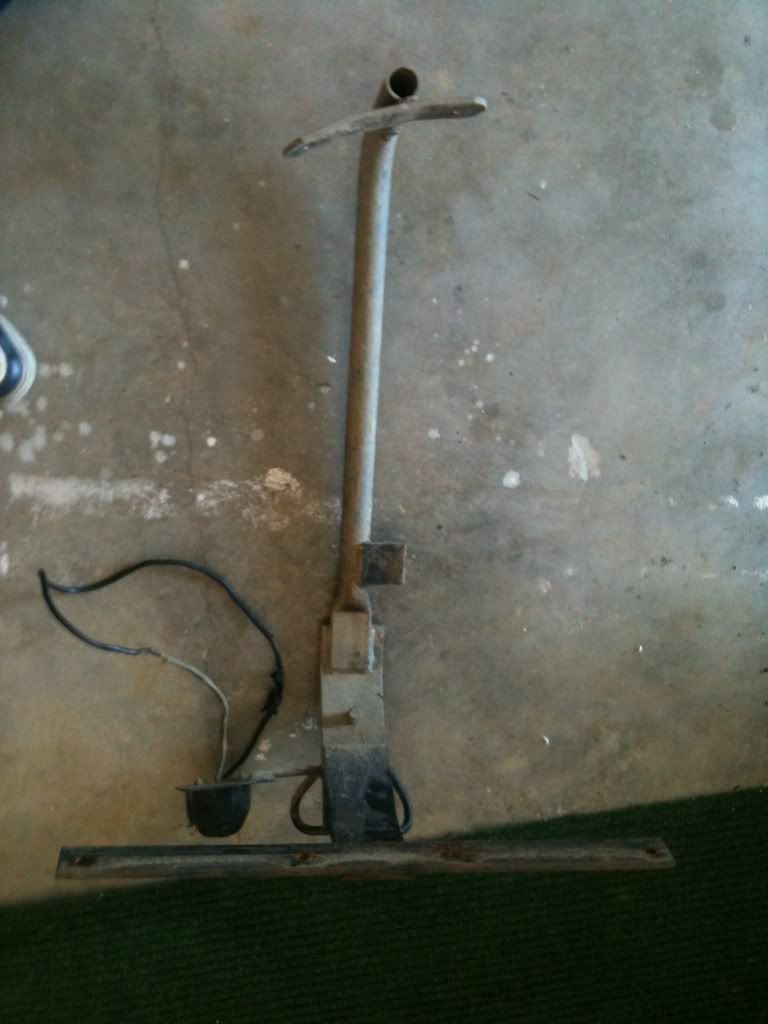

So here was the first day! i owned the car! Started buy pulling off the tow bar and pulling back all the tape around the loome to find where the towbar loome was joined into the cars loome so that i could pull the loome out properly.

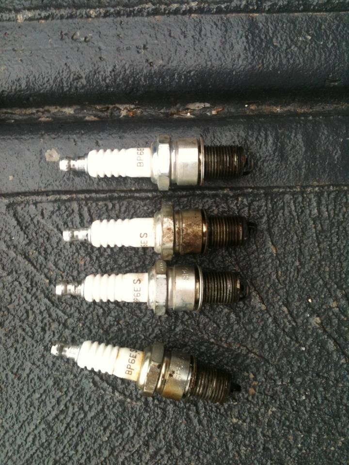

Then came time to change the plugs WTF????? Seriously has this car never been serviced?

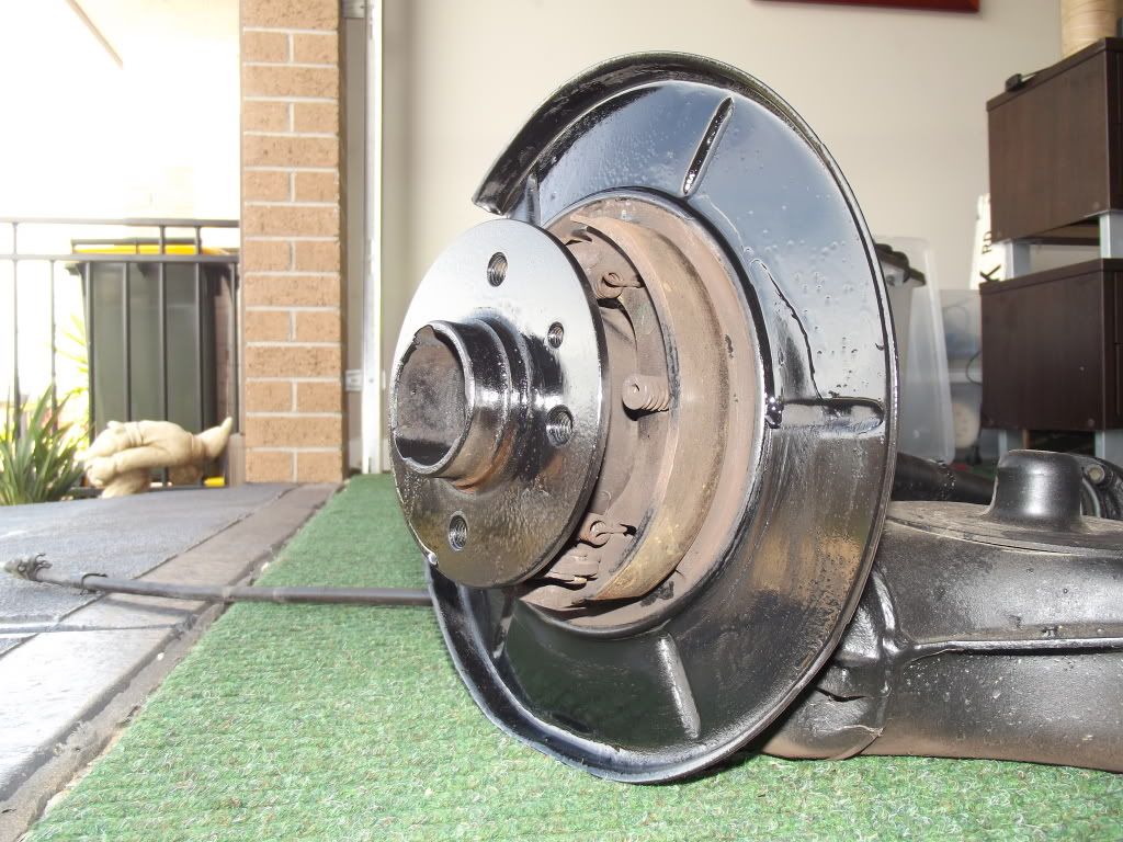

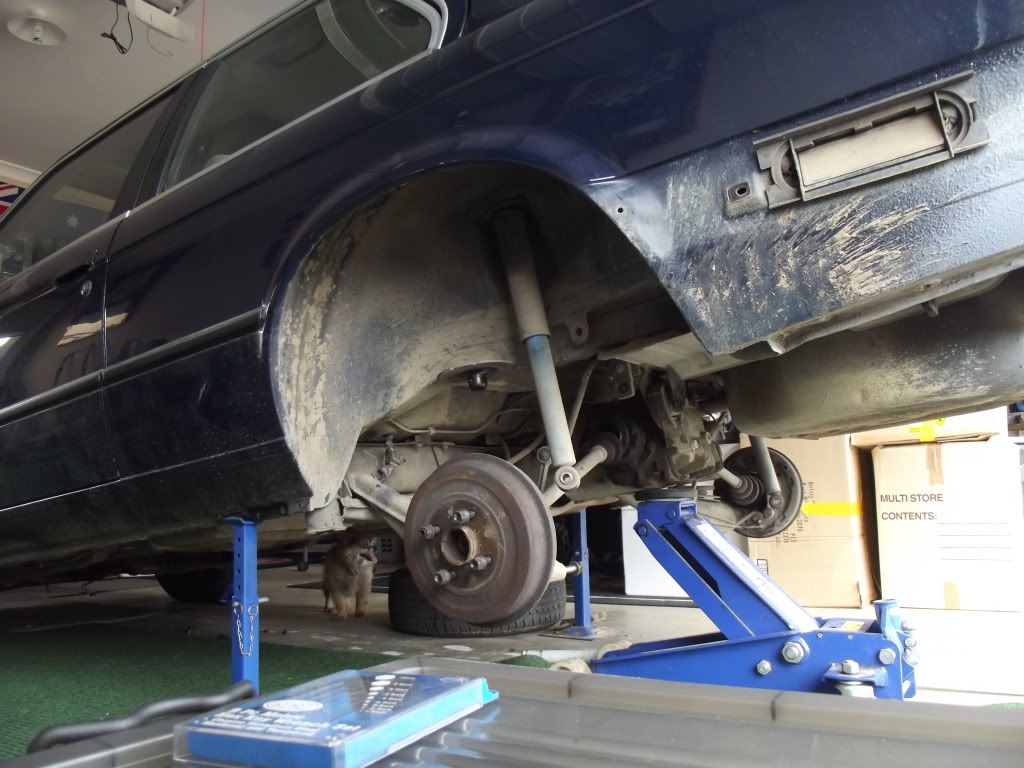

The car seemed to run alot nicer now! and was going good untill i had to pick my sisterinlaw from the airport and i lost my brakes!!! that was scary! I got it home (10 min drive) using my hand brake and down gearing lol It ended up that the rear wheel cylinder was leaking that bad that i had no brake fluid left lol! the next day i went out and got a discbrake conversion for the ass
As a mate and i got under the car to have a look at the brake broblem we noticed some other problems lol!!!! Every bush was destroyed! sway bar links where stuffed, drive shaft boots where split and everything else seemed to be stuffed or almost stuffed ;) Fun times! So i started ordering parts from everywhere. While i waited for parts to get delivered i started working on some other problems.

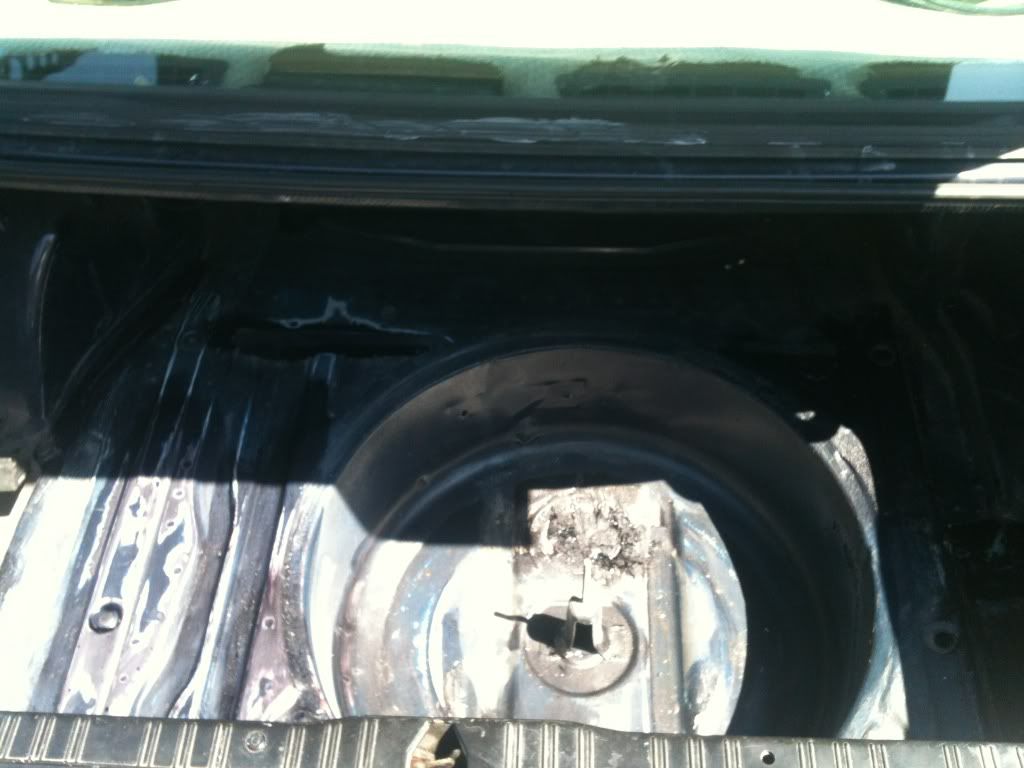

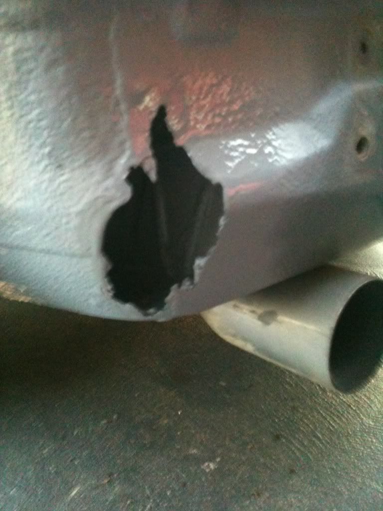

There was a small bit of rust in the back of the car so i got my wire wheel started to clean it up! the little rust ended up being half decent so i now need to get a bit to weld in, I covered up the area with some eatch primer to try stop feather rust.

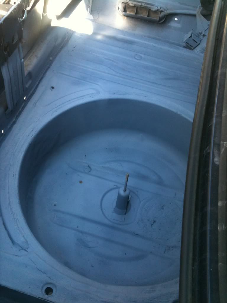

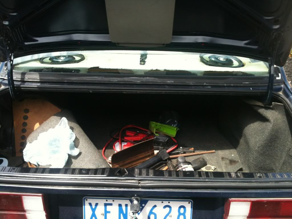

Next bit was to tear the boot appart it was stained and full of shit from the old owner lol! here we go.
This is the boot as it was.
All stripped out and sandded
And all primered up waiting to be painted when i fix the rust hole.

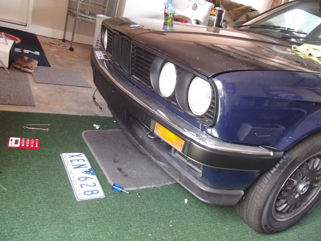

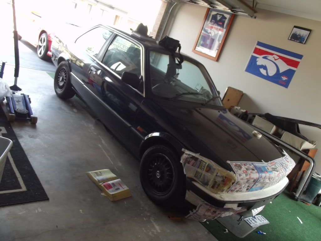

Next thing i did was paint the headlight surrounds and grille black (Painted at the bottom old at the top)
While i was at it i got some other headlights and cleaned them up they look brand new
All put together

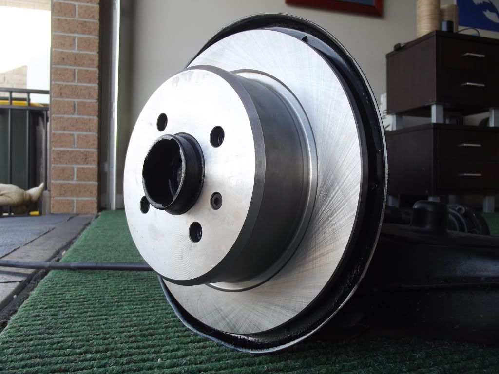

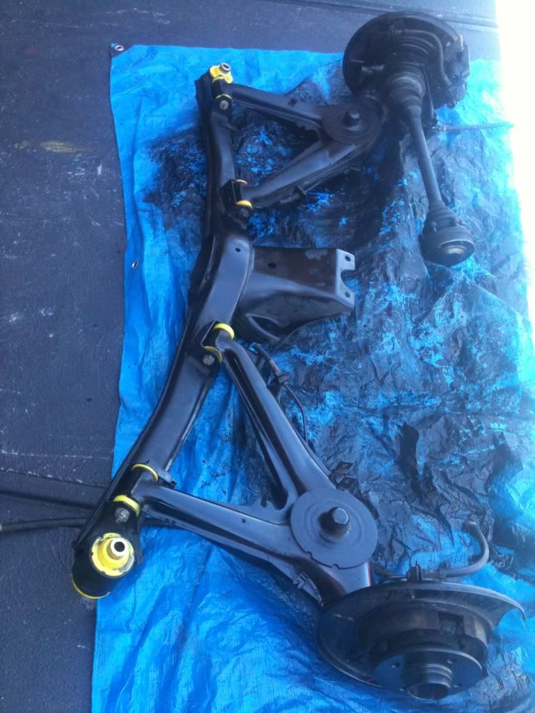

I started to get ready to do the rear disc brake conversion, i painted up all the rear controllarms and subframe

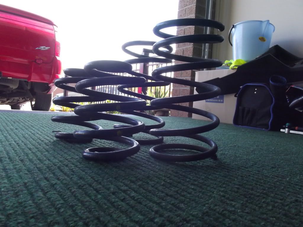

So i got started on the front springs and shocks as i waited for my bush kit to come!

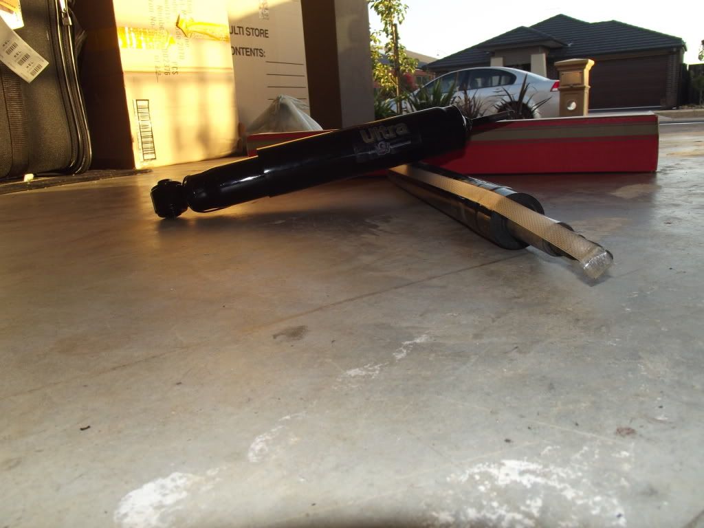

Front KYB shocks and BAV auto springs in the front.

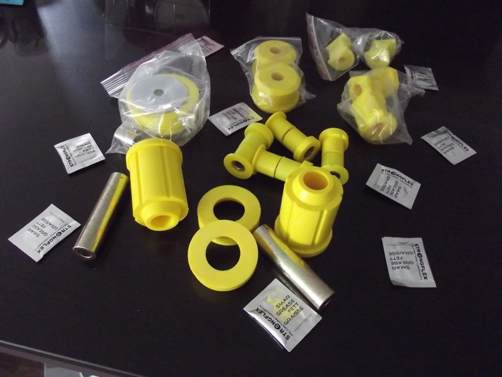

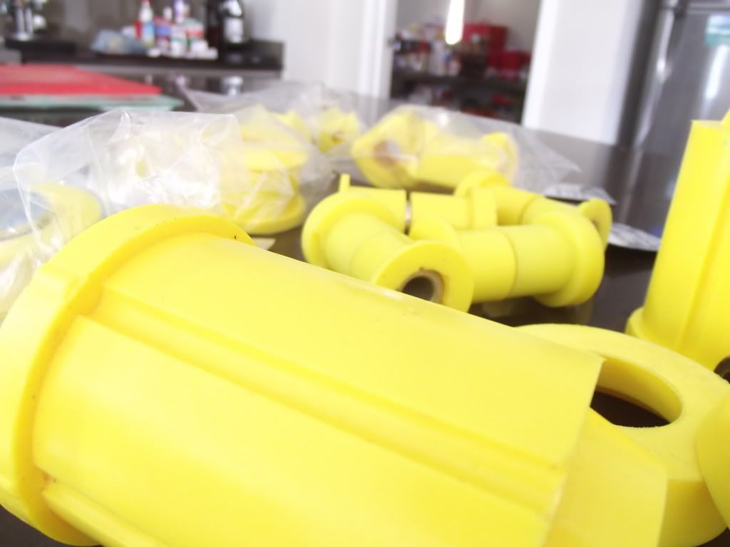

Then these bad boys rocked up!!!!!! 90shA ratted bushes! these are so ****ing stiff its not funny.

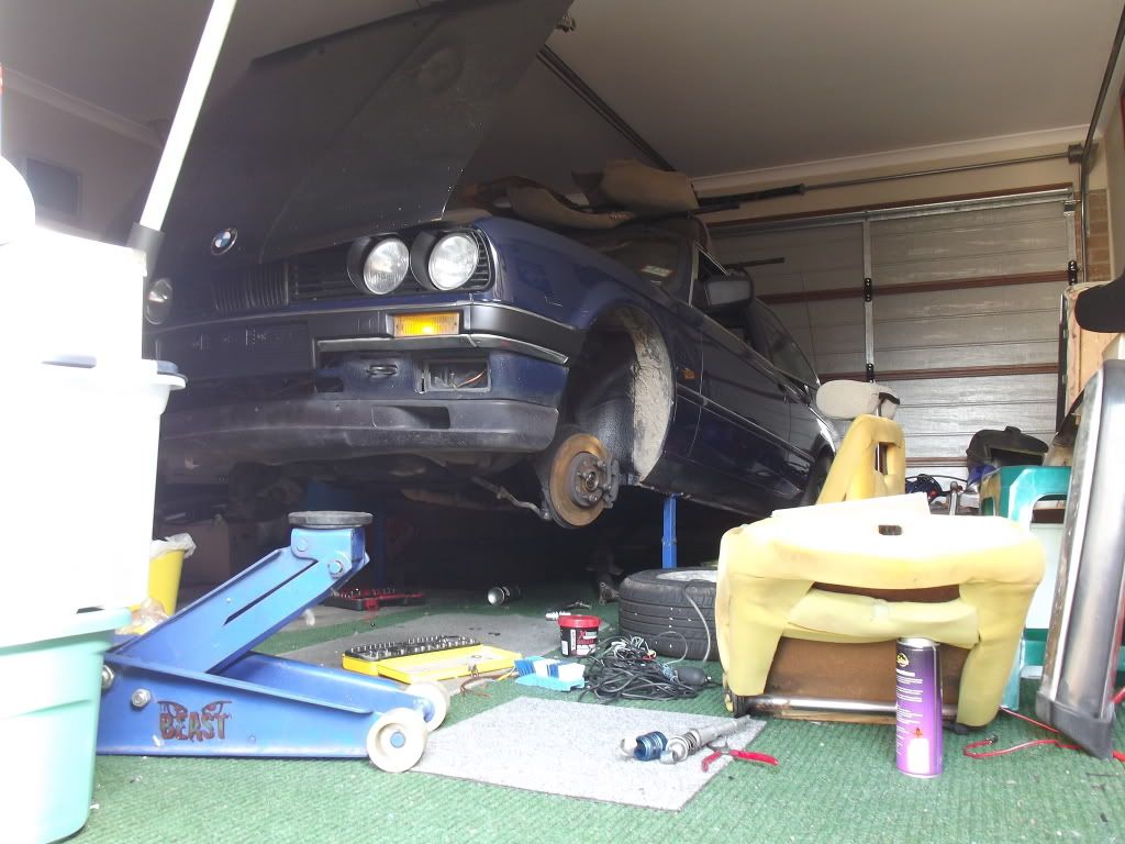

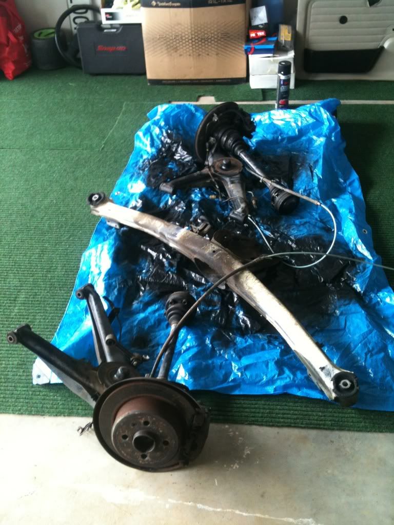

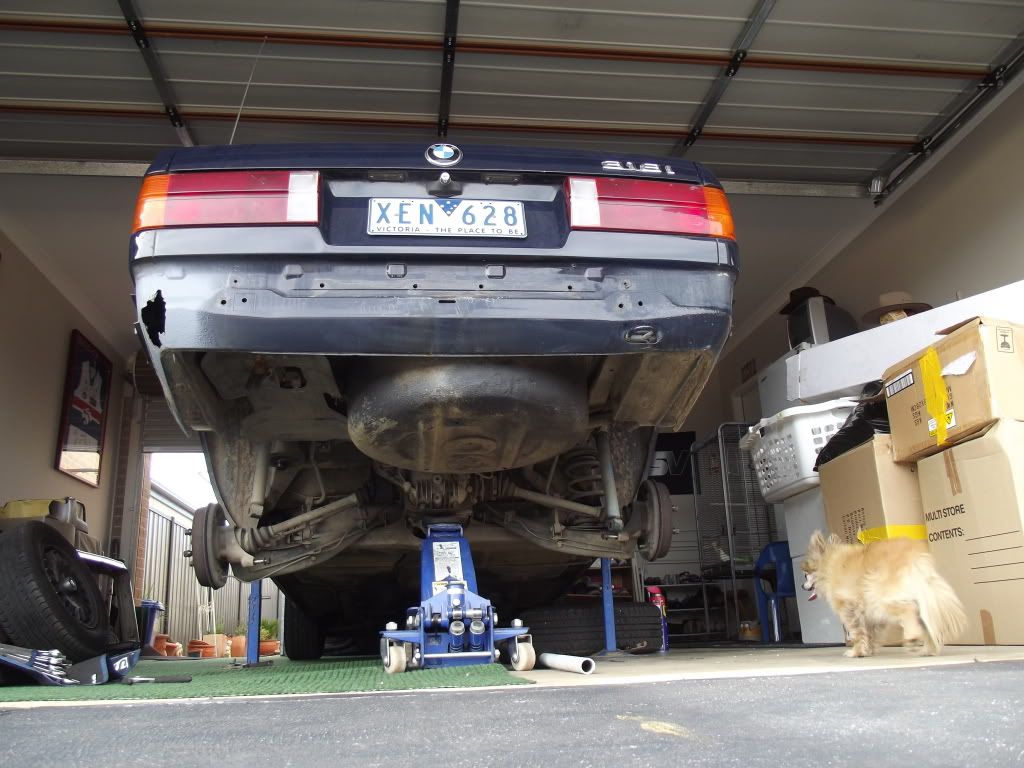

Time to start on the back! I took appart the whole back of the car! Springs and shocks came out, Subframe and controll arms came out and the diff came out as well
The new discbrake subframe and controll arms painted with the new bushes in!

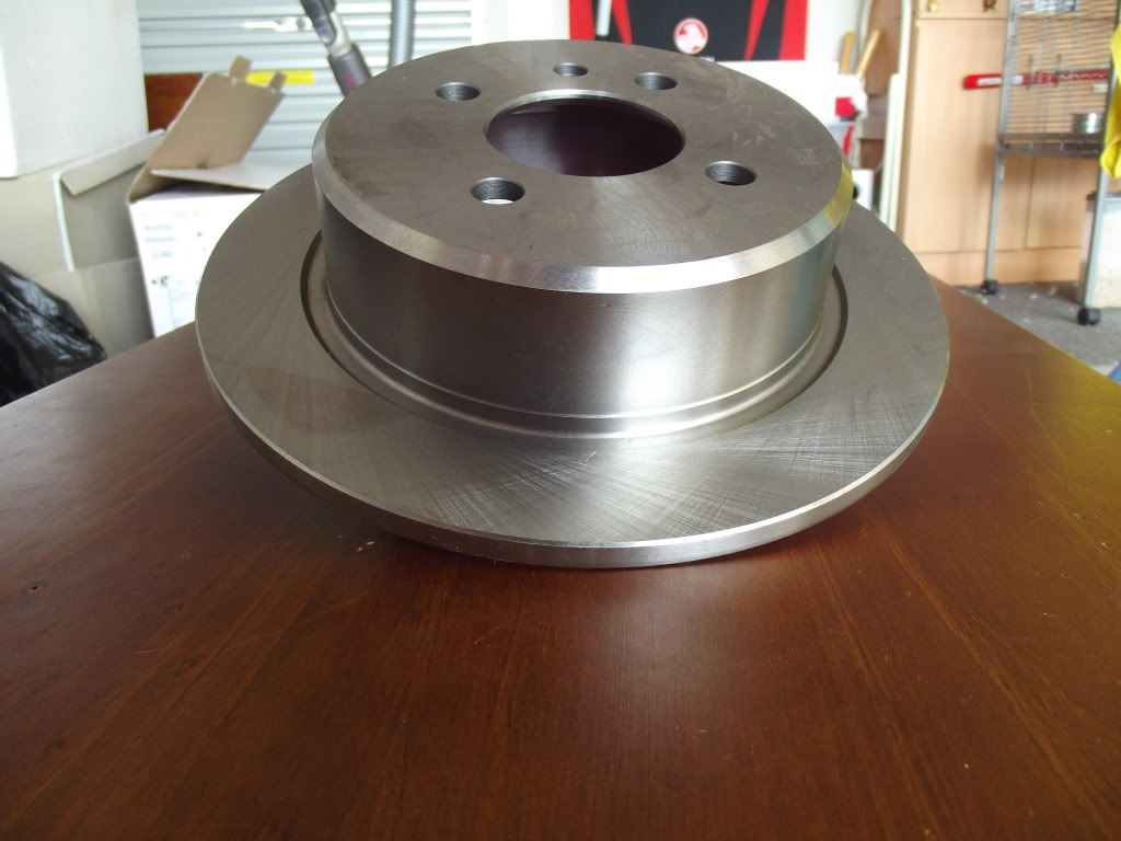

And TA DAAAA!!!! New bushes, disc brake conversion, new discs and pads, new gabrial ulra shocks, new bav springs. New black bonnet as well.

Old controllarm bush on the left VS new solid bush on the right
New bush on
This is how he sits atm

We started to fiber glass the hole in the back! we wire wheeled it back hard and then put on some rust converter then layed down the fiberglass! Tommorrow i will start to clean it up and do some bog work!
Next i mounted up my start button! i realy have no need for this but its kind of cool in an old school car i think!
And just a random pic of my storage area aka my car :(
More work on the old rust hole
From this
To this :)
Just need some paint!

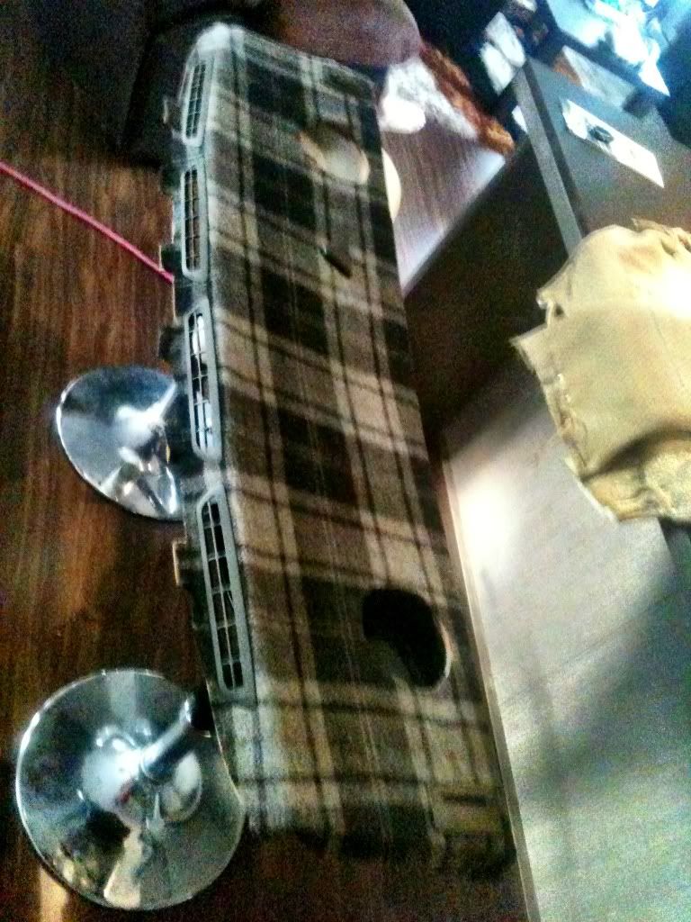

So we cut the parcelshelf material out it still needs to be stuck down its just sitting on it at the moment! We also cut out and sowed all of the seats i just need some foam to fix a few bits and that should be all done!

so i hope to have this car back off of the jack stands within 2 weeks and in to roady asap!

I got my swaybar in today What a ****ing struggle! The front swaybar D bush are so stiff (they are a 90sha rated) they would not squash down to let the swaybar D bracket fit into the slot then bolt up as soon as you want to turn the bracket so you can line the hole up it would pop out so finally buy using a hammer, screwdriver and a 2 ton bottle jack and my 2.8 ton snap on trolley jack they are in ;)
also got the parcel shelf done and the seats are almost done just need to re assemble the seats again and it's almost rwc and rego time :)
Here is the parcel shelf
And the seats all done just need to put them on

M20_fever wrote:Great work, love the parcel shelf. Did you install that front valance? I really like it with the euro bumpers.
Thanks mate and yeah its a straight swap over it has a bit of a gap as the plastic bars must be thicker then the euro bars but i think it gives it a bit of a face lift and looks a bit nicer then the old style!

I was just looking through you pics again and noticed the way your grille is totally flush with your fenders and hood. Looks really nice. Did you shim it out or something? Cuz mine definitely sits back farther.
Podge30
Posts: 21
Joined: Wed May 23, 2012 7:38 am
MY E30 build
Postby Podge30 » Fri May 25, 2012 2:13 am
AustinR wrote:I was just looking through you pics again and noticed the way your grille is totally flush with your fenders and hood. Looks really nice. Did you shim it out or something? Cuz mine definitely sits back farther.
Lol I just slapped the clips on the top and the screws in the bottom. So maybe I'm just lucky?
Re: MY E30 build
Postby AustinR » Fri May 25, 2012 2:24 am
Haha nice. I just went out and looked at my car and mine is closer to yours than I thought. The grille pieces are nice and flush, but the kidneys stick out further than yours. Yours is nice and flush with the hood and mine sticks out more...which I guess is opposite of what I said before. haha. my bad.
I'll have to do some massaging because yours looks like sex.
