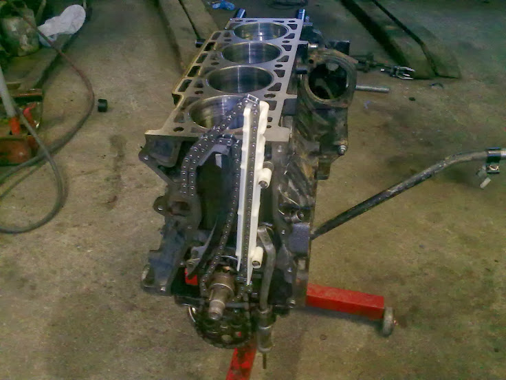

The enginiers finish the job on my block and cylinderhead! Full refurbish!!!
Fire O rings gasket
Crankshaft refurb..
Kolbenschmindt berings and pistons rings
E30 for everyone!

Re: E30 318I m10 turbo & 320i Hellaflus edition
Postby M20_fever » Mon Nov 11, 2013 8:49 pm
why didn't you have the coolant channels welded?
Postby Matte30 » Mon Nov 11, 2013 9:23 pm
M20_fever wrote:why didn't you have the coolant channels welded?
We don't tuch the head! Only just porting and put in a high lift camshaft..
Next time When I made one full forged Engine I will do!

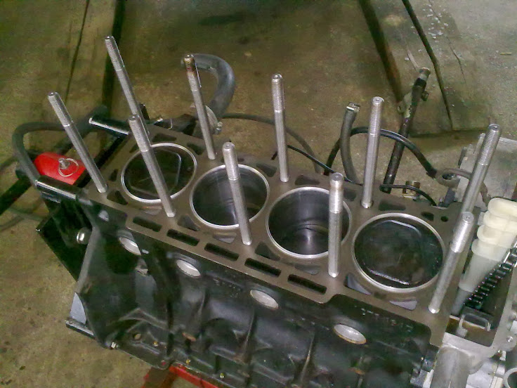

Postby Matte30 » Mon Nov 25, 2013 10:19 pm
I bring couple pictures for you guys!
Postby M20_fever » Tue Nov 26, 2013 1:41 am
Looking good! Did you sleeve the block?
Postby Yoshi » Tue Nov 26, 2013 12:14 pm
looks like just an o ring.
Postby M20_fever » Tue Nov 26, 2013 2:04 pm
those look huge to be o-rings, what's the protrusion on them?
Postby Matte30 » Tue Nov 26, 2013 8:36 pm
M20_fever wrote:Looking good! Did you sleeve the block?
We honing the block only!
Postby Matte30 » Tue Nov 26, 2013 8:37 pm
M20_fever wrote:those look huge to be o-rings, what's the protrusion on them?
I dont know yet mate! I waithing the informations...
Postby Matte30 » Tue Nov 26, 2013 8:42 pm
We have a problem with the head scraw.. we can pull down only 100Nm.. :( So need a new set :?
