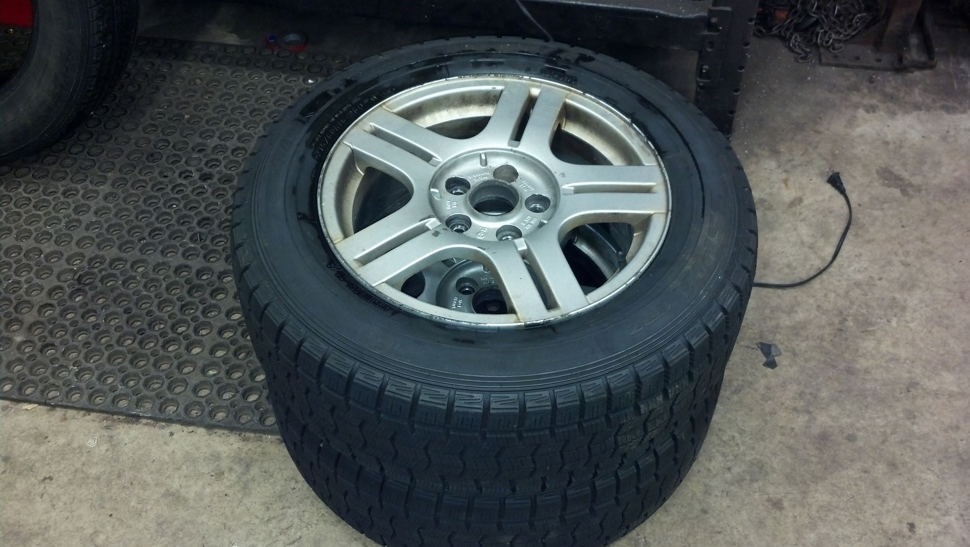

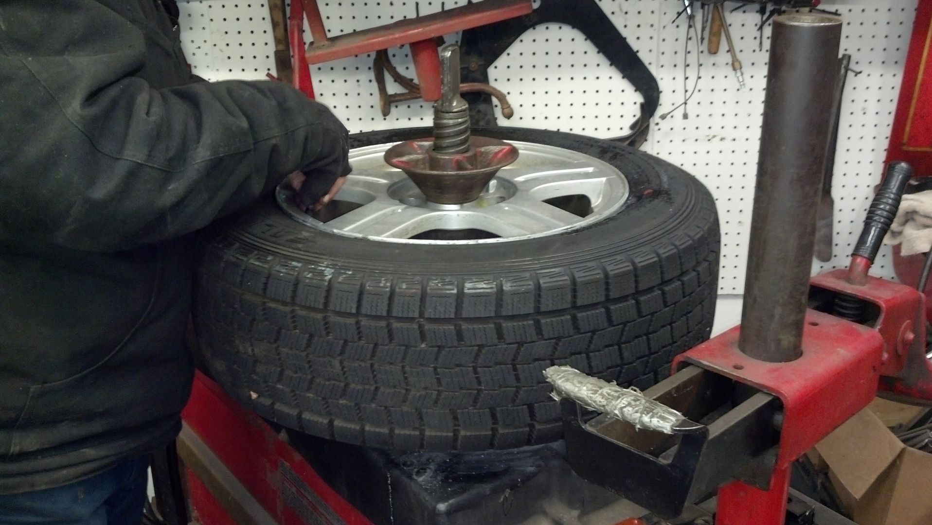

The Passat is good to go! The new tires totally fixed the vibration and she runs straight and true as an arrow. I am still getting a little clicking from that aftermarket CV axle, so I'll be ordering a rebuild kit for the OE CV I pulled out. It should be good for a while as long as I can stand the clicking. The muffler is swiss cheese so its got a nasty drone on the highway, but I can live with it for now. It also has a hard miss when it goes into OD and the rpms drop. Only happens when I put it under just enough load to bog the engine down a bit but not enough to get the trans to kick down. I'm assuming the plugs haven't been changed for a LONG time, so we'll see if a fresh set solves that problem. I haven't topped the trans off yet, that will happen tomorrow after work, but once its warmed up it shifts just fine.
Why was the car vibrating? Because both front wheels were bent, and full of Slime...what a mess.
Bent wheels balanced fine, so I threw them on the rear and they ride fine.
