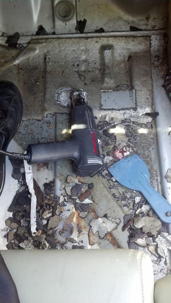

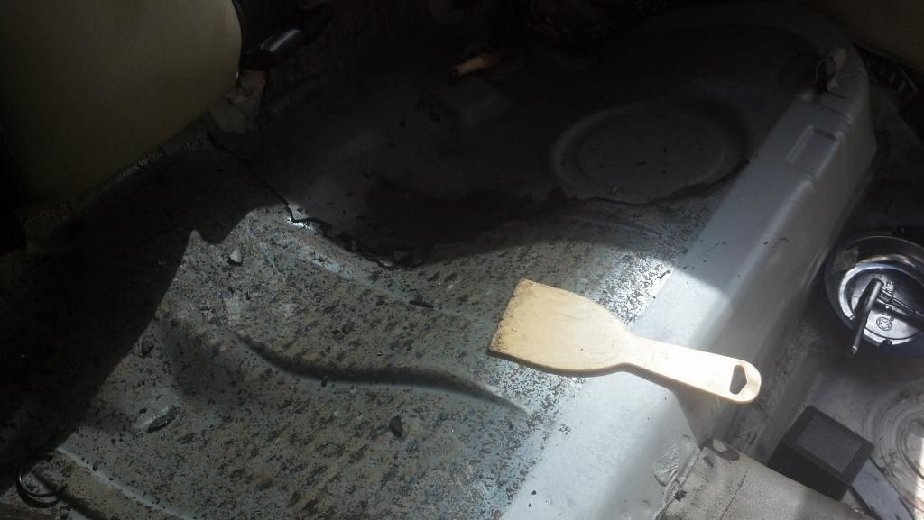

I also pulled all the insulation out of the passenger cabin (trunk insulation will come out soon) in an effort to track down and take care of all the rust.

Pictures of the insulation removal. It was so hot here that most of the insulation came up by hand with a little persuasion from the scraper. The harder sections (front driver/passenger) got some help from the heat gun, and the adhesive wipes up easily after soaking in a little WD-40.
I apologize for the bad pictures... My phone has been through a lot lol

My trunk insulation came out just using my fingers on a 100 degree day. I'm hoping it's the same for the interior...

I don't recall all that insulation weighing more than 2lbs. Wasn't worth it IMO.

Postby blasphemy101 » Fri Sep 05, 2014 3:25 pm
It really hasn't been to bad. Anything that was sitting in direct sunlight came up super easy, because the glue was melting. After going over the bits in the front that were in the shade, I can imagine it would be pretty tough to do in any normal climate.
According to my bathroom scale, all the insulation in my cabin - minus whatever is behind the rear seat back weighed 14 lbs. I definitely wouldn't do it if I didn't have any rust to deal with.
