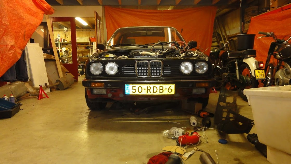

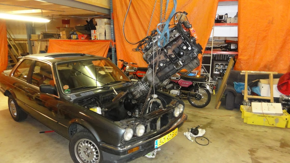

This is the car:
Ready for heart surgery

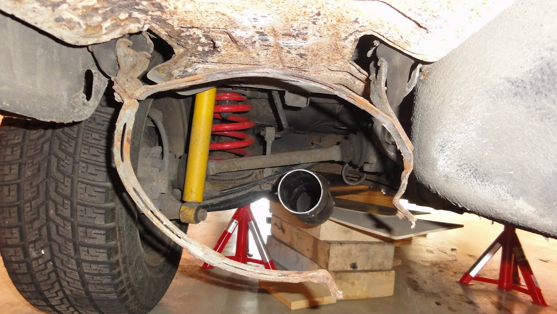

Bummer, rust in the wheel arch
Fitted turboed engine, intercooler has been placed, but not the final position

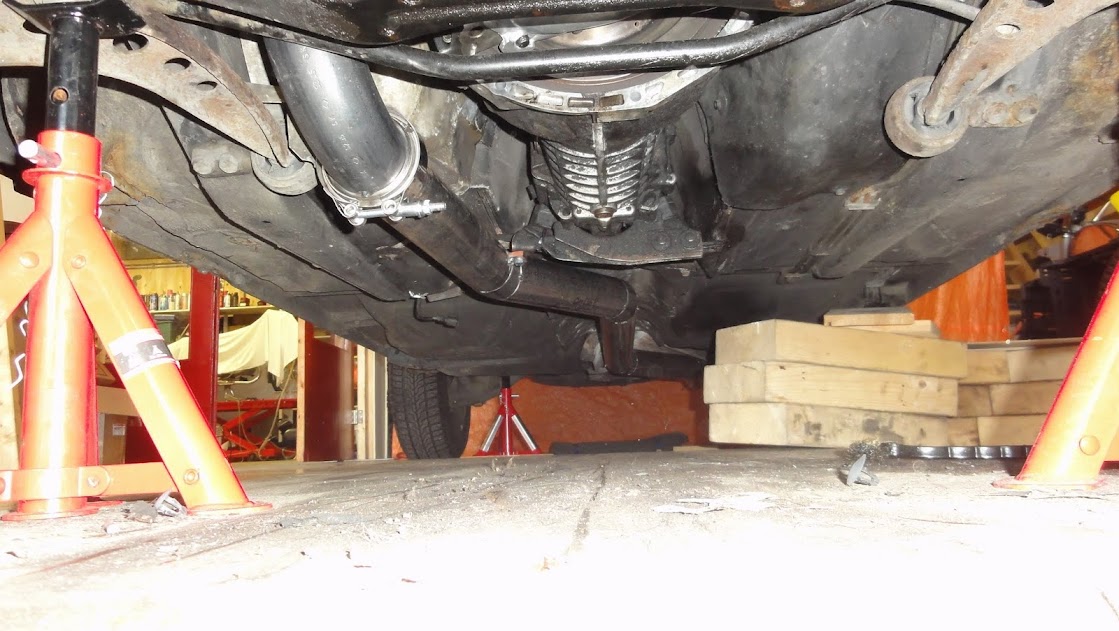

The downpipe, 76mm O.D
The exhaust, 76mm O.D
Brackets
V-band flange
Rear view, exhaust is welded by a friend.
Last piece isnt finished, waiting for my Magnaflow silincer to arrive!.
Finished product, straight through the center, not bad for making it fit with some wooden blocks!

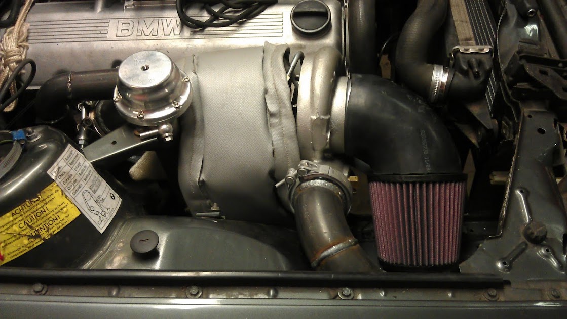

The K&N airfilter, type RU-2520.
Airfilter and charge pipe
Daiper for the turbo to keep the heat in and the big ass elbow for the airfilter.
And when it's painted, nice and stealth
