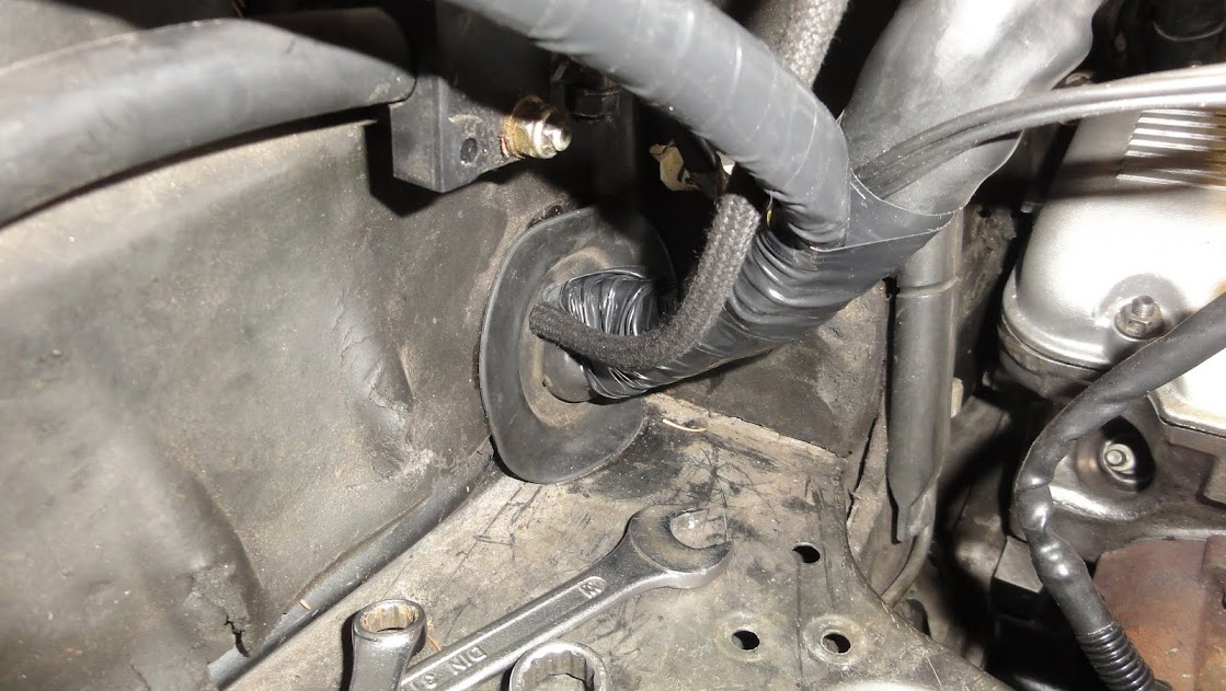

Lambda sensor, cable is fed through the rubber gromet under the fuse box.

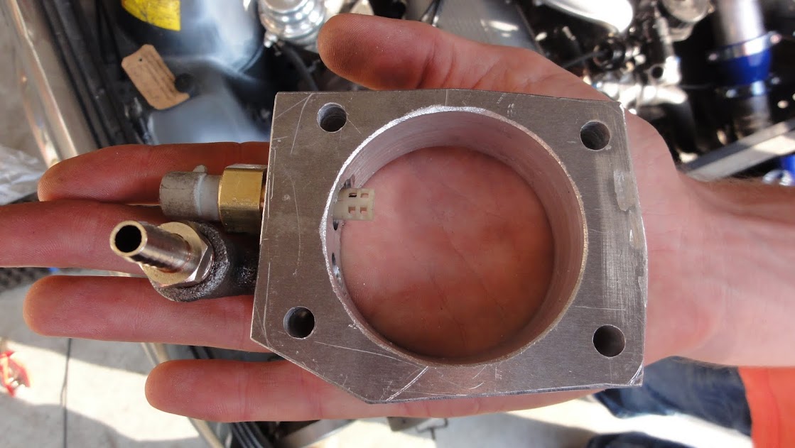

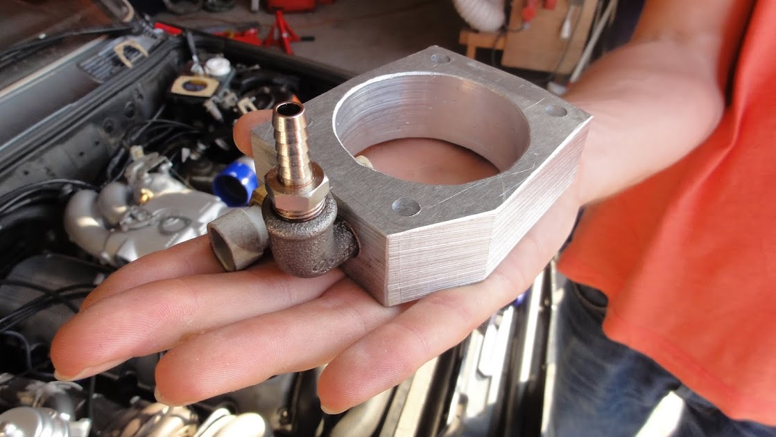

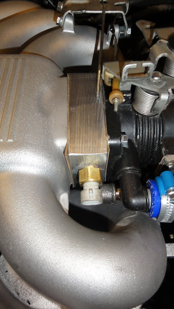

Made a flange for the MAT sensor. My simple mind says that if the engine is running idle, cold air is Always drawn past the sensor.
So when engine is stopped, heatsoak accurs. But my thoughts are that in this way, cold air flows over the sensor, even in idle.
also a connection for the BOV has been made.

huh. That's an inventive way to do the IAT sensor. Man I wish I could machine metal parts like that. I'd make so much money... to pay back the machinery and materials
Looks really good!
