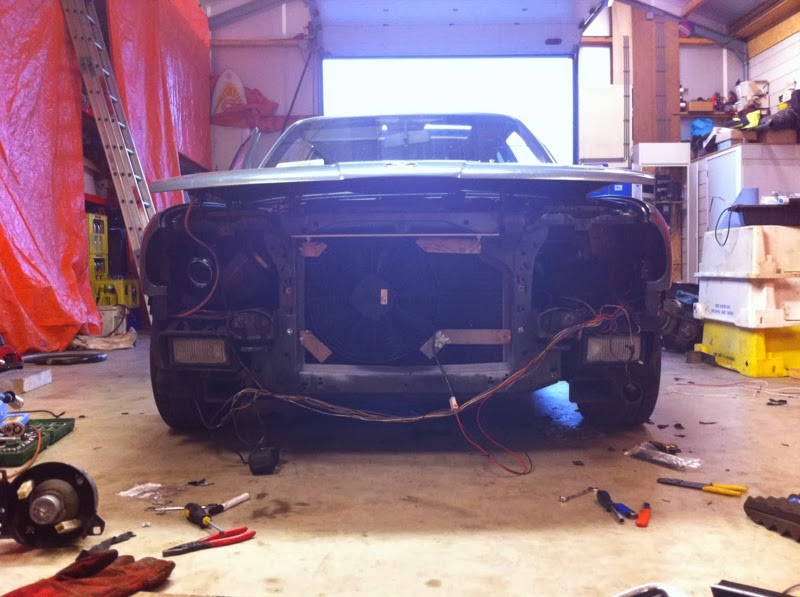

A new udate!
The downpipe is wrapped met exhaustwrap, this removes a lot of heat from the engine compartment!
Fitted an electric Spal fan. It being switched on by Megasquirt at 83 degrees celcius and off at 80
The Magnaflow 3 inch to 2x 2,5 inch muffler:
Fitted my 3,25S diff onder mijn auto. Still not what i want, its not laying rubber with hard normal accelartion. Only with revving and letting the clutch bang!
Odo at 000337 gezet, the km ive drivin with the car:
Project will go slow from now on, i bought an house wich will have priority! :D :D
