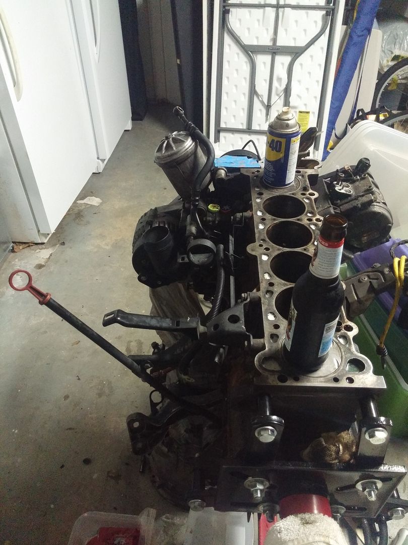

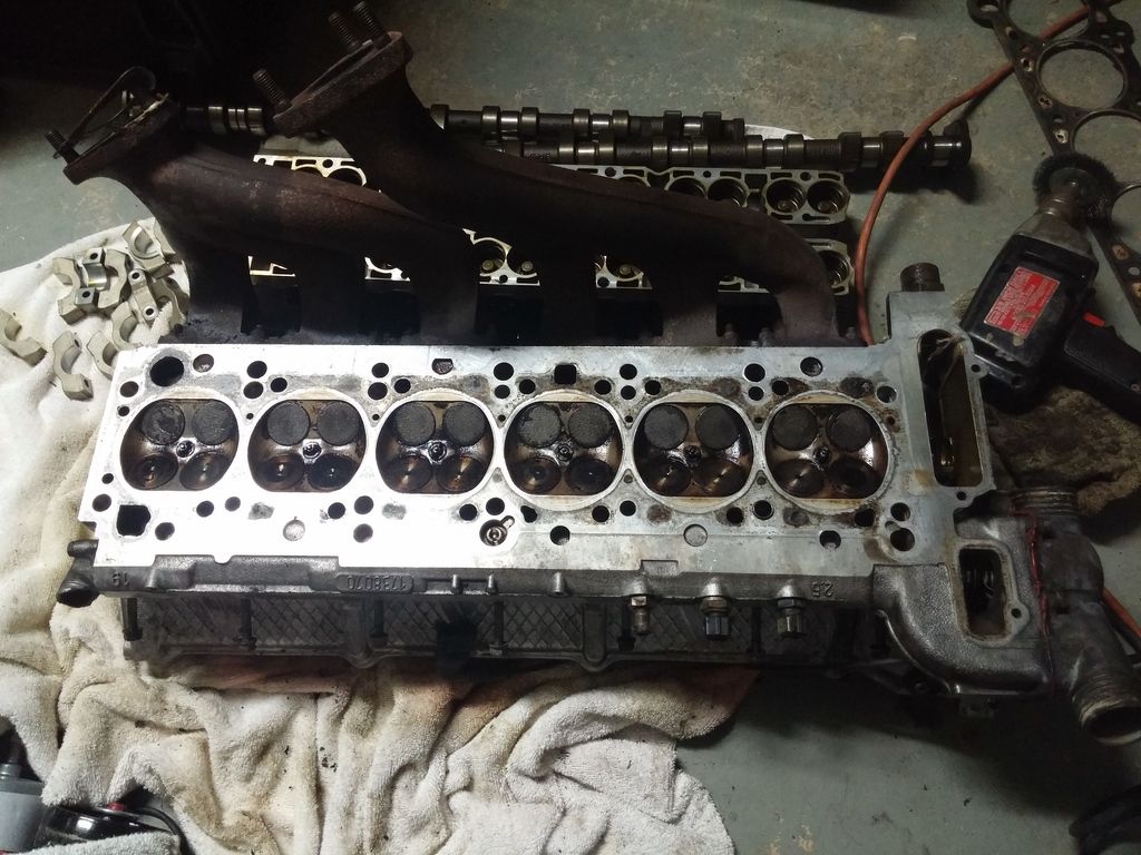

Postby blasphemy101 » Tue Jul 21, 2015 6:22 pm
Some pics as I begin the teardown. - I'm going to finish taking things off the block and maybe even take a look at the valves today.
A note about this picture: I found a bottle of Shocktop "Shockolate Wheat" in my fridge while I was working. Granted, I'm a girl when it comes to beer, but this has to be some of the worst crap I've ever put in my body. It might just be because it's been in there since the holiday season.
Against Yoshi's recommendation, I've decided to try to track down a set of m42 pistons. The M42 pistons are symmetrically dished, and the combustion chamber on the m42 has a similar shape to the M50, so I think it will be a good combination and an affordable way to lower compression.
I've found one post online suggesting E30 and E36 M42 pistons are different. At the very list, the diameter of the standard E30 M42 pistons is smaller and identical to the M50TU (83.980 mm). Supposedly the E36 M42 pistons have a shallower dish (~1 mm less) and shorter skirts. I'm not sure which I am going to go with yet. I am getting a set of 4 of each. I will measure them and then decide from there which I will use.
My initial thoughts are that the E30 pistons are more true to the original M50TU pistons, with the same diameter and similar skirt length, but the shallower depth of the E36 pistons will help keep compression up to reasonable levels (~8:1), and the extra skirt length of the E30 pistons might be unnecessary; the M50TU already has a better rod/stroke ratio than the M42. The extra diameter will also help fill out some of the piston-cylinder wall gap created by wear and a light hone.

Re: Blasphemy101's Turbo 24v Build Thread
Postby blasphemy101 » Tue Jul 21, 2015 9:12 pm
Almost everything is off the block now. I think I will have to drain the fluids to take off the rest, so I'm taking a break for a little while. Sorry for the terrible pictures. There isn't a lot of space where I'm working.
Postby Yoshi » Tue Jul 21, 2015 11:50 pm
aaah the cylinders don't look that bad. run the som bish.
