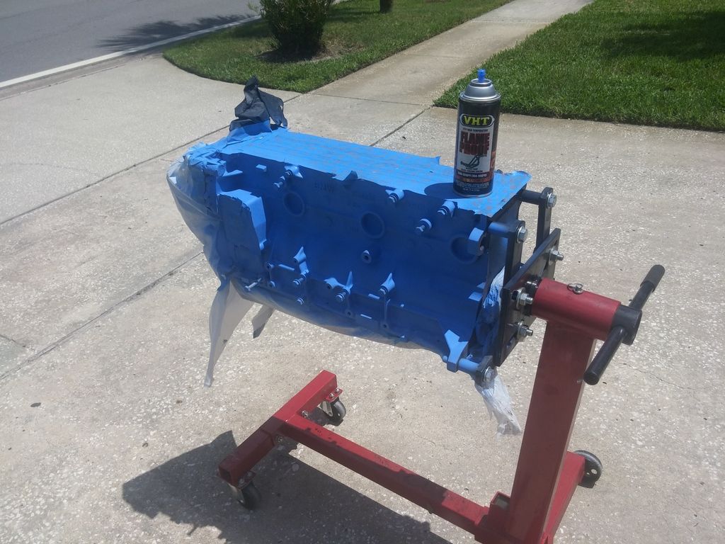

So I've ordered some parts... In the meantime, my block turned blue!

It just magically turned blue, huh? Had nothing to do with that can of spray paint sitting on top of it? lol

Things no one will ever see! lol

Yeah... I got a little aggressive with my cleaning and took a good portion of the original paint off. It started to flash rust like crazy, so this was my solution. I love the color, but the paint job is terrible, so it might not stay. But like Yoshi said, stuff no one will ever see, especially on a 24v.

The heat of the motor will keep it from rusting too much :)
