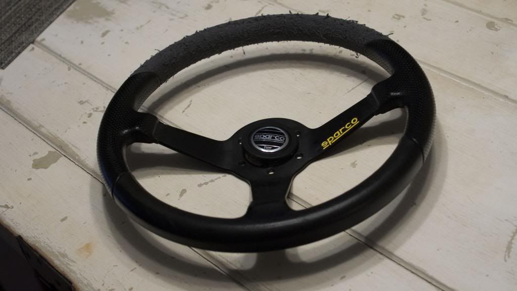

On a better note, I just bought this:
Needs a little love but its a huge improvement over the ugly ass airbag wheel. 350mm with a 70mm dish.

Postby Yoshi » Thu Mar 20, 2014 4:14 pm
def a little worn. how you gonna fix that?
Re: stripping her down for some lovin'
Postby M20_fever » Thu Mar 20, 2014 4:55 pm
I dunno, hockey tape? lol. it was $38 shipped.
Postby Ryki » Fri Mar 21, 2014 10:39 pm
Cut out that portion and sew in some leather?
Postby M20_fever » Sun Mar 23, 2014 3:59 am
I think that would be far beyond my sewing skill level, lol.
Postby Ryki » Sun Mar 23, 2014 4:07 pm
It's not hard at all really! You can do most of the prep work before and the actual sewing on the wheel is just about keeping it tight :D
Postby Yoshi » Sun Mar 23, 2014 4:19 pm
I thought sewing was woman's work?
Postby M20_fever » Mon Mar 24, 2014 2:43 am
Are you volunteering Yoshi?
Postby Yoshi » Mon Mar 24, 2014 11:14 am
Sadly, I'm probably good enough that I could do this. I'm pretty decent at sewing.

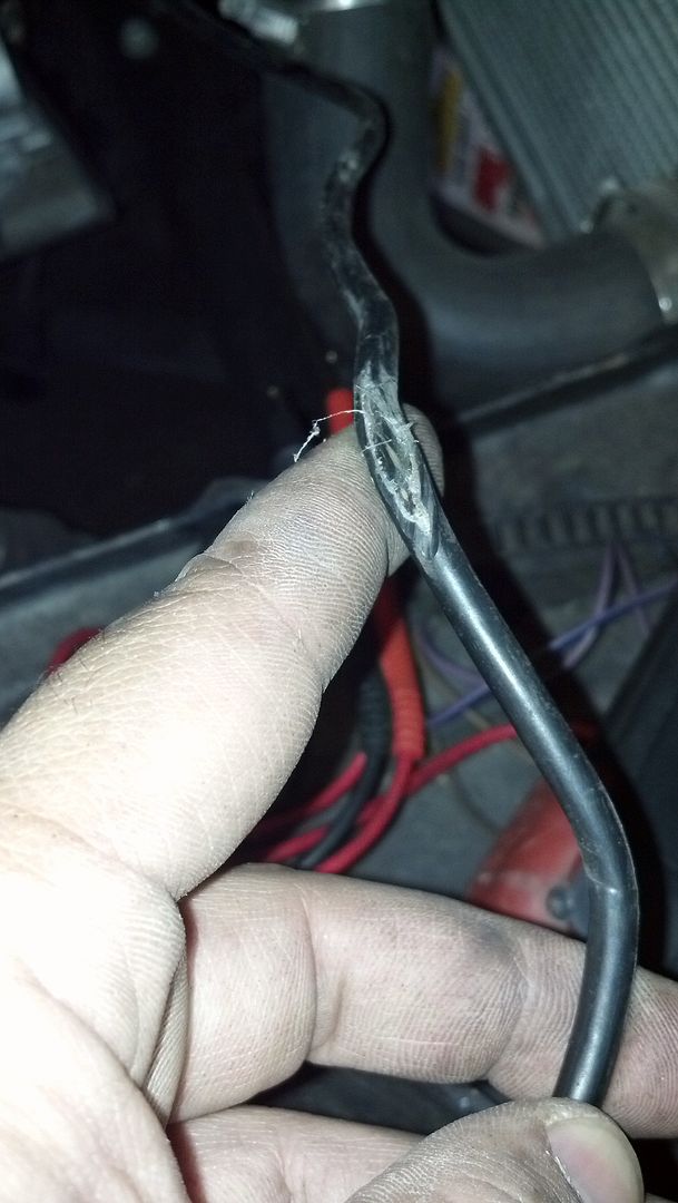

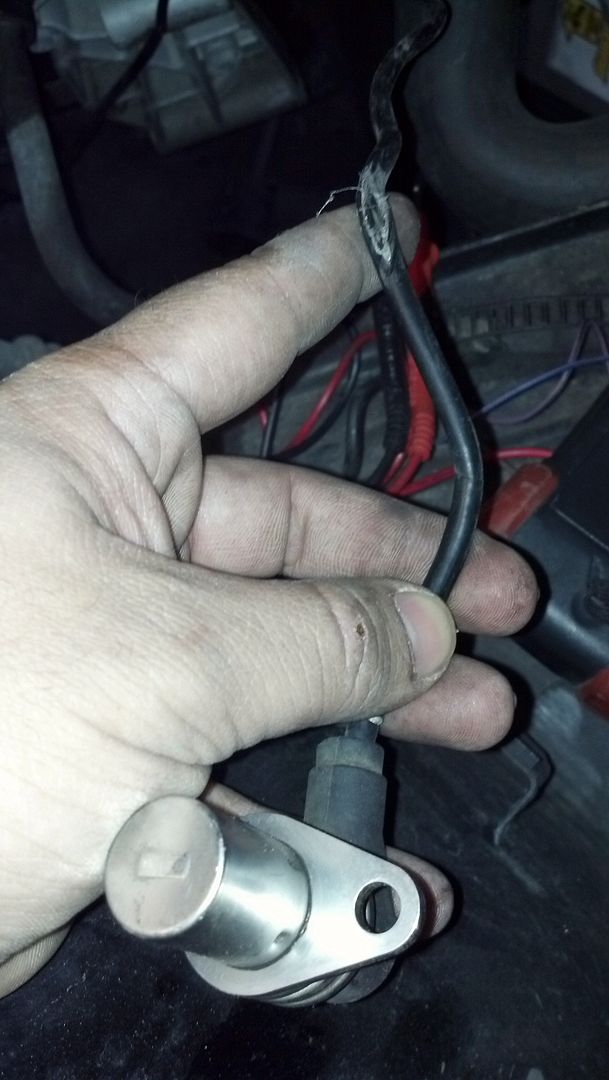

I think I may have found my problem...
it actually Ohm'd out good, but when I moved the wire around the reading would go wacky. Either way it needs to be replaced so we'll see if it solves my problem.

Postby Ryki » Sat Mar 29, 2014 8:02 pm
Nice, mine actually cut through! They're so easy to replace to : )

The nice thing about a stripped down race engine is that it really is easy to swap it out. I'm ordering the new one tonight so hopefully we get some more rain over the next week so I can test drive it next weekend.

Postby Yoshi » Sun Mar 30, 2014 1:09 am
And people wonder why I zip tie those things down :) Fan eats yo shit!
Postby M20_fever » Sun Mar 30, 2014 4:30 am
No fan homie. I think it was rubbing on the crank pulley.
