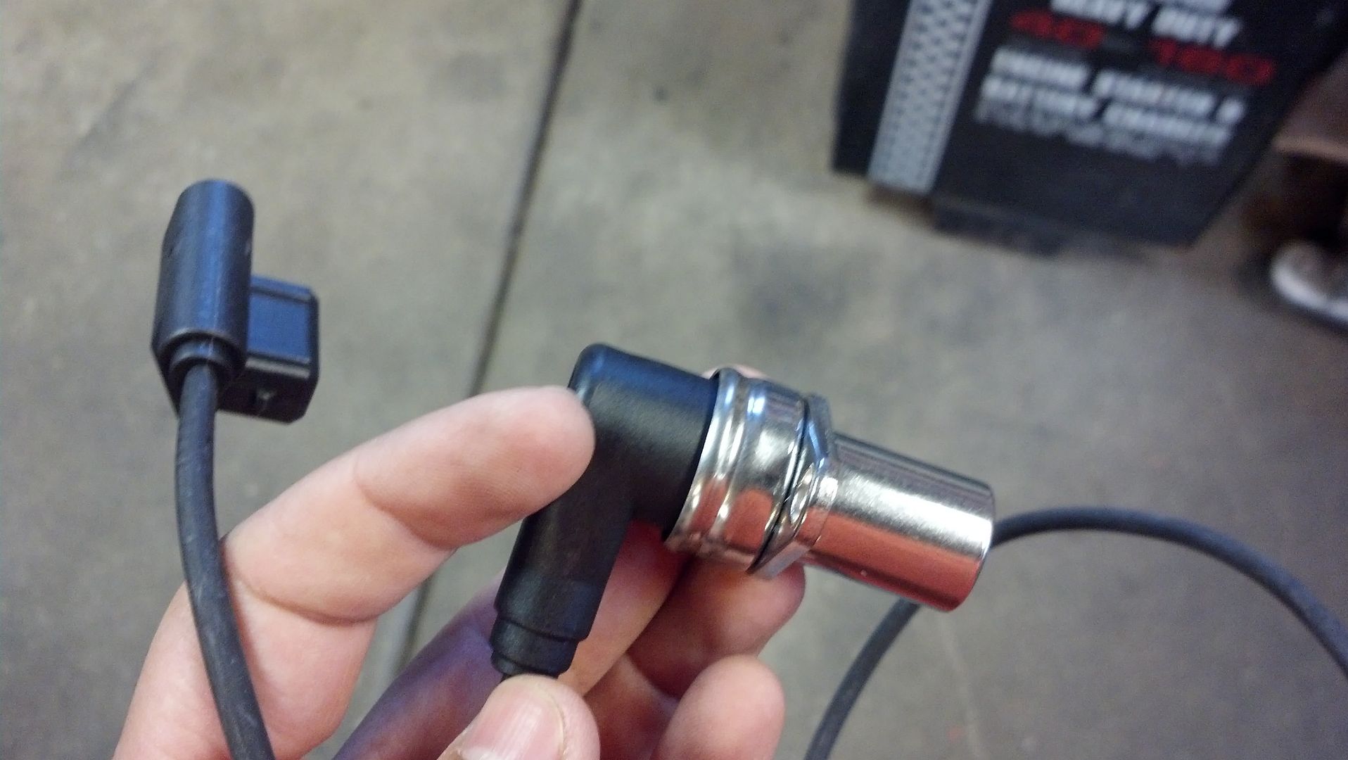

Got my new CPS installed.

oh hi!
will be paired to this guy once the refurb is done on it.
