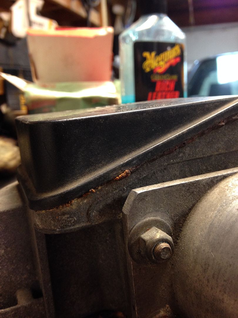

side note: at some point a PO opened my AFM and did something to it. There is rigid gasket make sealing the black cap on. Never even noticed until I compared it to the untouched one in my Dad's car.

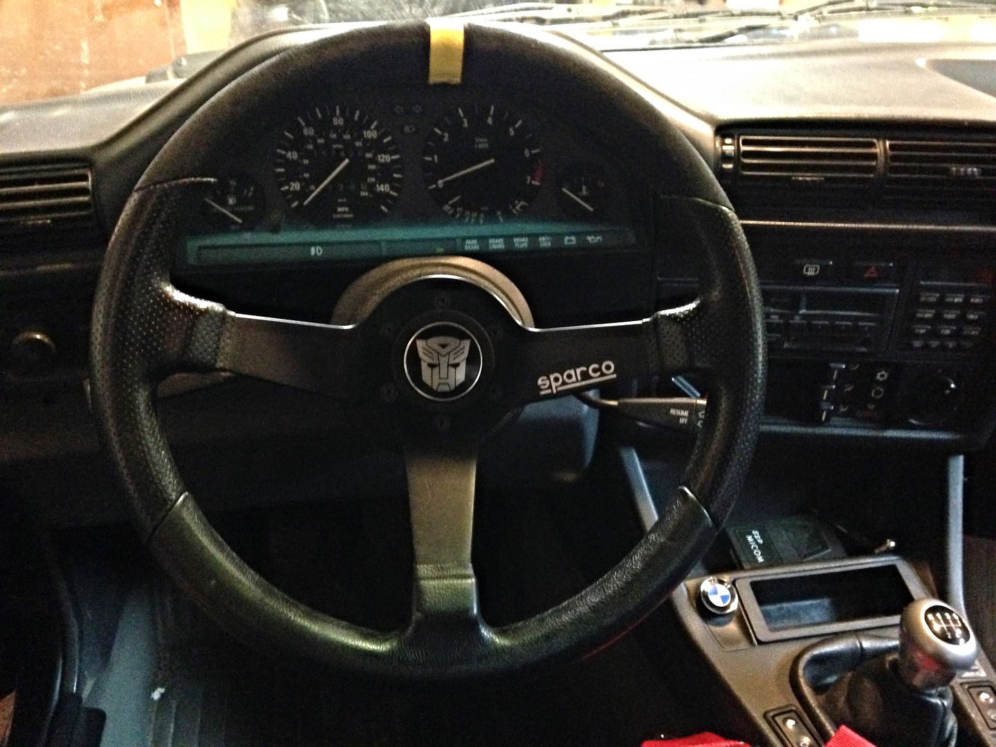

well, didn't get a chance to crack the AFM open tonight, tomorrow maybe. I did get a few minutes to install the hub and wheel, and I'm damn happy! It feels great, and the smaller diameter is really nice.
Don't mind how filthy the interior is, haven't had a chance to do any spring cleaning.
Re: stripping her down for some lovin'
Postby Ryki » Tue Apr 08, 2014 5:54 am
I like it. Don't know how it will hold up with just glue but it looks good :D
Postby Yoshi » Tue Apr 08, 2014 11:17 am
If Tony did his stitching right, the glue is really just there for extra security.
Postby M20_fever » Tue Apr 08, 2014 1:08 pm
No stitches lol. To my defense, the leather I took off was only glued on too and it was still difficult to get off. I think it will hold up just fine.

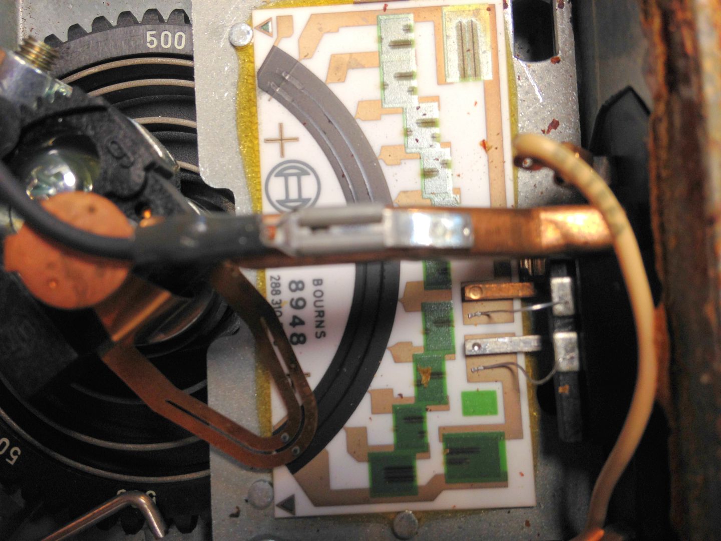

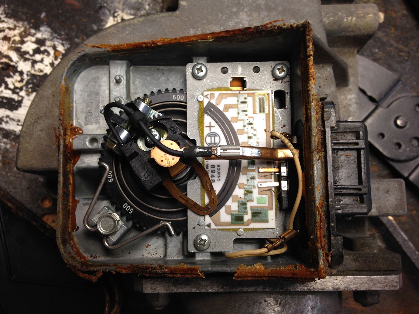

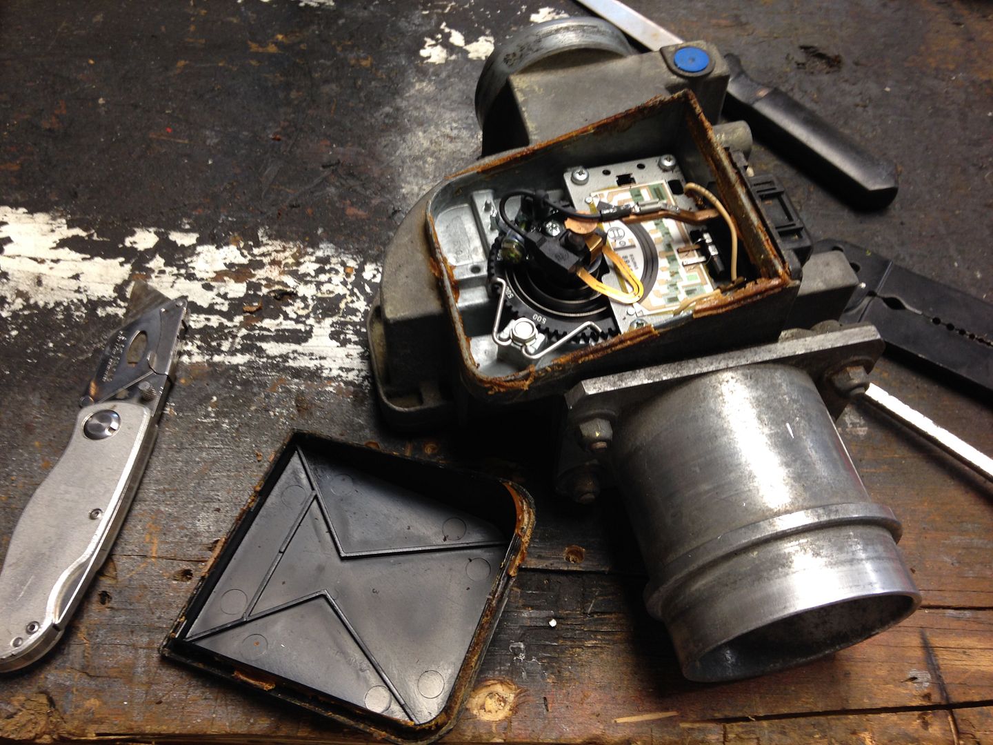

Postby M20_fever » Wed Apr 09, 2014 2:21 am
popped open the AFM tonight. Just like the video showed the resistor contact strip was totally worn where the armature touched it. I bent the arm to contact a fresh strip and took some readings. The dead spot is gone, and it climbs in resistance right up to WOT, at which point it drops just a tad (4.01 down to 3.8-3.9) so I'm not sure if that is going to cause an issue. I closed it back up and will test it tomorrow.
You can see where it was opened before.
Where it was worn.
You can see how I bent it to contact a new area of the contact strip.
I'll report back tomorrow night on whether it worked or not.
