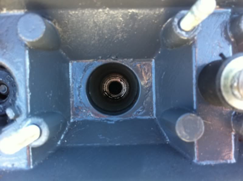

Alright to pick up from the last update I had oil and ATF soaking inside with the pistons to clear up some surface rust on the cylinder walls. With that being a success, I hooked up the battery and let the engine pump it out through the spark plug holes.
This process = ATF and oil all over you nice clean engine bay.
However, there's another outlet for the fluids to go I completely forgot about. Luckily I had some cardboard....

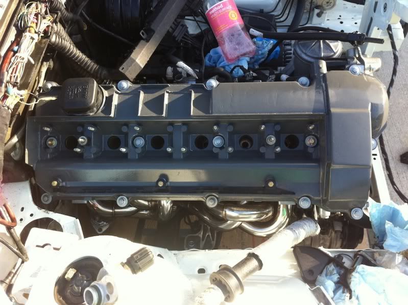

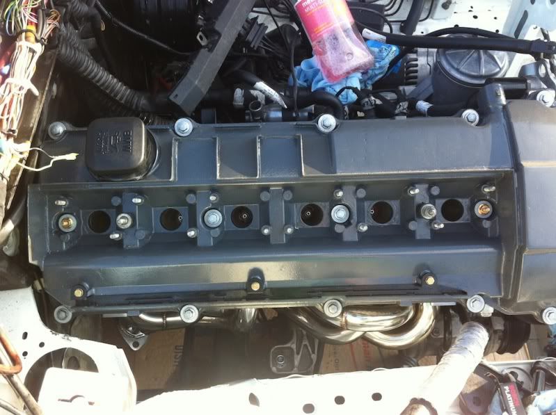

With that done I moved onto the new spark plugs. Cleaned up the holes first tho.
I know they aren't NKGs, but they are cheap and are only going to be in there for 100 miles or so till all possible crap is cleared from the engine.
I reinstalled the coils afterwards. Note the studs for the grounding strap for the coils. The S50 calls for two studs, but only one ground strap. I have zero clue why.

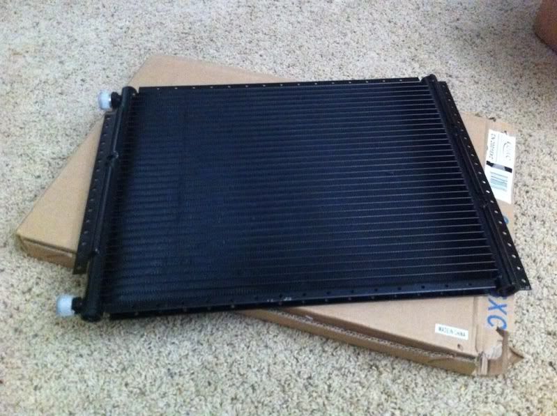

Why a new parallel AC condenser. :) I will be doing a write up for 24v AC systems once everything is said and done.

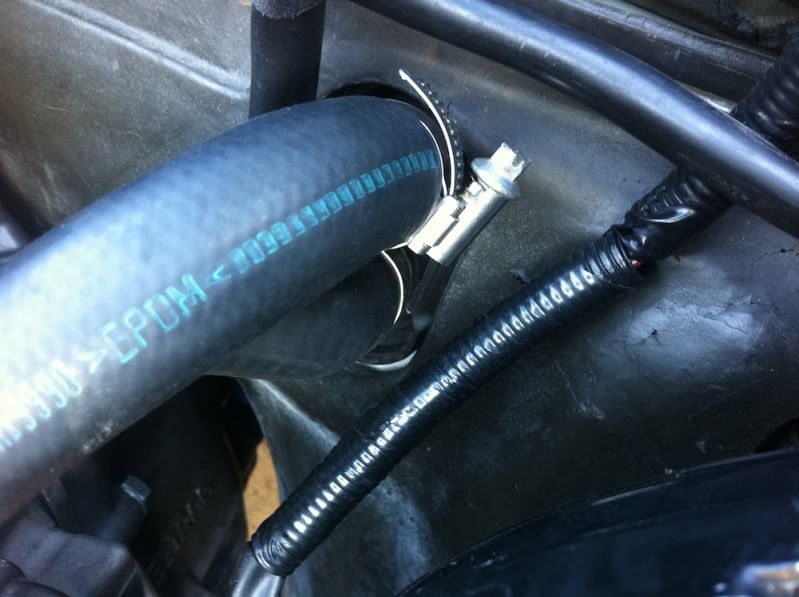

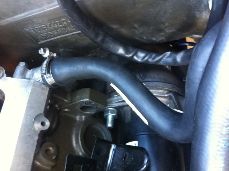

Hooked up the coolant hoses to the heater core. The spider hose goes on TOP and the hose coming from the head goes on the BOTTOM.

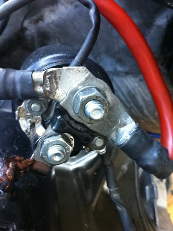

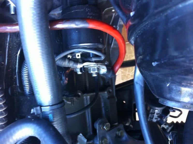

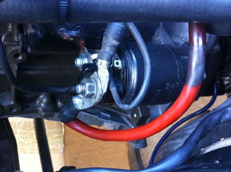

Pics of my starter's E36 leads. The two small gauge wire have different size openings on the eyes so you can't screw that up. The large terminal is shared with the wire leading from the alternator (black wire) and the wire hooked up to the battery terminal (red wire).

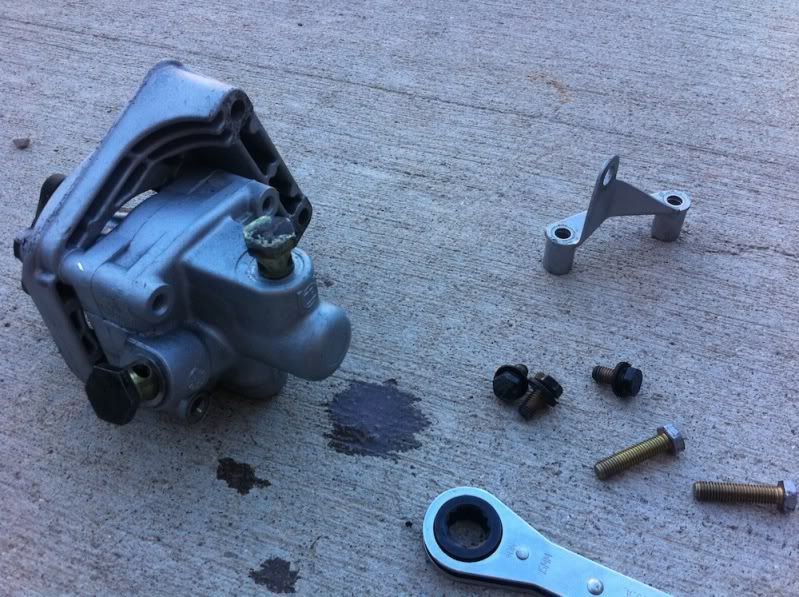

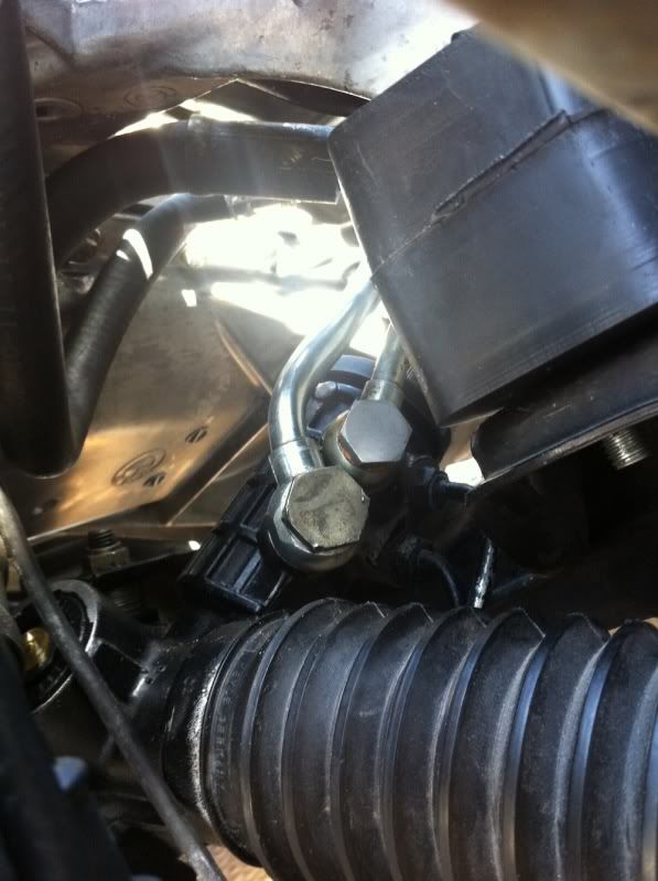

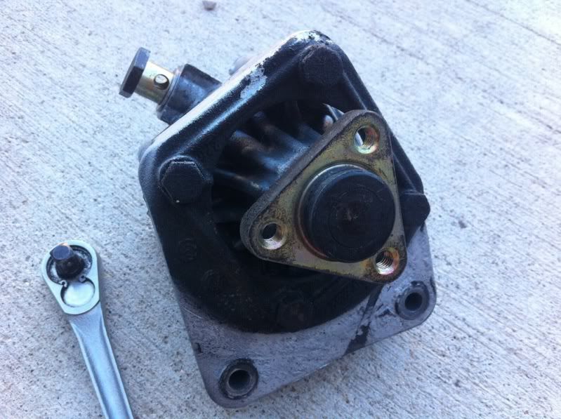

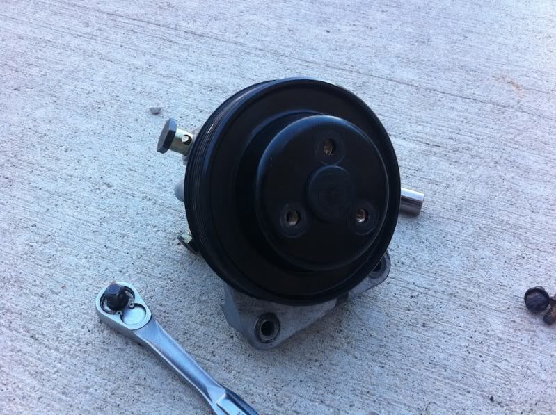

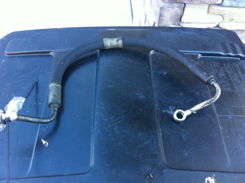

Next up was the old foe, power steering. On my other E30 I had nothing but problems with it. I intended to fix that with this one. I grabbed the main high pressure hose from the other E30 since it's relatively new and cleaned it up a little. Didn't really do any good.
At this point, I still don't have a pump for this engine, so I stole the one off of my M50.
I had previously painted it after giving it a good cleaning. Paint and grime do not mix, so it looked like shit. Since I didn't want it looking like that in my bay, I decided to soda blast it.

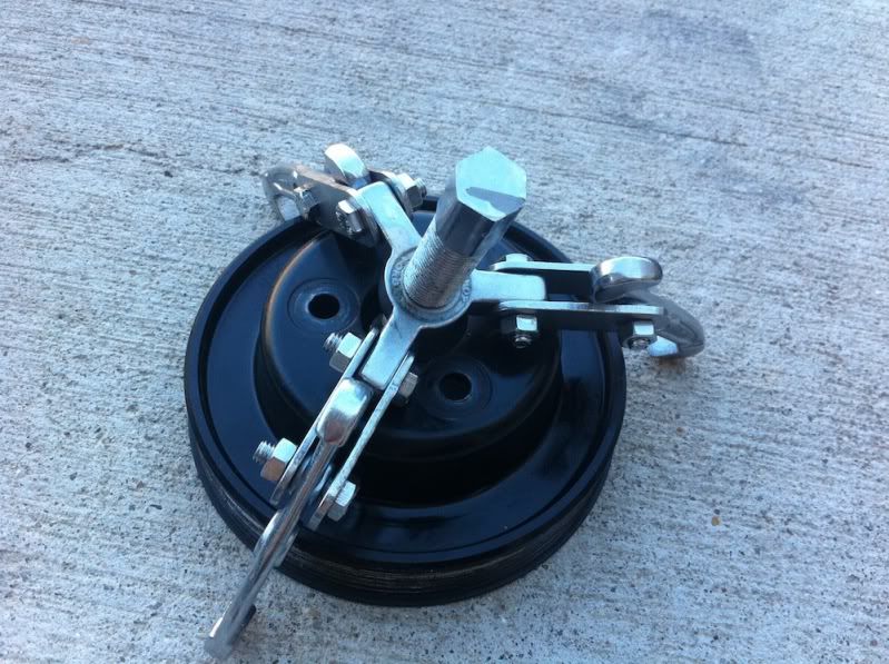

To do this I need to remove the pulley with a gear puller, remove hardware, and seal everything off.
Anyway still not much better, but at least it is clean.

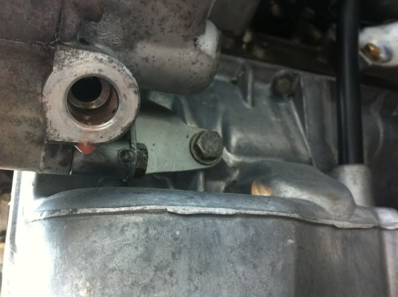

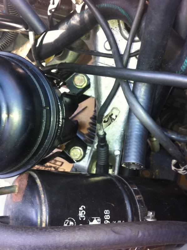

See the bracket that goes to the oil pan, take note E36 pump users, you do not have this. You need it
I had also installed the E34 oil sending unit a while back.

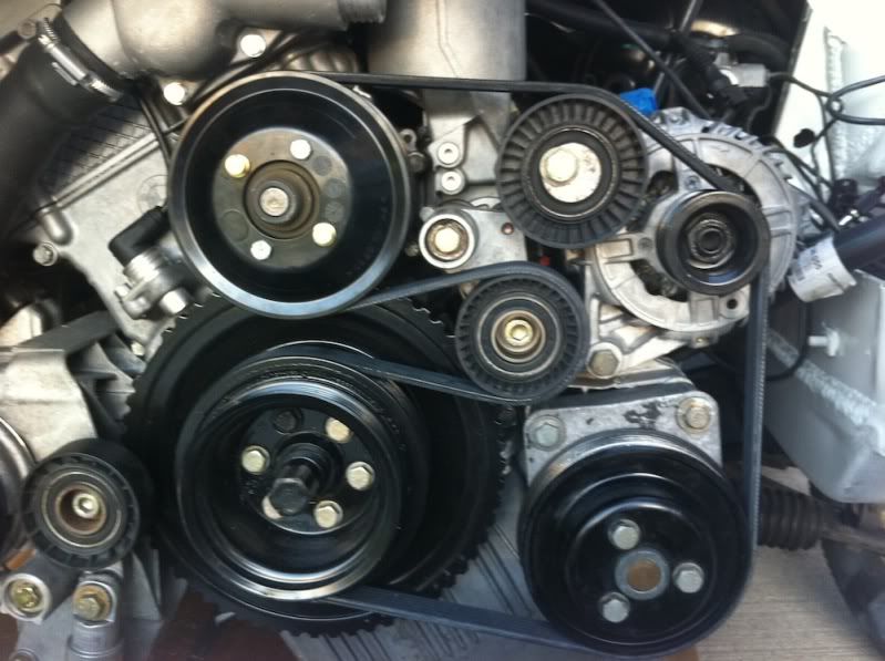

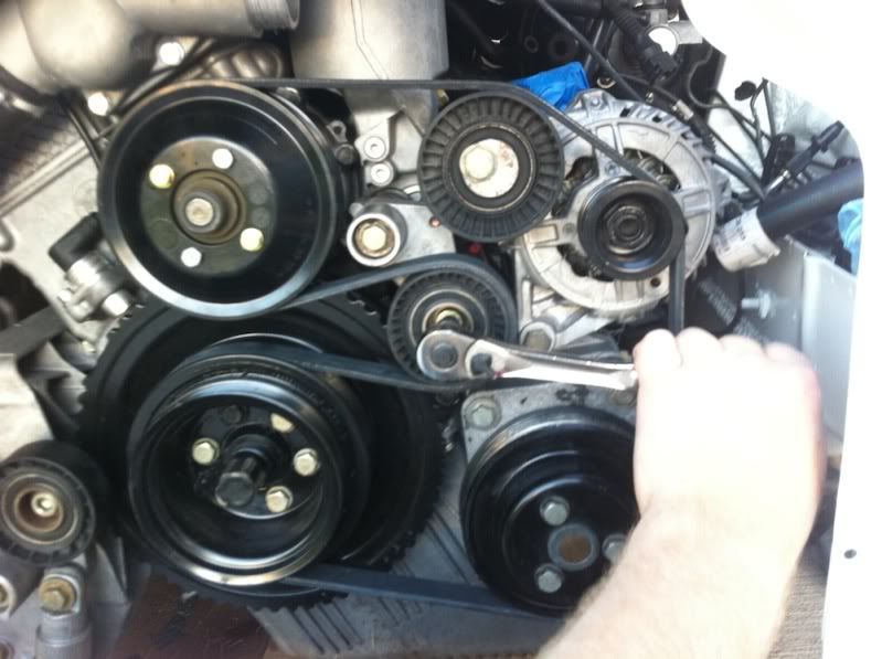

To put on the belts, take your ratchet and turn clockwise on the tensioner to relieve tension.
Everything just slips on after that.

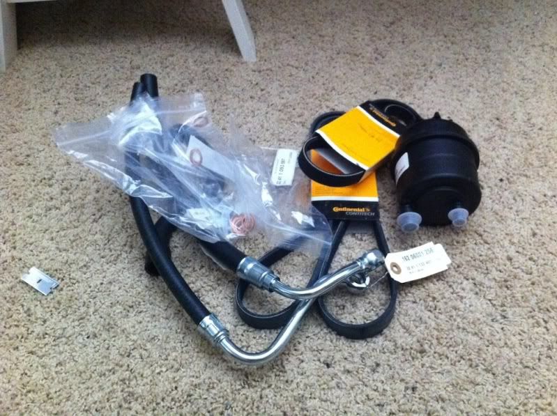

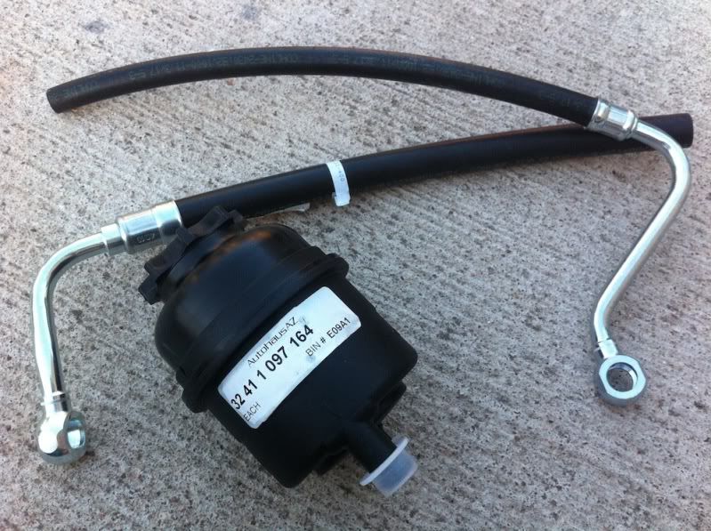

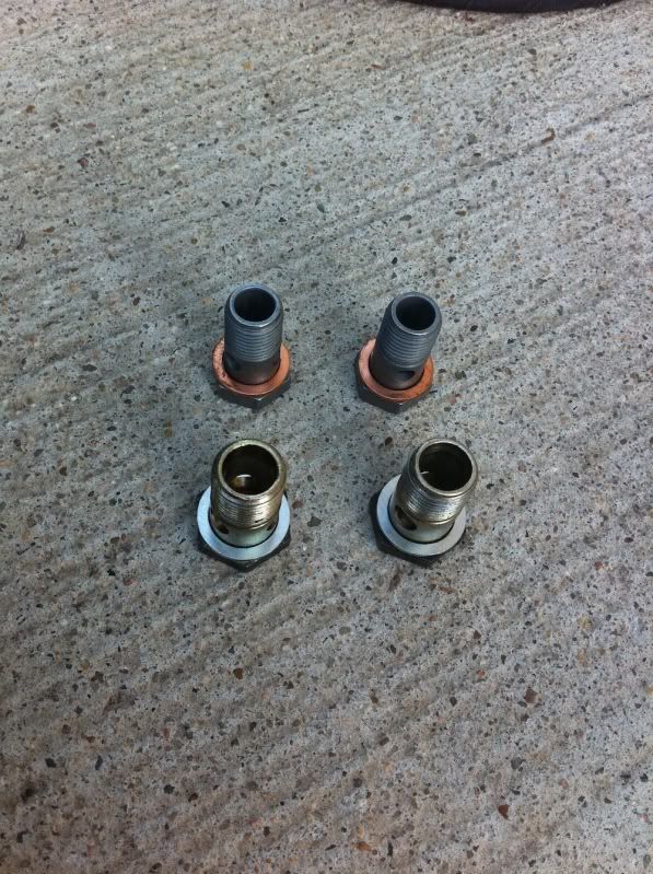

New power steering stuffs. Do not buy this stuff from BMW. They recently updated their catalogue and up'ed the prices on a few things. PS lines and the res being one. The res use to be $18, it is now $60! That main hose I reused, that was $70, now $108 at the cheapest online.
The new hardware
Tools required: 19mm socket, 19mm ratcheting wrench (makes things easier), and a 22mm socket.
By the time I was working on this part it was dark and I had changed plans. Pics were also not coming out, so sorry in advance.

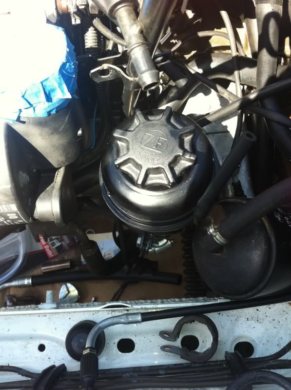

I was originally going to mount the res in the stock location. This wasn't going to happen because of the booster. I had already asked Sam about the E36 location and he said it works in an E30. So that's what I did. I used the E36 hose coming off of the pump to the res (this was replaced it looks like shortly before the M3 was wrecked), E30 high pressure hose, and E30 rack to res line with some bending to prevent a kink.
Anyway everything mounted up and filled. See the leak below?
Easy fix, but I was quite irritated by that point. Just tightened down some more. Both crush washers are present as it's suppose to be. Called it a night after that.
No leaks in the morning thank god.

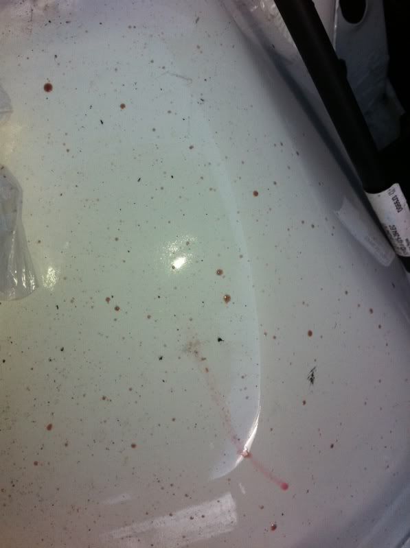

While I was under there I spotted this. Luckily it was just a small pool that had formed on top of the oil pan where some oil had run down when I squirting some into the valves.

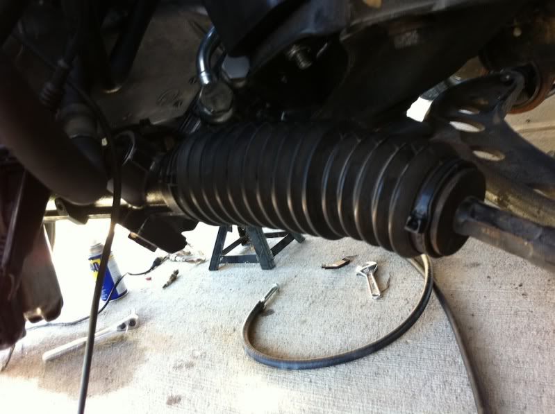

Threw some zip ties on the boots for the E36 rack.

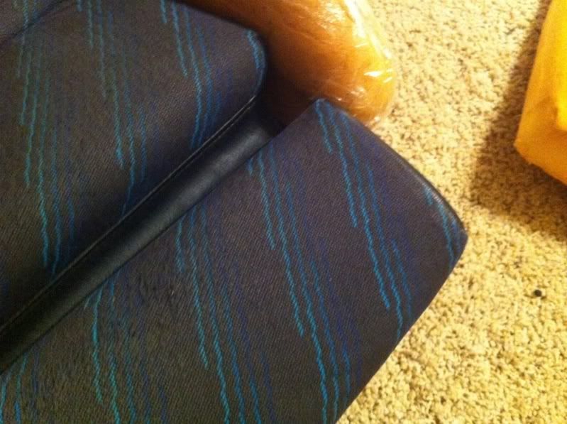

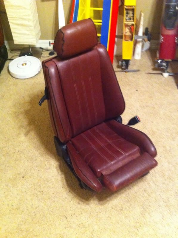

At night I've been messing around with the interior a bit. I tore down a seat to wrap my head around how it goes together and to get it ready for the new material.
The new material is a factory M-Tech Blue cloth set out of a cabrio. For being 20 odd years old, it's in very good shape, but it's missing headrest so I'm in talks with Kevin at Creative Options about getting new headrest and bolsters made. Since his father died a few weeks ago, he's been on leave so that's on hold for a while till he comes back. Sorry for your loss Kevin. :(
There you have it.
Re: This is Sofie- S50 being refreshed
Postby Yoshi » Wed Jun 22, 2011 12:18 pm
Can I have some money?
Also, side note:
The part of the belt that goes from the alternator to the water pump should go UNDER that tensioner, not over. Otherwise, the groove in the belt will wear out.
glucklich21
Posts: 157
Joined: Mon Dec 13, 2010 10:21 am
Location: Fulshear, TX
Postby glucklich21 » Fri Jul 01, 2011 9:09 am
Hmm thought I already replied to Yoshi.
Any way, when I put on the belts I thought that seemed odd. They've been off since. I'll remember that when I put them back on for the cooling system.

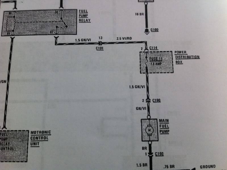

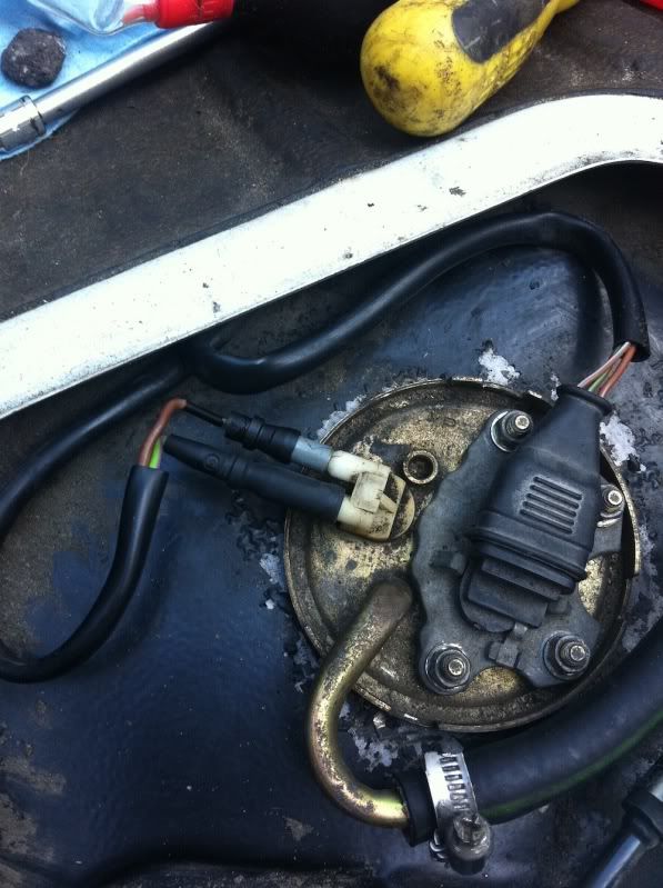

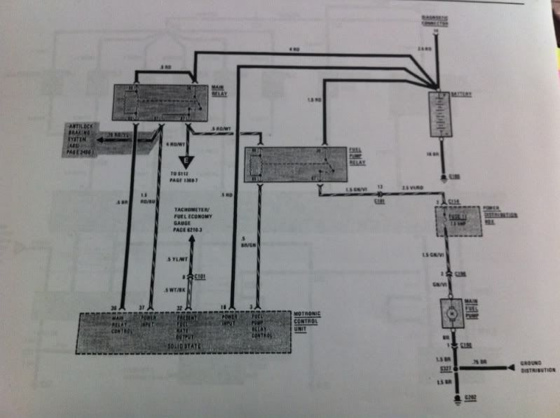

My fuel supply issues have been giving me fits. I decided to settle it once and for all. I took another look at the ETM.
Power routing:
Whole power supply for the pump:
The part I eventually focused on
I tested everything to check for power. Relays, fuses, fuel pump connector, and DME pins passed. I was thinking at this point that it was just a bad pump. However after I was playing with the connector and turned on the ignition to test some wiring I heard the pump prime. After taking a closer look, the pigtails inside of the connector were not only loose on the pin, they were crumbling, causing the fuel pump to work randomly.
So I went by the dealer yesterday and placed a rushed order for new pigtails. Should be in by Friday afternoon.
Now that this and the blinkers not working is solved, I can wrap up the harness and focus back on the engine bay. Also my big order to finish up the front and the shifter will be in tomorrow.
